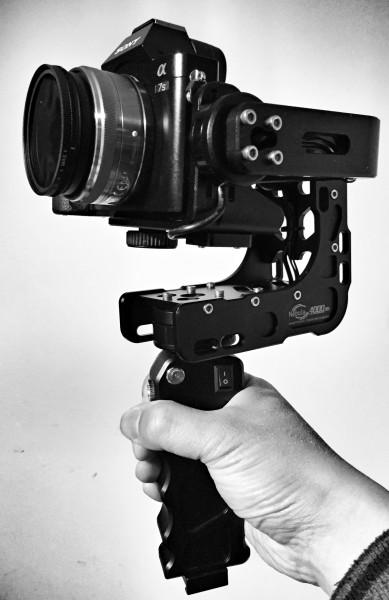

maxotics Posted March 12, 2015 Share Posted March 12, 2015 On the Nebula 4000, there are two ways you can balance the "roll" of a camera. The first, is to mount it in any plate slot, looses the screws attaching the roll arm to the motor, and move the roll arm until it balances. The second way is mount the camera on a plate mount either closer, or farther, from where the roll arm attaches to the pitch motor. The problem with the GH4, A7, and any larger camera, is that you can't get it balanced, for roll, unless it's in a plate slot that puts it right up against the pitch motor adjustment screw; that is, the roll arm doesn't move to the right far enough that you can mount the camera on the right side of the plate where you can get the wrench into the pitch motor screws. Dave Dugdales's videos show him wrestling with this problem. The bottom line is that with a smaller camera you can easily adjust the pitch bar position because you can mount the camera away from it. With the GH4, you'd need to figure out the pitch balance BEFORE You mount the camera. That makes balancing the camera very difficult. In order to get a good balance, you need the camera mounted on the gimbal where you can move each part around and test.The second problem is that if you put any sort of long, or heavy lens on the GH4, you start to stress the Nebula out. The motors aren't designed for heavy cameras. So you'd have to have it balanced perfectly. I don't want to dissuade anyone for using a Nebula with the GH4. I just want to point out that it's much easier with a smaller camera. The sweet spot cameras are probably the A6000, LX100, EOS-M, GX7, etc--and not with heavy glass. leeys 1 Link to comment Share on other sites More sharing options...
leeys Posted March 12, 2015 Share Posted March 12, 2015 It sounds like it barely can do 1kg then? I was thinking of getting something like this for my GH3 and 12-35. Link to comment Share on other sites More sharing options...
maxotics Posted March 12, 2015 Share Posted March 12, 2015 Here's a photo of the Nebula 4000's pitch motor compared to motors you typically find on DSLR stabilizers. The gimbal in the picture is one a friend had, which broke, he could never get it working again, so I'm trying to fix it. Not easy! This photo gives you an idea how little the motors are on small gimbals and why they work best with small cameras. leeys 1 Link to comment Share on other sites More sharing options...

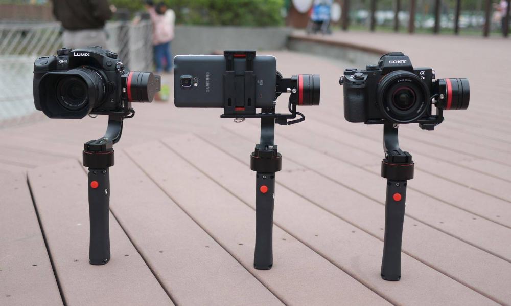

Cinegain Posted March 19, 2015 Share Posted March 19, 2015 Pretty straight forward and quick. I was thinking on holding off for a little longer, but this one manages to spike my interest. More so than the Nebula at least. There's also -10% on pre-orders on http://copter-rc.com/en/catalog/60-pilotfly-h1-microdslr-3asix-stabilizer-pre-order.html jfyi. For us Europeans... they might be opening an overseas branch office (actually, they say they are on Facebook), which means we might get to order one locally sometime 'soon'... JazzBox 1 Link to comment Share on other sites More sharing options...
ntblowz Posted March 20, 2015 Share Posted March 20, 2015 Btw the Pilotfly is using 8bit for their handheld gimbal, they mention 32bit is for another model. andrgl 1 Link to comment Share on other sites More sharing options...
MartyB Posted April 16, 2015 Share Posted April 16, 2015 @Cinegain you bought the pilotfly H1 yet? seems good and I'm keen to get one, the Ronin M looks good and could have a nice price but this is a more compact creature. Ken Asanos been building a pistol grip one he calls the S Monster for 5D etc. and has better motors http://kenasano.net/ can't understand everything but his prototype video looks impressive if a bit unwieldly. Cinegain and andrgl 2 Link to comment Share on other sites More sharing options...
andrgl Posted April 16, 2015 Share Posted April 16, 2015 @Cinegain you bought the pilotfly H1 yet? seems good and I'm keen to get one8-bit sucks. Hold off if you can upgrade the board yourself. Link to comment Share on other sites More sharing options...
Cinegain Posted April 16, 2015 Share Posted April 16, 2015 @Cinegain you bought the pilotfly H1 yet? seems good and I'm keen to get one, the Ronin M looks good and could have a nice price but this is a more compact creature. Ken Asanos been building a pistol grip one he calls the S Monster for 5D etc. and has better motors http://kenasano.net/ can't understand everything but his prototype video looks impressive if a bit unwieldly.Ooh, that looks interesting as well. To get back to that Pilotfly H1 deal, nope, with them setting up shop in Bayern, Germany and NAB coming up and indeed, it being a 8-bit controller on there, when they might do a 32-bit version... I felt like holding off a bit longer was the best thing to do. I guess I can even wait for Photokina when hopefully the GX7 successor will be announced. If that's the case I might not even get one altogether. With a lot of full manual glass in my possesion a great part of getting a stabilizer is just to be able to shoot handheld with unstabilized lenses (was on the verge of trading in my E-M1 for the E-M5II, but unfortunately the E-M5II didn't live up to my expectations). For sweet camera movements and use with e.g. the new Micro Cinema Camera however a gimbal stabilizer is pretty nice to have too. Now, I don't really mind the controller being 8-bit on the Pilotfly H1 now, I don't know how they put it to use, but it's one of the most effective things I've seen out there. So if a 8-bit wins from a 32-bit one, I'm not going to argue it should suck more. Anyways. There's tons of MOVI like stabilizers out there now. It's a matter of time for the people behind the Nebula 4000 and Pilotfly H1 to up their own game and others to try and catch the wind from their sails, so I'm sure that in a few months it's the best time to make a choice and the concept of pistol grip gimbals has matured a little more. Link to comment Share on other sites More sharing options...
