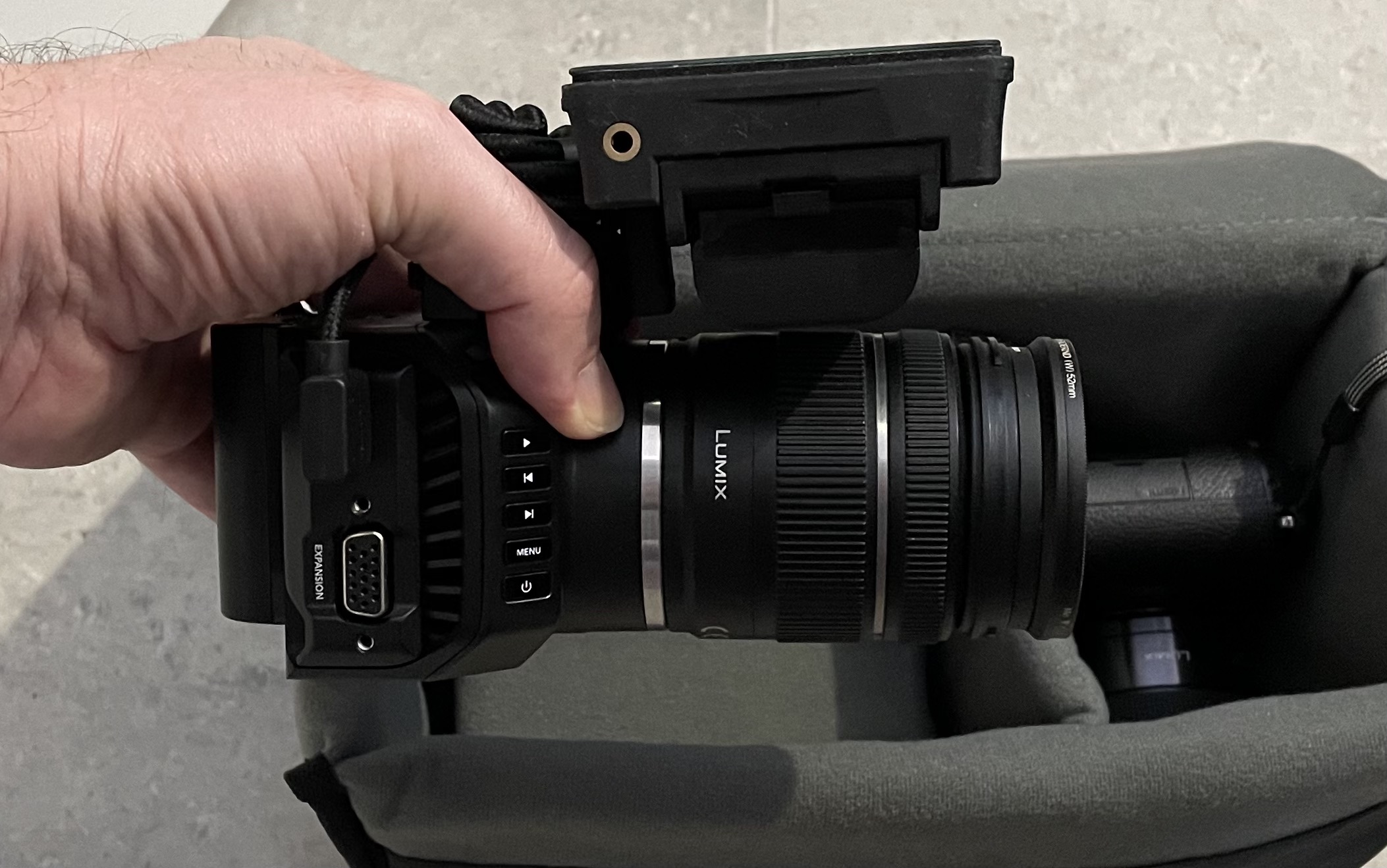

kye Posted April 6, 2023 Author Share Posted April 6, 2023 The last is the GH5. Firstly, it's noticeably larger than the GX85, so much so that it's not pocketable (despite what BM might claim) so it's less convenient to transport, and it's not "palm-able" either so you're walking around obviously holding a professionally-sized camera, regardless of what lens you use. I tried taking it out with the 14mm lens one day instead of the GX85 and I found it more cumbersome to carry, more conspicuous to passers-by, and even subtly more imposing on my family. When I accidentally found myself carrying it through anti-government protests (long story) I was thankful that the riot police weren't looking for anyone that looked like foreign media. I typically pair it with manual-focus lenses, and found this to be quite cumbersome compared to the AF of the 14mm lens, but with faster lenses you need to worry about what it will focus on, so it's a whole other ballgame which even the animal-eye-AF cameras get wrong because they don't know which cat you love the most. While the EVF is reasonable, but not great, the screen is cumbersome to use unless you're shooting from eye-level as you need to flip it out to be able to tilt it, not only making the camera a lot bigger (physically and perceptually to everyone) but also less manoeuvrable and more fragile if you get bumped etc. Obviously the image is the nicest out of all three cameras, but you really pay for it in size and weight. For Priority 1 and 2 it's definitely the last-resort, and I'd only pick it over the GX85 in very specific circumstances now. Adept 1 Link to comment Share on other sites More sharing options...

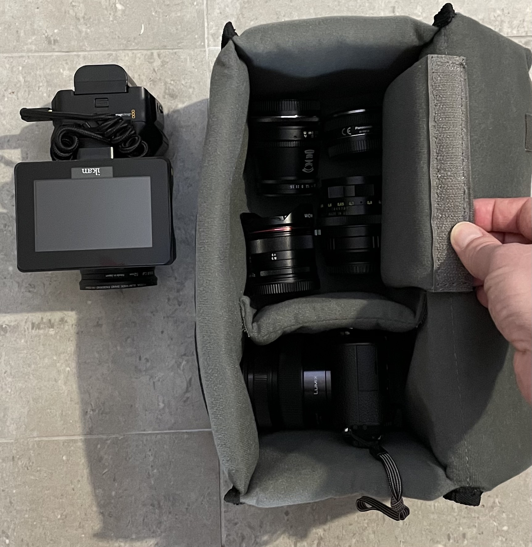

kye Posted April 6, 2023 Author Share Posted April 6, 2023 This leaves me with the best setup being either the iPhone by itself, or the iPhone + GX85 which means that the iPhone can do the wide and the GX85 can do the normal and tele FOVs. The 14mm is good when combined with the 2x digital zoom, but still lacks some flexibility. When I got home I put on the 12-35mm f2.8 zoom and while it's far more flexible, going a bit wider and hugely longer, the additional size puts it half-way to the size of the GH5 and severely hurts Priority 1 and 2. This left me with a choice: iPhone wide + GX85 + 14mm iPhone wide + GX85 + 12-32mm f3.5-5.6 iPhone wide + GX85 + 12-35mm f2.8 iPhone wide + GX85 + wide-zoom like 7-14mm or 8-18mm The question was if the iPhone wide camera was good enough in low-light. I reviewed my footage and basically it's good enough indoors in well-lit places like shops or public transit, good enough in well-lit exteriors like markets, but very very borderline in less-well-lit streets at night. For my purposes I'll live with it for the odd wide and will lean heavily on NR, which will give me the ability to have a longer lens on the GX85 which extends the effective range of the whole setup. I did a low-light test of the iPhone, GX85 and GH5 and found that the GH5 and GX85 have about the same low-light performance, iPhone normal camera is about GX85 at f2.8 and the iPhone wide is about GX85 at f8. Considering that iPhone-wide/f8 was very borderline, if I aim for something like f4 or better then the lens should be fast enough in most situations I find myself. I don't really find myself wanting shallower DOF than the 14mm f2.5, and could even have less without much downside. This means that the option of a zoom lens is not out of the question, and the 12-32mm pancake seems a very attractive option. It's larger than the 14mm when it's on and extended, but when it's off it's basically the same, and it would give a huge bump in functionality. I took a number of timelapses on the trip too, and having a zoom would make these much easier as well. I'm contemplating the 45-150mm as well, but we'll see. Adept 1 Link to comment Share on other sites More sharing options...

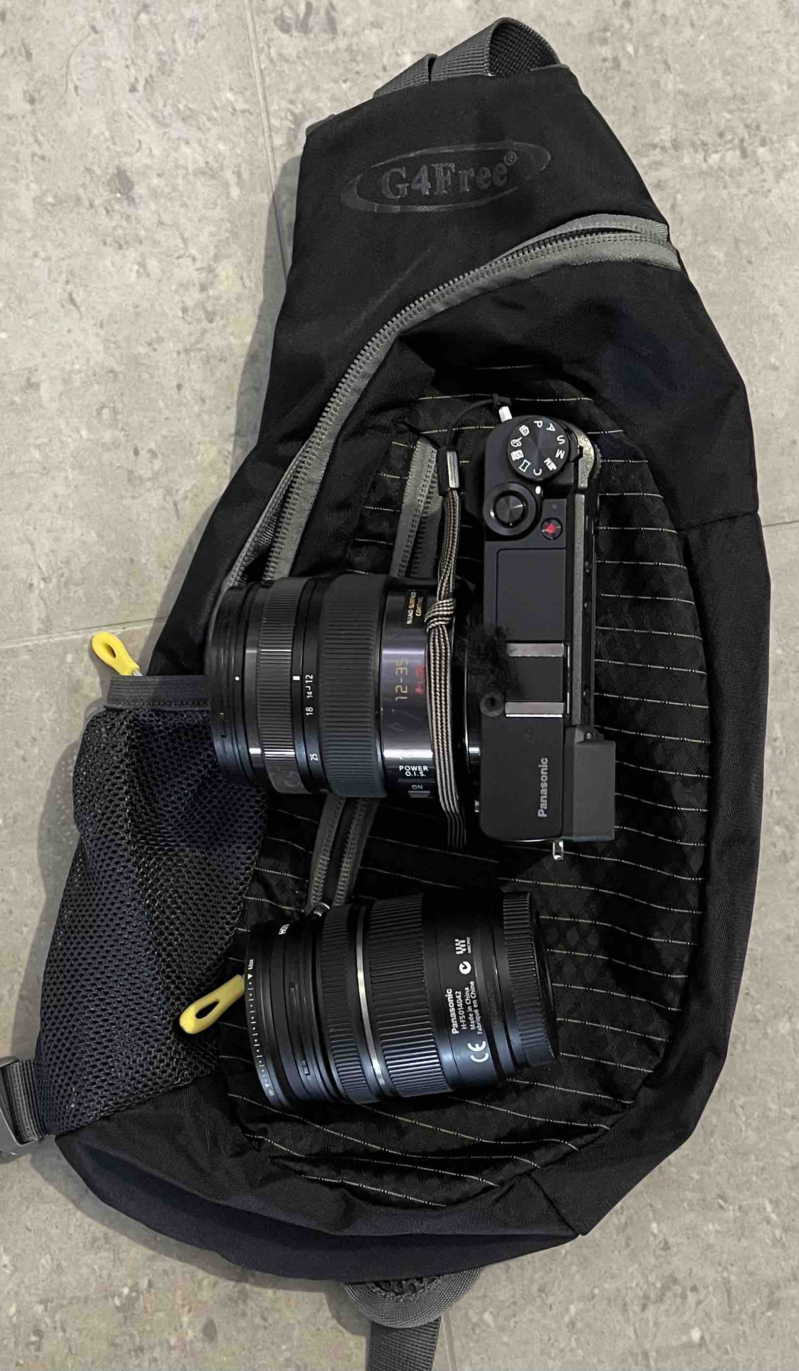

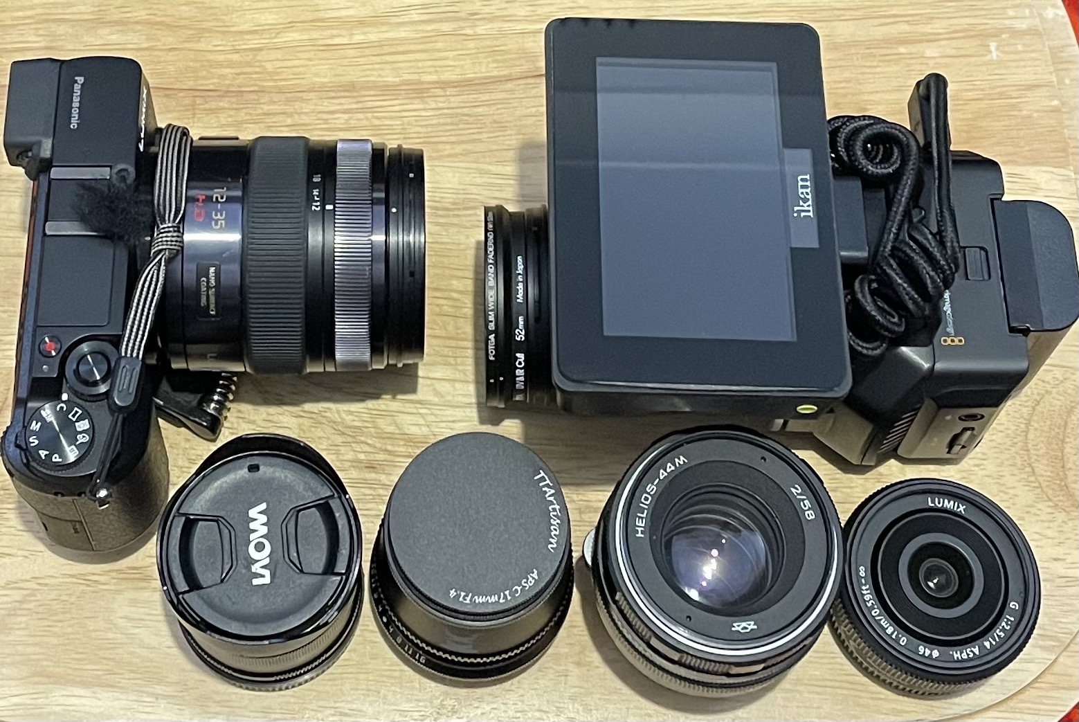

kye Posted March 31, 2024 Author Share Posted March 31, 2024 I wanted to expand on some things but didn't want to clog up the other threads, so am back to this thread. I previously said this: On 3/28/2024 at 8:04 PM, kye said: My current thinking is this: Full tourist mode is the GX85 and OG BM camera setup, and is where I don't care about weight and want the ultimate options: GX85 + 14-140mm for walking-around during the day GX85 + 12-35mm for walking-around well-lit places at night GX85 + primes for less-well-lit places at night BM for high-DR situations where I have time to manually expose and shoot (lookouts at sunset, for example.. these are strangely frequent on my holidays 🙂 ) Equipment: GX85 + 14-140mm P2K or M2K with 12-35mm F2.8 Primes: 7.5mm F2, 14mm F2.5, 17mm F1.4, 58mm F2 with SB This all fits into a camera insert inside a generic backpack Stealth tourist mode is the GX85 and is where I want to be stealthy and shoot quickly: GX85 + 14-140mm for walking-around during the day GX85 + 12-35mm for walking-around well-lit places at night This fits into a sling bag, which are now fashionable, how convenient! Non-tourist mode is the GX85 and 12-32mm zoom (and maybe the 14mm F2.5 if it'll get dark) slipped into a jacket pocket. If I'm travelling this is what I would take if I was leaving the hotel but didn't want to take a bag. The Full Tourist Mode includes "GX85 + 12-35mm for walking-around well-lit places at night" which I wanted to test, so last night while the wife was at a concert, I wandered around town with the GX85 and 12-35mm in aperture priority with auto-SS and auto-ISO and took a bunch of test shots. Everything was hand-held, and I'd assume it's at 360 shutter the whole time, which I don't mind, especially considering the Dual IS means there isn't a lot of hand-shake. The TLDR of it is that: I think the theory works - the GX85 + 12-35mm at F2.8 is good enough for "well-lit" places at night Most of the places I wanted to shoot were ISO 400-1600 and the noise is OK from the GX85 at those levels The DR is a challenge at night, which is something I hadn't considered - by the time that you don't clip the highlights you're making the shadows a lot darker than they appear in real life Here's some shots SOOC. Where there are two shots, it's because it wanted to expose in a way that clipped a bunch of stuff and so the darker shot is me reducing the exposure with Exposure Compensation to the point that the highlights aren't clipped. As these are frame grabs from VLC, the highlights might be more clipped than they would be in the grade because the GX85 clips at 105% so VLC might be cutting off that top 5%. Here's what I mean: My recollection was that the ambient light on the street was around or below the top one, but the signs and lights in the shops looked even more dynamic and sparkly and sharp than the bottom image shows. Same with these: The mall also wasn't this well-lit: On 3/28/2024 at 8:04 PM, kye said: Full tourist mode is the GX85 and OG BM camera setup, and is where I don't care about weight and want the ultimate options: GX85 + 14-140mm for walking-around during the day GX85 + 12-35mm for walking-around well-lit places at night GX85 + primes for less-well-lit places at night BM for high-DR situations where I have time to manually expose and shoot (lookouts at sunset, for example.. these are strangely frequent on my holidays 🙂 ) Equipment: GX85 + 14-140mm P2K or M2K with 12-35mm F2.8 Primes: 7.5mm F2, 14mm F2.5, 17mm F1.4, 58mm F2 with SB This all fits into a camera insert inside a generic backpack I also said that I could fit the GX85, BMMCC rig and the 14-140mm, 12-35/2.8, 7.5mm F2, 14mm F2.5, 17mm F1.4, 58mm F2 with SB lenses into a camera insert. Here's that: The GX85 and zoom goes into one side, and the primes go into the other: Obviously I still need to DIY some protectors to keep the lenses protected from each other. Then, with the BMMCC monitor folded all the way forwards it can go pretty flat: That has the 14-42mm kit lens on it as a stand-in for the 14-140mm that I haven't bought yet. The 14-140 is a bit thicker, so the monitor won't lie as flat, but the difference isn't that much. The BMMCC rig goes on top of the lenses: ...and we're done. I normally carry around a blower and a small lens brush (makeup brushes from the supermarket are really soft and have short handles to fit into camera bags) so I might need to finesse this a bit, but that's the basic concept. On 3/28/2024 at 8:04 PM, kye said: Stealth tourist mode is the GX85 and is where I want to be stealthy and shoot quickly: GX85 + 14-140mm for walking-around during the day GX85 + 12-35mm for walking-around well-lit places at night This fits into a sling bag, which are now fashionable, how convenient! These easily fit into this ebay-special sling bag I got: I won't be winning any fashion competitions with this, and it's larger than I'd like, but I'm on the lookout for one smaller and more appealing. It's not that I'm a fashionable person (ha! what a concept) but if you want to blend in with the locals in fashionable places then you have to look the part. Anyway, work still to do, but progress is positive. Link to comment Share on other sites More sharing options...

eatstoomuchjam Posted March 31, 2024 Share Posted March 31, 2024 Did you ever consider adding (or replacing one of the other lenses) with the Olympus 75/1.8? It's also pretty tiny, pretty cheap, and IMO it's one of the greatest lenses ever made for Micro 4/3. Link to comment Share on other sites More sharing options...
eatstoomuchjam Posted March 31, 2024 Share Posted March 31, 2024 Oh, that and why prefer the 7Artisans 17/1.4 over the smaller (and pretty great) Panasonic 20/1.7? Link to comment Share on other sites More sharing options...
kye Posted April 1, 2024 Author Share Posted April 1, 2024 15 hours ago, ac6000cw said: For me, out of the first two shots, artistically the upper/brighter shot is the better one - the 'bright lights' are properly bright (even if some are a bit burnt out) and the people are visible enough to add more interest to the scene. The lower/darker shot personally I think looks too dull (and less attractive as a result), even though I suspect it's a more accurate representation of the scene. As ever, it depends on how 'accurate' or how 'attractive' you want the shots to be (after they've been tweaked/graded/edited) i.e. the artistic choices... These images are really about what the camera captured - with colour grading there is a huge latitude to change things in post, which is where the taste and preference comes in. The challenge is what you have to work with in the first place. In the thread about colour grading 8-bit footage I showed that there is huge latitude to push things around in post - to the point that you can bring things up by 4-stops without ruining the image: Of course, if your highlights are clipped then there's basically zero ability to change it in post! After reflecting on things after posting the images above (and also of reviewing a bunch of other shots I didn't post) I think that the images look and feel like reality somewhere in-between the two extremes I posted. I can't recall how much I had to stop down to pull the highlights back into range, and it probably varied depending on the situation, but it might be a case of maybe shooting a stop under what the GX85 wants to shoot at that might give a nice middle ground. I must admit that the highlight blooming on the lens is quite nice, giving a sort-of magical feel to the lighting, while not making the image to surreal in daylight situations or being impossible to use with strong light-sources. 14 hours ago, eatstoomuchjam said: Did you ever consider adding (or replacing one of the other lenses) with the Olympus 75/1.8? It's also pretty tiny, pretty cheap, and IMO it's one of the greatest lenses ever made for Micro 4/3. 14 hours ago, eatstoomuchjam said: Oh, that and why prefer the 7Artisans 17/1.4 over the smaller (and pretty great) Panasonic 20/1.7? There's always more lenses to add to the kit!! I used to shoot exclusively with manual primes and I worked out that for the travel work I do that the following were the right lengths: 16mm equivalent FOV: This is used for WOW!! shots.. buildings and landscapes. It also does crowded interiors too. Going wider than this makes things look too distorted, and going longer doesn't give that WOW!! factor. I forgot to mention it in my equipment summary, but I have the iPhone for the super-wides during the day (it isn't good enough at night unfortunately) so that compliments the walk-around zoom lenses. 35mm equivalent FOV: This is for environmental portraits, which is essentially the main subject of my work. I shoot mostly travel with family and friends and the subject of these films is the people interacting with the environment. Combined with the distance I am normally standing away from the subject, this is about the right FOV. If I went wider then the people are smaller in the frame than I'd like and if you get closer to compensate then lens distortion becomes undesirable. It's also good for landscape shots too: 80mm equivalent FOV: For things that are further away. When I first started travelling with the 3-prime setup I took the Helios 58mm F2 with a non-speed-boosted adapter but found the 116mm equivalent FOV on the GH5 to be too long - it was too much of a gap and I found myself swapping from the 17.5mm prime to the Helios and then swapping back. The gap between the 35mm FOV and 116mm is a 3.3x increase in focal length. I have since bought a M42-M43 speed booster which remedies this. So now that I've moved to the GX85 and the crop factor in 4K is 2.2x, the FOV of the lenses is: Laowa 7.5mm F2 is 16.2mm FOV TTartisans 17mm F1.4 is 37.4mm FOV (2.3x previous) Helios 58mm F2 with SB is 90.6mm FOV (2.4x previous) The 20mm F1.7 would be a 44mm FOV, which is a bit too tight in my experience. Of course, if I use the 14-140mm F3.5-5.6 zoom during the day and 12-35mm F2.8 for walking around "well-lit" places at night, the only use for the primes I would have is for very low light situations where I can shoot slower and take the time to MF properly. In terms of what those situations demand, I'm not really all that sure. The Olympus 75mm 1.8 might be a useful addition for super-tight low-light shots, although it might be a pretty specific lens. I want to capture what I see, so it's not a case of going out with a lens and finding the frame, it's a case of going out and experiencing things and capturing the most that I can. What use cases would the 75mm f1.8 capture that the 14-140mm F3.5-5.6 couldn't? If I had the budget, the 20mm F1.7 is so small that I could easily fit it into my bag, but the 15mm F1.7 is also a lot smaller than the TTartisans 17mm F1.4 as well that either one would work just as well, except that the 15mm is wider. The 4K from the GX85 can always be cropped slightly without much impact to image quality too. I already own the 17mm F1.4 so it's not a case of having a preference, although the 20/1.7 is 2.7x the price of the 17/1.4 and the 15/1.7 is 4.4x - so budget might have had something to do with it! I was using only fast manual primes, but now I've come to value AF over DOF, so the primes are relegated to low-light duties, however if I could get fast AF primes then that would be desirable too. It's probably something I'd look at upgrading to over time, assuming I stay in the MFT system, of course. eatstoomuchjam 1 Link to comment Share on other sites More sharing options...
eatstoomuchjam Posted April 1, 2024 Share Posted April 1, 2024 Gotcha - if you're more comfortable with the 35mm equivalent FOV, a 17ish vs a 20ish mm m43 lens makes total sense - and if you value AF, it's not your best option by far. From what I remember, it's a bit noisy and slow. I'm sure the Olympus 17 or the Panasonic 15 is faster. For me, the 14/2.5 and the 20/1.7 were no brains to keep in my kit when I was still using M43 because they were just so tiny. It felt silly not to bring them, especially since they're both really decent lenses. For me, the 75/1.8 was always useful for either portraits (though one has to stand a little further away than I like) or for landscapes (as I age, I like telephoto landscapes more and more - just choose the little bit of the scene that I want). The fast aperture let me get pretty sharp stuff even when shooting from a moving car or train without having to crank the ISO on a smaller sensor. At this point, I have a Summicron-M 90/2 ASPH so unless I'd need autofocus, I'd just prefer it for that sort of landscape shot (and on FF, it's a really nice length for portraits, to boot). Anyway, if you don't mind the aperture limitations of the 14-140 when it's racked to 75mm, you're definitely set there. For me, my travel kit contains a few redundant focal length primes - though they're less for the faster aperture now and more for being smaller/lighter/nondescript. Does 1 extra stop on the Fujinon 63/2.8 make any substantial difference than the 32-64/4 racked out? Not really. Is there any appreciable difference in quality on the prime? Not really. Are people more likely to ignore me when it's on there? Yes. kye 1 Link to comment Share on other sites More sharing options...
kye Posted April 2, 2024 Author Share Posted April 2, 2024 5 hours ago, eatstoomuchjam said: Gotcha - if you're more comfortable with the 35mm equivalent FOV, a 17ish vs a 20ish mm m43 lens makes total sense - and if you value AF, it's not your best option by far. From what I remember, it's a bit noisy and slow. I'm sure the Olympus 17 or the Panasonic 15 is faster. For me, the 14/2.5 and the 20/1.7 were no brains to keep in my kit when I was still using M43 because they were just so tiny. It felt silly not to bring them, especially since they're both really decent lenses. The size and cost of the 14/2.5 and 20/1.7 sure make them compelling lenses to own and carry around with you, that's for sure. I don't know what the AF is like on the 20mm but all I do is frame up a composition, do a single AF-S via a custom button, then hit record and maintain the focus distance during the clip. I shoot short clips for the edit, so I don't need or want AF-C. From that perspective the 20mm might be just fine. The alternative is manually focusing with peaking, which would likely take longer than most AF. Speaking of AF speed, I read something the other day - it said that Panasonics DFD sped up their CDAF, and I realised that I never see a CDAF Panasonic camera doing that thing where the focus racks the whole way to one end and then the whole way to the other end before acquiring focus, it just seems to do a quick jitter and it's done. I never thought about that being DFD but I guess it is. 5 hours ago, eatstoomuchjam said: For me, the 75/1.8 was always useful for either portraits (though one has to stand a little further away than I like) or for landscapes (as I age, I like telephoto landscapes more and more - just choose the little bit of the scene that I want). The fast aperture let me get pretty sharp stuff even when shooting from a moving car or train without having to crank the ISO on a smaller sensor. At this point, I have a Summicron-M 90/2 ASPH so unless I'd need autofocus, I'd just prefer it for that sort of landscape shot (and on FF, it's a really nice length for portraits, to boot). I watched a lot of landscape photographer YT (Thomas Heaton etc) and they made a strong case for landscapes being shot with wide lenses and ultra-long lenses. Some of those shots that show just the jagged peak of the mountain or the lone tree or castle on a distant hilltop can be the most stunning. 5 hours ago, eatstoomuchjam said: Anyway, if you don't mind the aperture limitations of the 14-140 when it's racked to 75mm, you're definitely set there. Some time ago I realised that DOF depends not only on aperture but also on focal length, so although a variable zoom gets slower as it gets longer (making the DOF deeper), it's also getting longer as it's getting longer (making the DOF shallower) and so I did a bunch of math to calculate DOF of the same composition. I posted the results in some other thread somewhere here, but the summary is that a lot of variable aperture zooms are almost constant DOF lenses, when taking the same composition (ie, if you double the focal length then you'd be twice as far away for the same composition). Here's the table of the 14-140mm lens. The "Mid DoF" column is the DoF of a mid portrait shot (chest and up) and the "Close DoF" is just top of shoulders and up: It's not constant DoF but it's pretty close. I then realised that for my environmental portraits, where I want the subject in focus but the background should at least be recognisable, I didn't want something that just had the subject floating in a sea of mush. Also, nailing focus is more important to me than shallower DoF, and if the focus isn't going to get it perfect every time, and also pick the right focus subject each time, or if there are two people next to each other but slightly different distances from the camera because I'm not standing exactly 90-degrees to the line between them, then I'd rather the DoF be a few meters rather than the shot be missed. The other reason to have a fast lens is the low-light capabilities. FF obviously has the advantage because, all else being equal it gets 4x the amount of light onto the sensor, but this has to be balanced against the DoF which will also be radically shallower for the same T-stop. So if you don't want to shoot with a razor-thin DoF in low-light then you have to stop down. I find that in practice this would level the playing field in many compositions. Not all of them of course, and the seemingly greater investment in sensor technology from Sony in the larger sensors is also a factor, but it makes the topic more complex and far less one-sided than it might first appear. 5 hours ago, eatstoomuchjam said: For me, my travel kit contains a few redundant focal length primes - though they're less for the faster aperture now and more for being smaller/lighter/nondescript. Does 1 extra stop on the Fujinon 63/2.8 make any substantial difference than the 32-64/4 racked out? Not really. Is there any appreciable difference in quality on the prime? Not really. Are people more likely to ignore me when it's on there? Yes. Yeah, it's definitely a case of "get the shot" first, "make the scene better by not making everyone uncomfortable" second, and "have a rig with a great image quality" third. eatstoomuchjam 1 Link to comment Share on other sites More sharing options...
