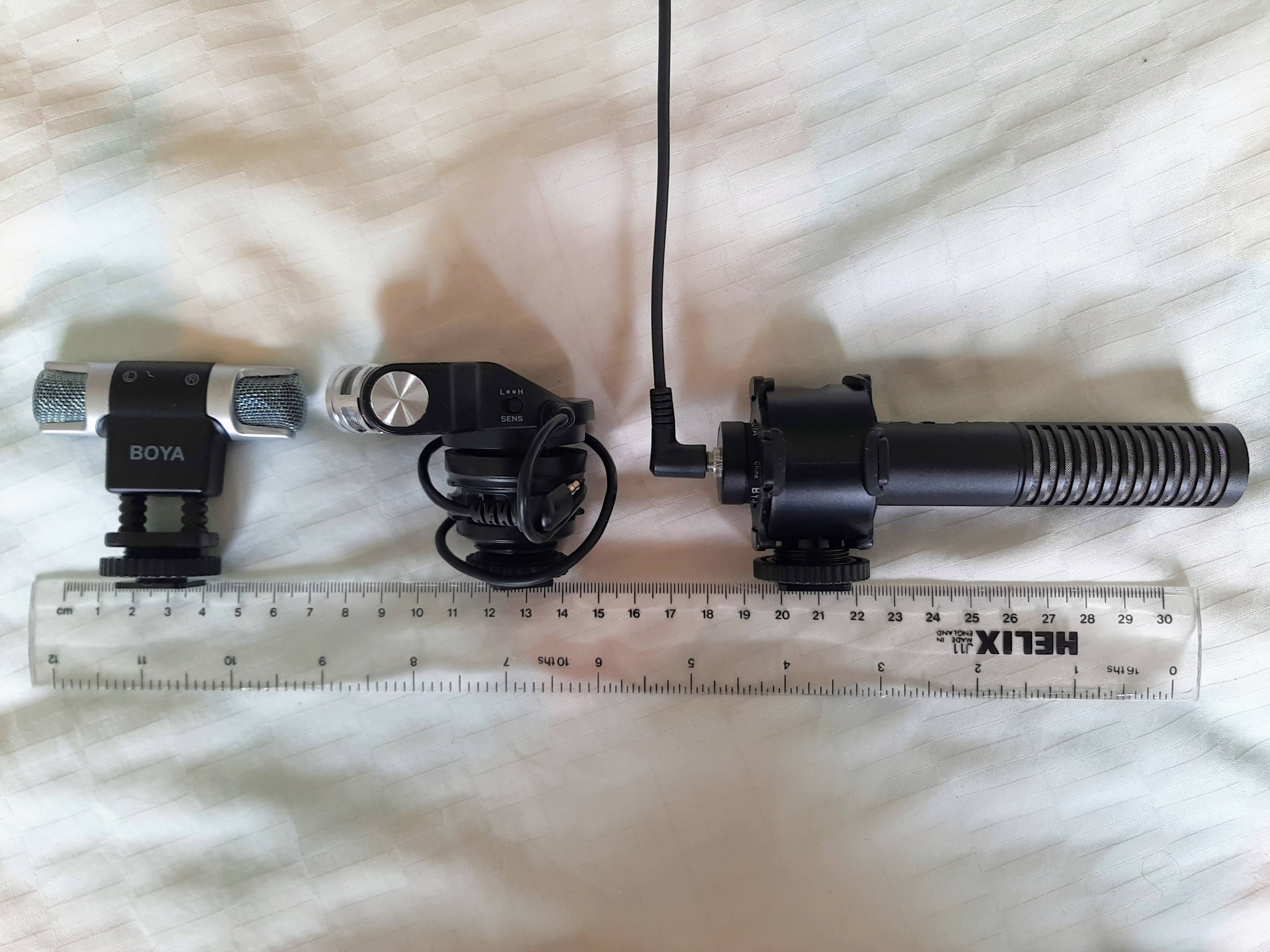

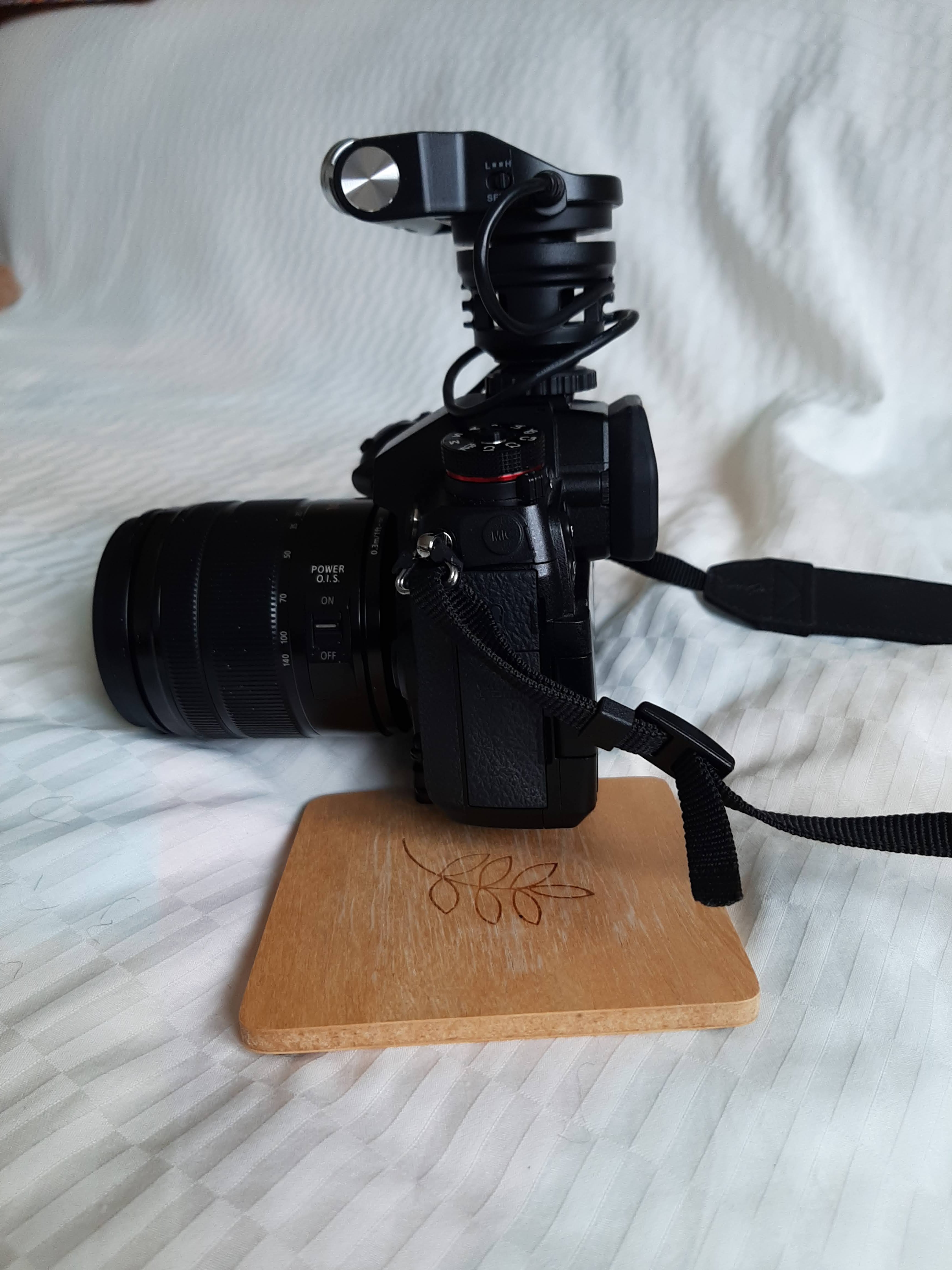

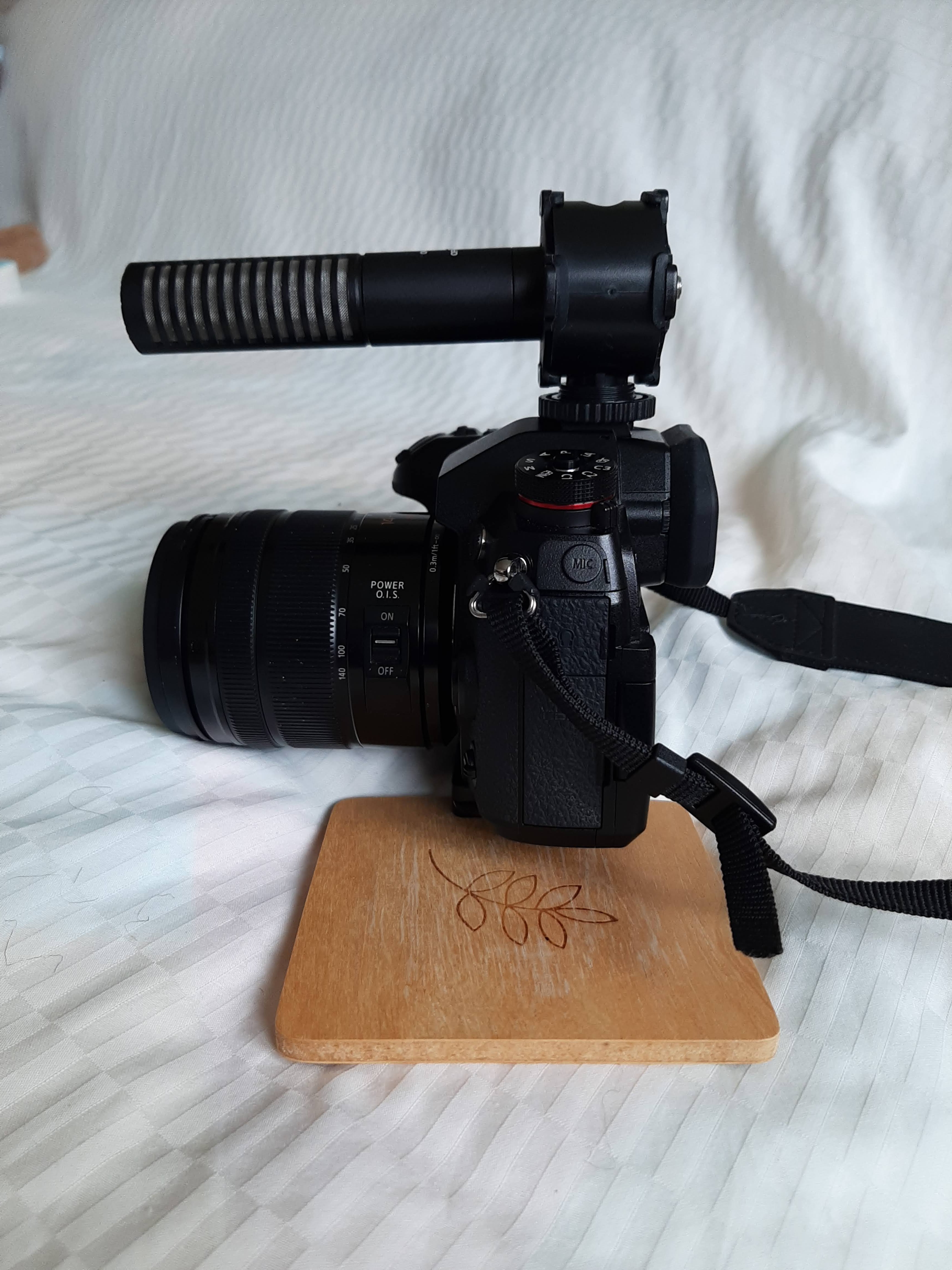

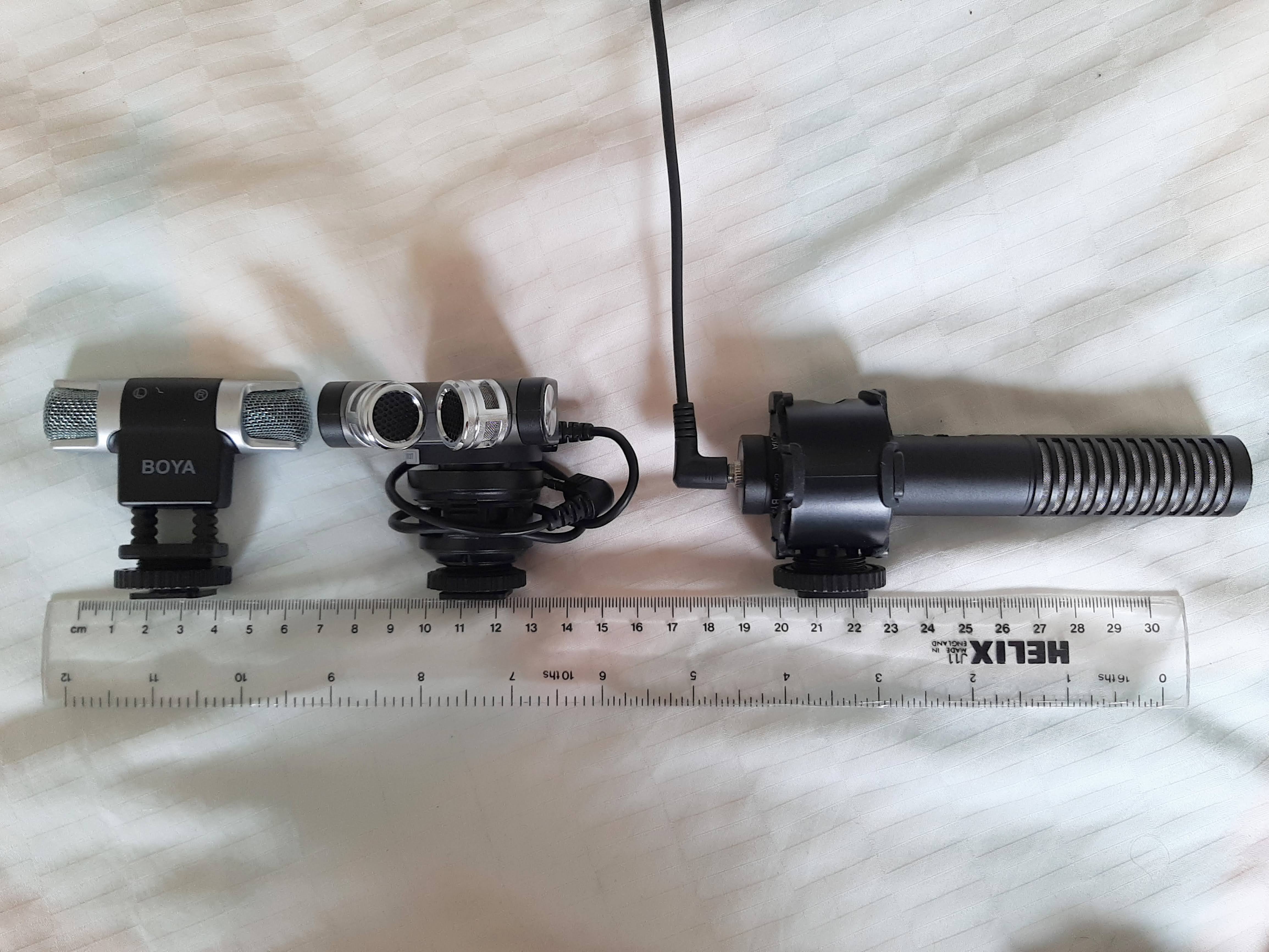

ac6000cw Posted April 23, 2023 Share Posted April 23, 2023 For a height comparison, these are the three relatively small stereo mics I use, mounted on my Pana G9 (which is around the same size as an S5). Tascam TM-2x (cardioid capsule X-Y stereo, plug-in power). Overall the most flexible, with a switchable low-cut filter, two sensitivity settings and a shock mount that works. Boya BY-PVM50 (cardioid capsule X-Y stereo, uses LR44 battery). The 3.5mm jack is at the rear centre of the barrel, and the mic can be moved forward and back in the shock mount. Boya BY-MM3 (omni capsule stereo, plug-in power). This is overall the smallest/lightest/least obtrusive, but as it's non-directional it's only really suitable for 'ambient sound' recording. hyalinejim, ntblowz, newfoundmass and 1 other 4 Link to comment Share on other sites More sharing options...

hyalinejim Posted April 23, 2023 Author Share Posted April 23, 2023 12 minutes ago, ac6000cw said: height comparison Thanks for this! The Tascam looks to be no higher than the Boya omni capsule. Do you have any comments on the sound quality of the Tascam? Link to comment Share on other sites More sharing options...
ac6000cw Posted April 23, 2023 Share Posted April 23, 2023 58 minutes ago, hyalinejim said: Thanks for this! The Tascam looks to be no higher than the Boya omni capsule. See below - from the left, BY-MM3 (without muff), TM-2x (side and front views) and BY-PVM50 58 minutes ago, hyalinejim said: Do you have any comments on the sound quality of the Tascam? Echoing what @newfoundmass said upthread, I think it sounds pretty decent (for a relatively low-cost, compact, stereo mic) and the camera viewfinder is still usable because it doesn't extend back much from the hotshoe. I think the capsules are the same as Tascam use on their low/mid-end handheld recorders. The bass end isn't subterranean, but it's fine with a bit of EQ, and I think it's generally smooth sounding but not super-detailed. I can't compare it to a Rode Stereo Video Mic Pro (which I think is what is pictured in your first post?) as I've never owned one (it's too large for me to consider using on relatively small mirrorless cameras). newfoundmass and hyalinejim 2 Link to comment Share on other sites More sharing options...

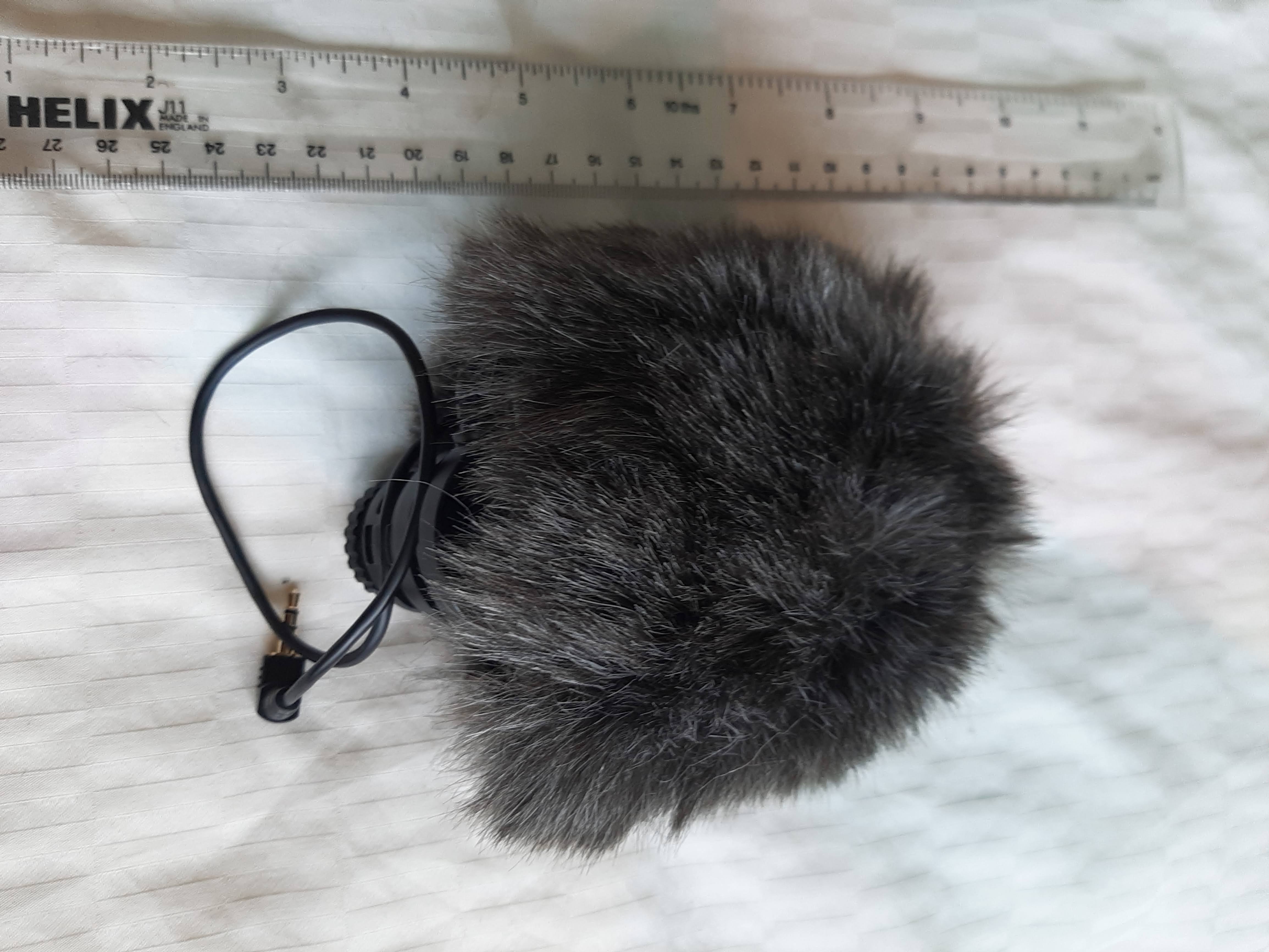

ac6000cw Posted April 23, 2023 Share Posted April 23, 2023 3 hours ago, hyalinejim said: How do you find the wind noise with the included dead cat? From a few YT videos it seems to do an OK-but-not-great job. Yes, it's 'OK-but-not-great'. I use an old Rycote fur 'windjammer' (which I owned before I bought the TM-2x) over a foam windshield. The windjammer is large enough to cover most of the mic plus foam, not just the capsule part like the Tascam one does. If you want to keep it small and it's not too windy, try using just a reasonably thick foam windshield (from memory, the included foam one is a bit thin). Link to comment Share on other sites More sharing options...

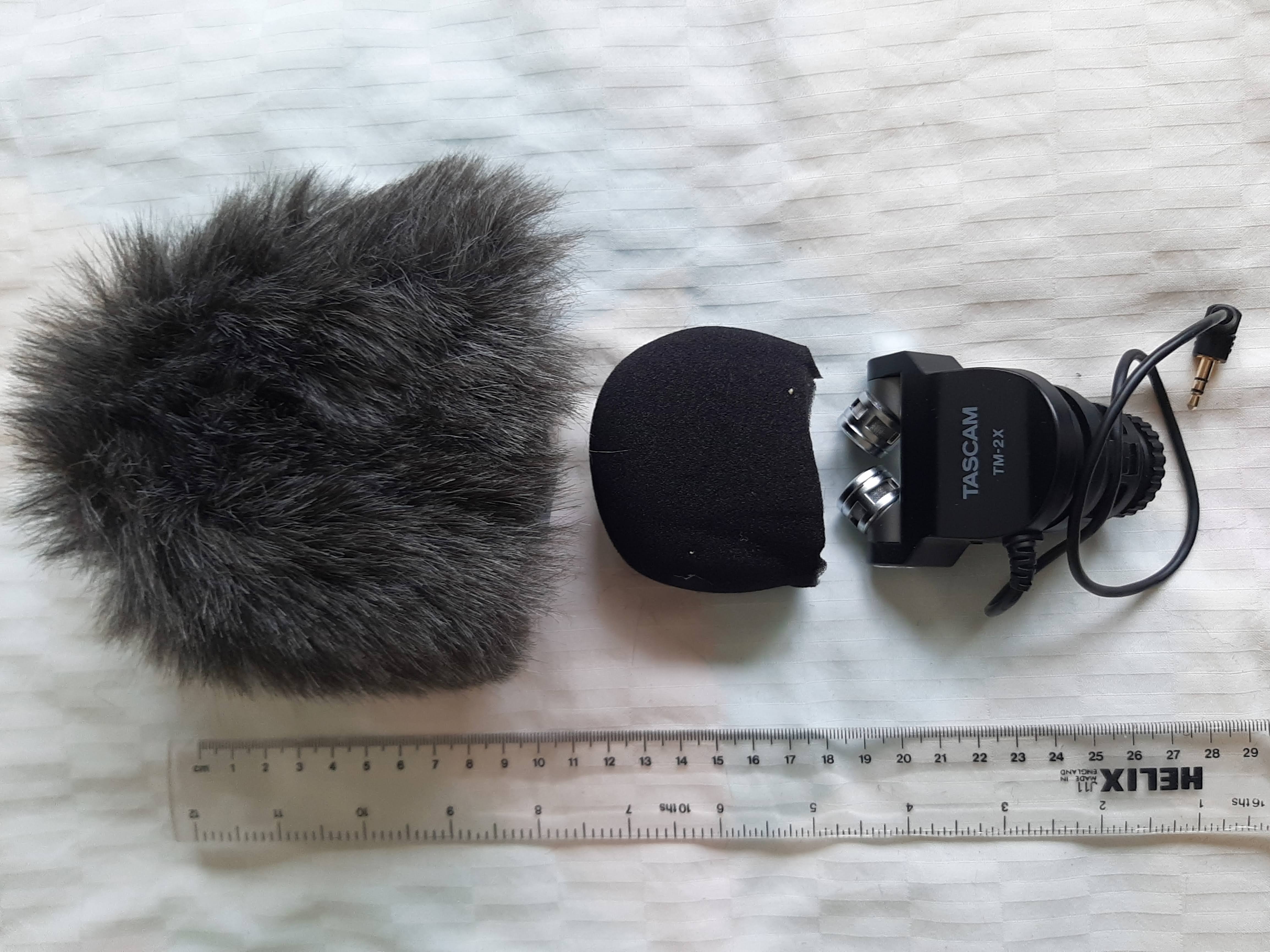

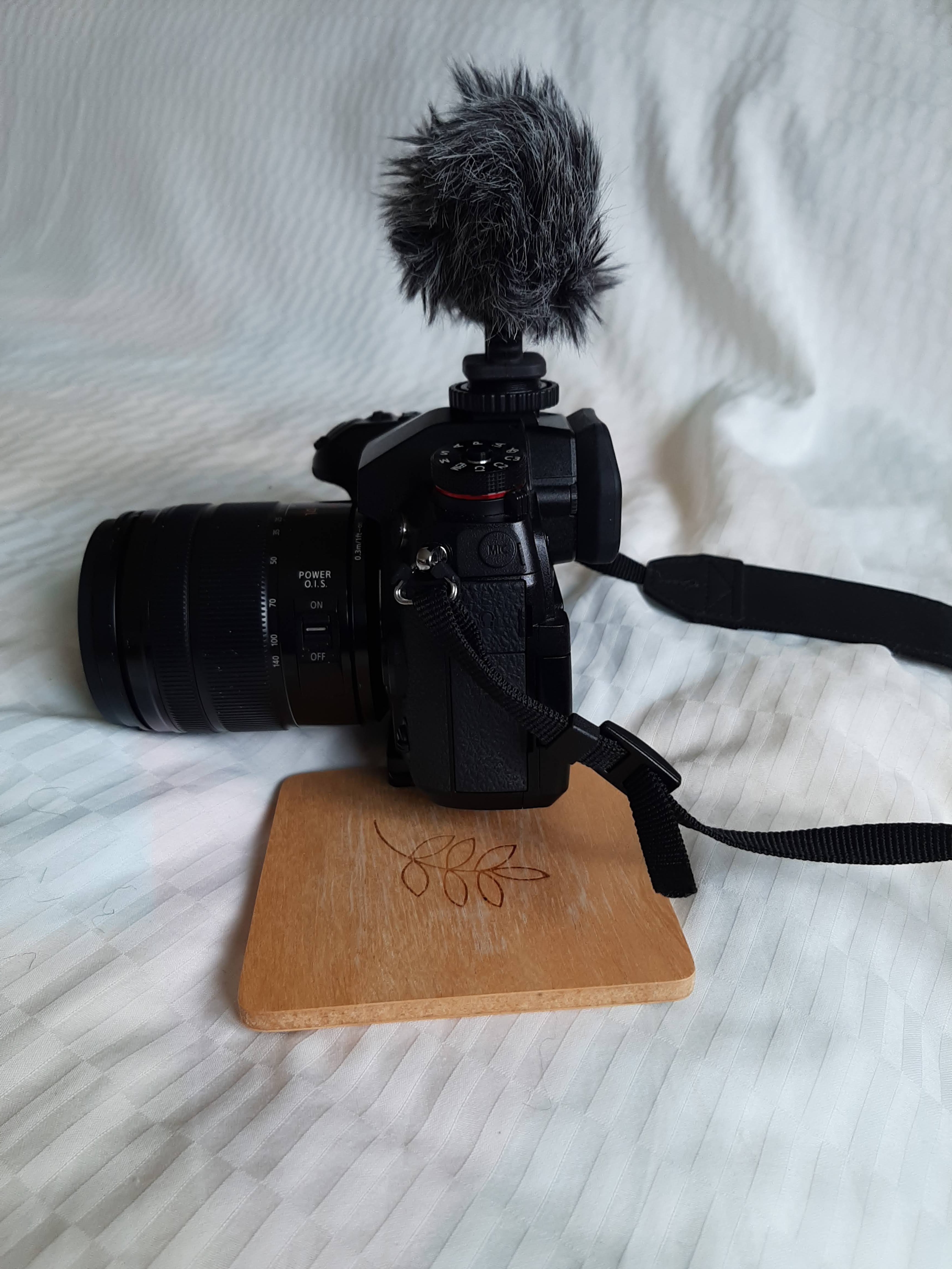

ac6000cw Posted April 24, 2023 Share Posted April 24, 2023 2 hours ago, hyalinejim said: And does this do the trick? I have an old dead cat from my Zoom H4n (5D Mark II days!) that worked well on that recorder and I can also squeeze it over the Rode VideoMic and it works fine. Yes - this is an 'exploded' view of it all (the foam is a trimmed-down cheap vocal mic pop shield): ...and it all fitted on the TM-2x: I've bought a few windmuffs from 'windcutuk' on Ebay over the years- they seem decently well made and work OK, and they do one for the TM-2x - https://www.ebay.co.uk/itm/165305982845?hash=item267d011f7d:g:7wIAAOSwks5ghLpY This is their windmuff on my Tascam DR-05 recorder: kye and hyalinejim 2 Link to comment Share on other sites More sharing options...

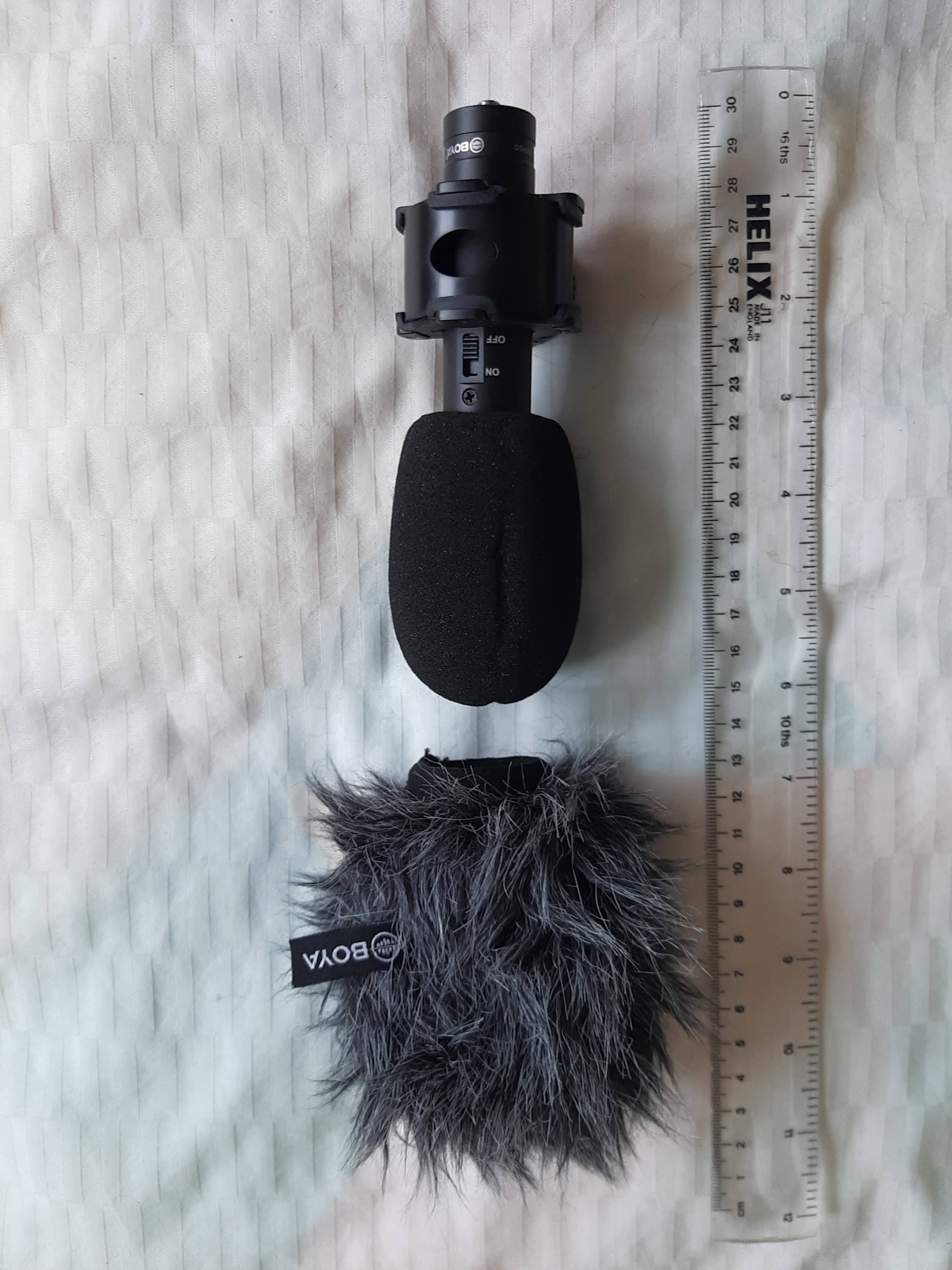

ac6000cw Posted April 24, 2023 Share Posted April 24, 2023 15 hours ago, kye said: However if you are looking for a smaller solution with good performance, I suspect that some sort of hybrid with multiple layers of different materials might be a good solution An inner foam layer with a 'furry' that fits over it works quite well e.g. below is what Boya supply with the BY-PVM50: (In that case you have to put the foam inside the furry first, then slide the whole thing over the mic barrel - it's really hard to pull the furry over the foam when it's already on the barrel !) kye 1 Link to comment Share on other sites More sharing options...
