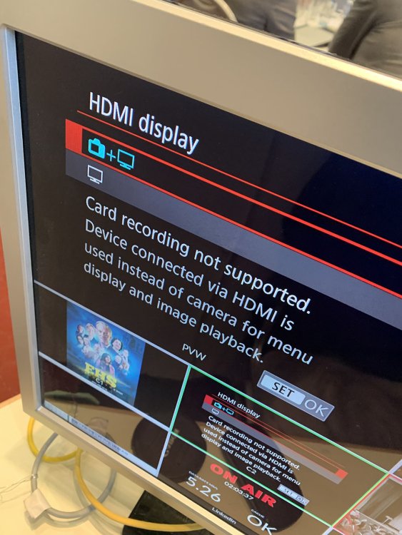

tosha187 Posted May 24, 2023 Share Posted May 24, 2023 Canon Cripple hammer Strikes Again! i was waiting for nearly 10 years to replace my OLD 5DmkIII (with the MagicLantern hack) as a camera that can run REC on continously nonstop while outputting clean HDMI out for livestreaming jobs. every camera that came after stops recording after 29:59min including my beloved EOS-R that cannot be used for continuous video. everybody knows that this limitation is completely invented. and it was only after Sony and Nikon removed it that Canon followed suit in their latest models, (including the entry level R10 & R50). this limitation is why i never got the R5 or R6. because I find it Rediculous that a 5000$ Camera that came out post 2020 is crippled by what is clearly an invented technicality. (and yes i heard the Taxation difference crap. give me a break! i would pay to remove it if they let us. as would everyone else) and if you were hoping for a firmware fix - tough luck! because... Canon! out comes the R6 MK2! my next camera! no 4k crop, no (fake) overheat crap, no Record limit. FINALLY! (2023 it's about time!) well here is the BIG Catch that no raving (and mostly biased or outright bribed) youtuber mentions in their happy positive reviews. nor is it mentioned on any of the Forums i have looked in. NO CARD RECORDING WITH CLEAN HDMI OUT CONNNECTED! (it works only with camera settings and focus squares visible in the stream) i guess im the only one stupid enough to be Livestreaming with Canon cameras. as you can probably tell i am VERRRRY dissapoineted. all my Sony shooting friends are jointly chanting "I told you So" to which i can clearly add "I should have known". my trust in the Canon brand is completely broken. i am really considering putting my 6 Canon bodies and 15 lenses on sale and starting a new chapter with a camera brand that i wont be dissapointed with EVERY TIME! i havnt checked the R7 R10 R50 R3 R8 yet, but i have the feeling that this is the case on most if not all new, continuously recording canon hyrid cameras. i just shelled out 3000eu on this camera and all i feel now is anger and frustration and most of all... Bewilderment. WHY CANON?!? sorry for the ranting but maybe this will help someone make a better informed buying decision before getting this otherwise amazing Camera for particularly what i use it for. Thank you and Good Luck! A. herein2020 1 Link to comment Share on other sites More sharing options...

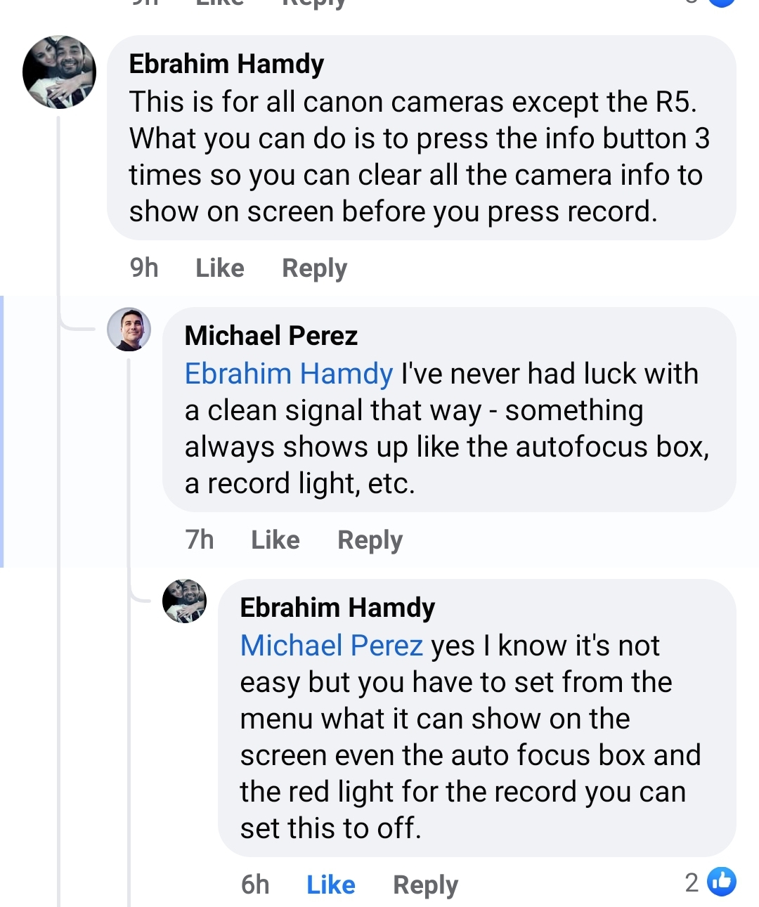

ntblowz Posted May 25, 2023 Share Posted May 25, 2023 You can do clean hdmi out with recording, make sure nothing is displayed before you press record. I done countless livesteram on Canon. Â Link to comment Share on other sites More sharing options...
tosha187 Posted May 25, 2023 Author Share Posted May 25, 2023 6 hours ago, ntblowz said: You can do clean hdmi out with recording, make sure nothing is displayed before you press record. I done countless livesteram on Canon. Â Â on card - in camera with HDMI out recording is what i was talking about. and R6MKII not Canon cameras in general. obviously you can record if you bring 5k of recording gear. what bothers me is the removal of basic features that were present since forever. Link to comment Share on other sites More sharing options...

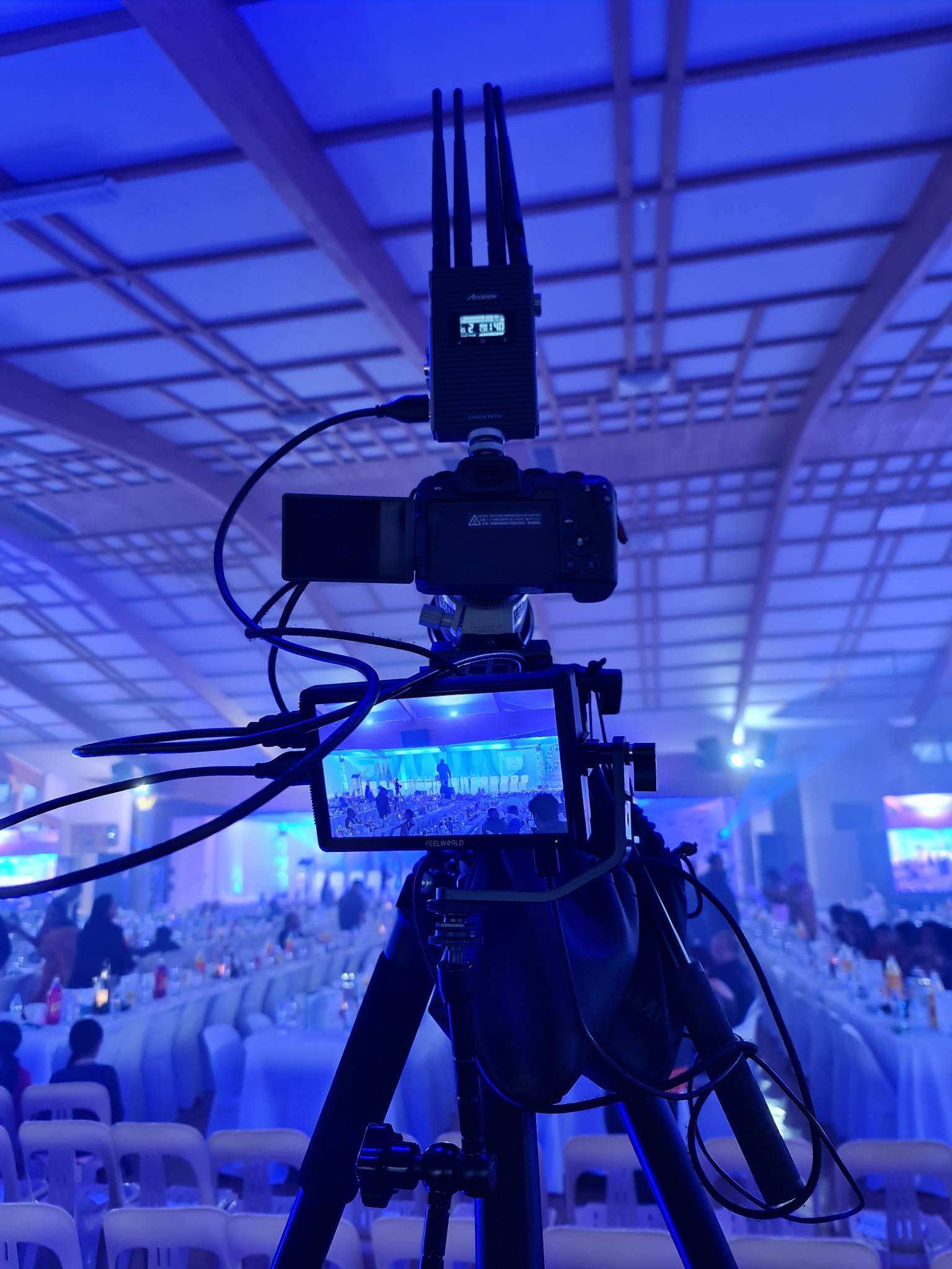

ntblowz Posted May 25, 2023 Share Posted May 25, 2023 This is with R7 and R5 livestreaming and recording in camera on both (R7 was on the other side) Link to comment Share on other sites More sharing options...
