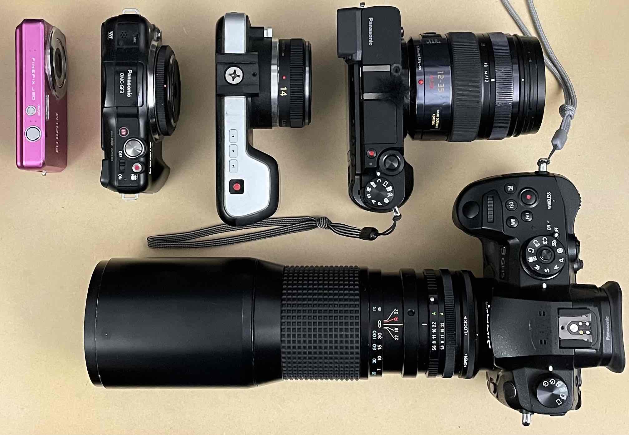

kye Posted June 6, 2023 Share Posted June 6, 2023 I occasionally use a tripod at home and have gotten fed up with the $100 ball-head Manfrotto I bought some years ago and am now pondering getting a better one. I typically use it for: Getting stable shots on very long lenses - for example with GH5 + 400mm + 2x digital zoom (1600mm equivalent) Getting shots of the moon/sun during eclipses or super-moons etc Getting more run-of-the-mill shots (which it works ok for now) The issues I have with the current tripod are: it doesn't pan or tilt smoothly, so when you push it just flexes and rebounds to the same position but if you push a bit harder it 'jumps' to a new position (it's probably plastic on plastic). I don't pan or tilt while recording, I just want to be able to aim it properly. it sags, so you unlock the head, frame the shot, lock the head, and it sags down because the lens is sticking out a long way, thus making you resort to the above. Obviously a $5000 tripod would be great, but I don't use it frequently enough to justify spending a serious amount of money on a high-quality one. I don't really care what it weighs as I don't take it anywhere. What is the minimum I'd have to spend to get something that would actually be functional to use at 800mm+ focal lengths? Link to comment Share on other sites More sharing options...
