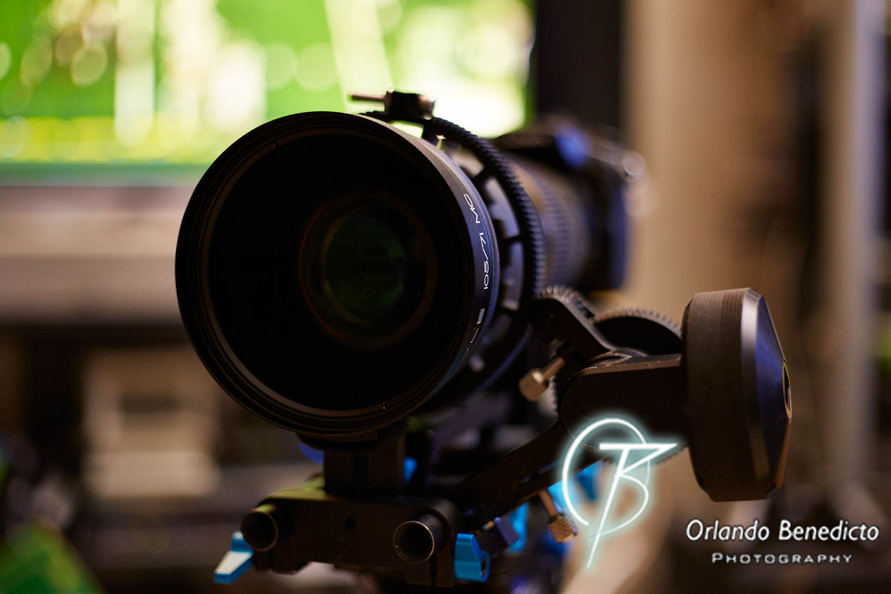

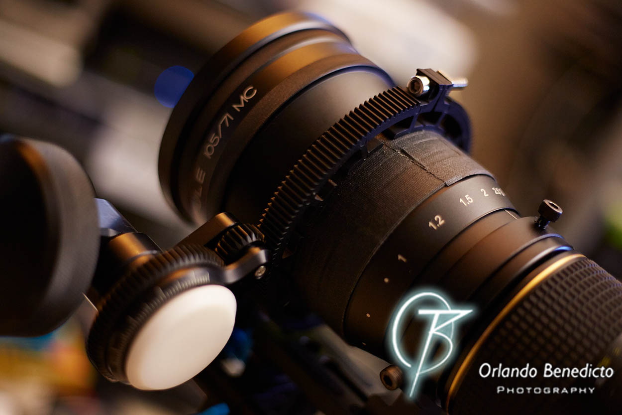

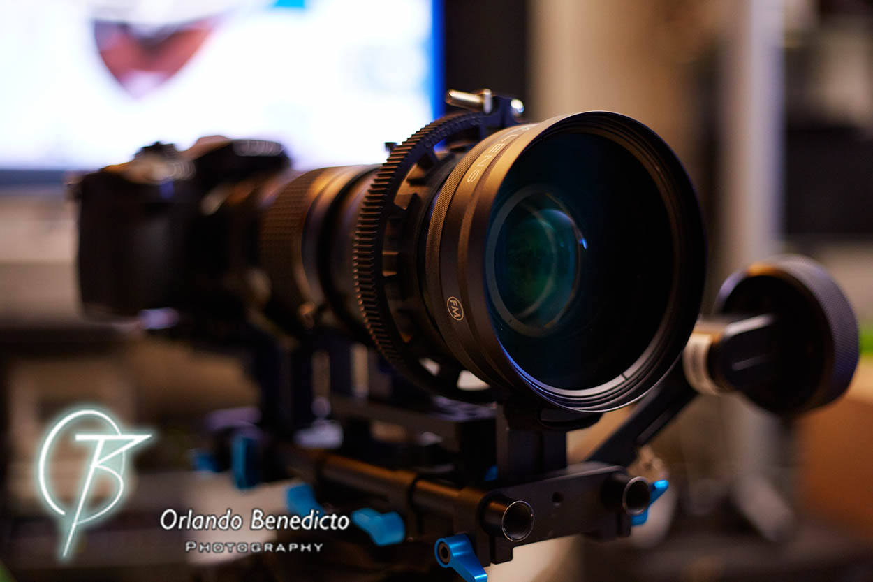

Cosimo murgolo Posted December 30, 2014 Author Share Posted December 30, 2014 What's going on there exactly?Sorry, I am not sure if you are asking me, but anyway if you are, I will try to explain.Once the Sankor is naked from his metal focus ring I've placed it in the FM, I then placed the metal tubeI that comes with the FM inside, and only a part of it was sticking out of the FM, almost the same size than the black collar that come with the FM. So I placed the black collar on the top of the metal tube, drew the holes to be drilled. I drilled three holes through the metal tube to let the white plastic screws go through the black collar and the metal tube, this way the white plastic screws reached the sankor and stopped it. Now I can align the anamorphic the way I want and I can exchange taking lens easily, and since your taking lens needs to be set to infinity to work, you don't need to attach it to the anamorphic the way I did before, you can shift the FM only if you are using zoom lenses and want a different focal length.This way the anamorphic is very close to the taking lens and I have seen improvements in the images.I hope I helped you out, any other questions feel free to ask, i will try to answer. nahua 1 Link to comment Share on other sites More sharing options...

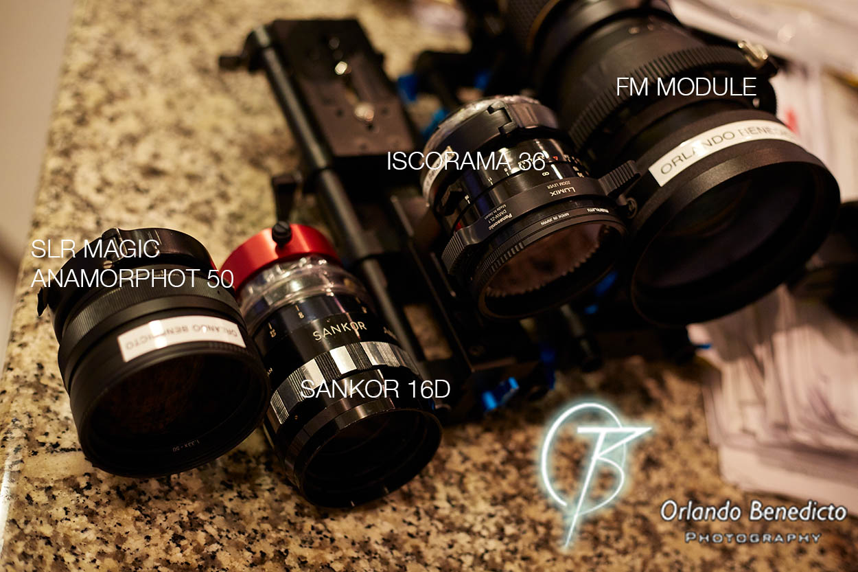

nahua Posted January 1, 2015 Share Posted January 1, 2015 Happy New Year!!!I'm finally happy with this setup. Not perfect but it works so far. I'll try and shoot some tests this weekend. Hans Punk and Cosimo murgolo 2 Link to comment Share on other sites More sharing options...
nahua Posted January 1, 2015 Share Posted January 1, 2015 Here's a comparison to the other anamorphics. Size is an issue, as is the massive weight. I normally shoot with a rig anyway, but this thing is easily noticed. Cosimo murgolo 1 Link to comment Share on other sites More sharing options...
Cosimo murgolo Posted January 1, 2015 Author Share Posted January 1, 2015 What anamorphic did you put inside the FM?Thanks for sharing, enjoy!!! nahua 1 Link to comment Share on other sites More sharing options...
nahua Posted January 1, 2015 Share Posted January 1, 2015 Thanks Cosimo! I got an Isco blue ultrastar. It fits perfectly. However I'll be doing surgery on my Sankor (like you did) to test it out. I'm not liking the Isco because it doesn't flare as well. Sharp, but I want more flares. Cosimo murgolo 1 Link to comment Share on other sites More sharing options...
