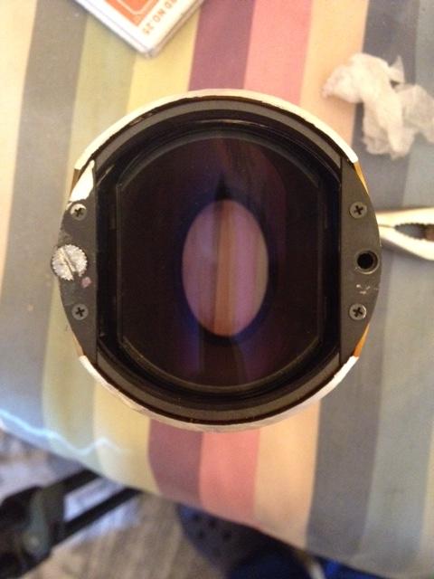

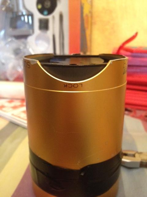

Cosimo murgolo Posted January 7, 2015 Author Share Posted January 7, 2015 Schneider super cinelux surgery.I was tired of those big lips in front of my Schneider super cinelux version 1, so today I managed to do a little surgery. I did it because now it can go all the way down the FM, this mod allows me to use an 85mm lens with my 5D without vignetting. It worked great inside the FM with his lips too, but I was limited to use a lens from 100mm to above. So you don't need to this mod, I DO NOT encourage you to do this as you may damage your lens. Better be safe than sorry! nahua and richg101 2 Link to comment Share on other sites More sharing options...

OzNimbus Posted January 9, 2015 Share Posted January 9, 2015 Schneider super cinelux surgery.I was tired of those big lips in front of my Schneider super cinelux version 1, so today I managed to do a little surgery. I did it because now it can go all the way down the FM, this mod allows me to use an 85mm lens with my 5D without vignetting. It worked great inside the FM with his lips too, but I was limited to use a lens from 100mm to above. So you don't need to this mod, I DO NOT encourage you to do this as you may damage your lens. Better be safe than sorry! Did you dremel that? What was your procedure? I've got one of these & might be interested in taking it down, too. Link to comment Share on other sites More sharing options...
Cosimo murgolo Posted January 9, 2015 Author Share Posted January 9, 2015 Did you dremel that? What was your procedure? I've got one of these & might be interested in taking it down, too.First of all I DO NOT encourage you to do this, as you may damage your lens, don't blame me if you do damage your lens I followed Richg101 tutorial on how to do this.You can use whatever tool you feel comfortable with, I used a sort of Dremel, I protected the lens with a clean film to avoid the dust going inside the lens.Once the lips came off, I've used a grinder to smooth the surface of the cutting parts, I then cut the little iron knob to adjust the focus at the same level and made a cut in between so that I can screw in and out the knob with a screw driver, be very careful though, don't go to flat with it.Good luck and let me know how it goes.I hope it helped! nahua and OzNimbus 2 Link to comment Share on other sites More sharing options...

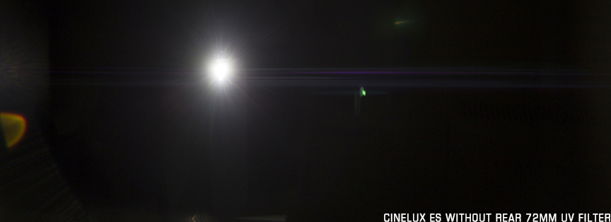

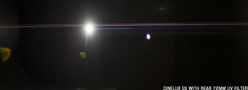

Hans Punk Posted January 9, 2015 Share Posted January 9, 2015 Hi guys....been away with work recently so not many posts from me recently.After a discussion with richg101 I decided to test the theory that introducing more optical faces into the Cinelux would result in nicer contrast and flares.So I mounted a 72mm cheap UV filter to the rear of the Cinelux and as you can see...it helps considerably by introducing internal reflection. It Should also help intensify other similar lenses (ultrastar etc) - although I don't have mine anymore to test.Very useful for those who are disappointed by the lackluster flares often found with these MC optics. dahlfors, anti12, Cosimo murgolo and 1 other 4 Link to comment Share on other sites More sharing options...
Cosimo murgolo Posted January 9, 2015 Author Share Posted January 9, 2015 Nice tip there Hans, thanks for sharing it, that's what I got using Focus Module Isco animex olympus OM 100mm combo from different light source.I am going to try with the UV filter in the rear. nahua 1 Link to comment Share on other sites More sharing options...
Julio Garcia Fernandez Posted January 10, 2015 Share Posted January 10, 2015 I just tried the UV filter in the 50mm super takumar prime lens and mi cinelux 1 with FM is MUCH BETER AND BIGGER flares, thank you Hans for the advise. Hans Punk, nahua and Cosimo murgolo 3 Link to comment Share on other sites More sharing options...

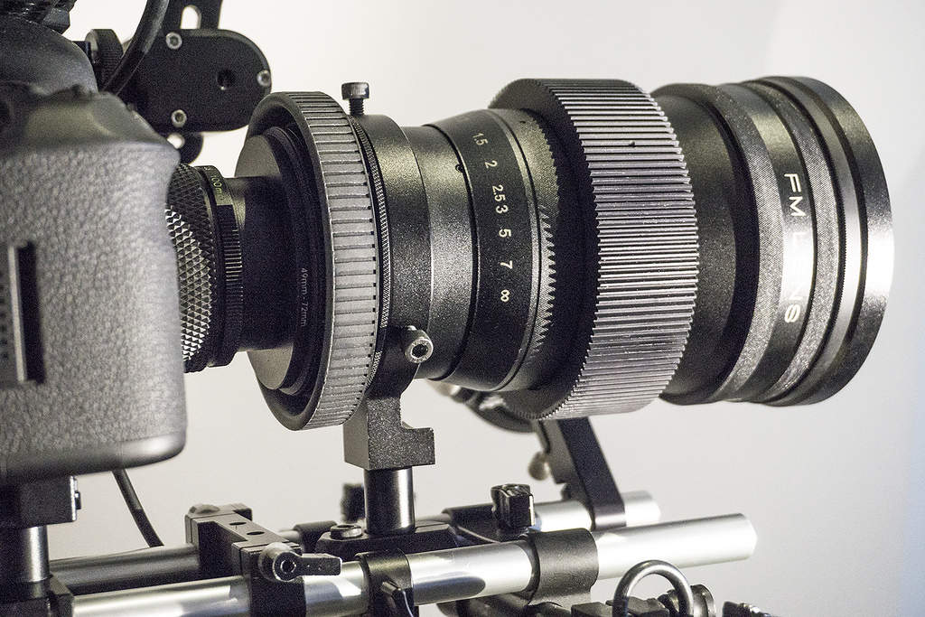

Hans Punk Posted January 21, 2015 Share Posted January 21, 2015 So I've received my RafCamera gear that I commissioned for my FM lens and I'm glad to report it fits perfectly.http://rafcamera.com/en/accessories/ff-gears/gear-fm-lens-88-107-32mmIt is VERY tight fit to put on (which is good) - so if you buy one, be prepared to expect that. More pictures of it setup on my 5DmkIIIhttps://www.flickr.com/photos/129041403@N06/sets/72157650417068585/ anti12 and Cosimo murgolo 2 Link to comment Share on other sites More sharing options...
