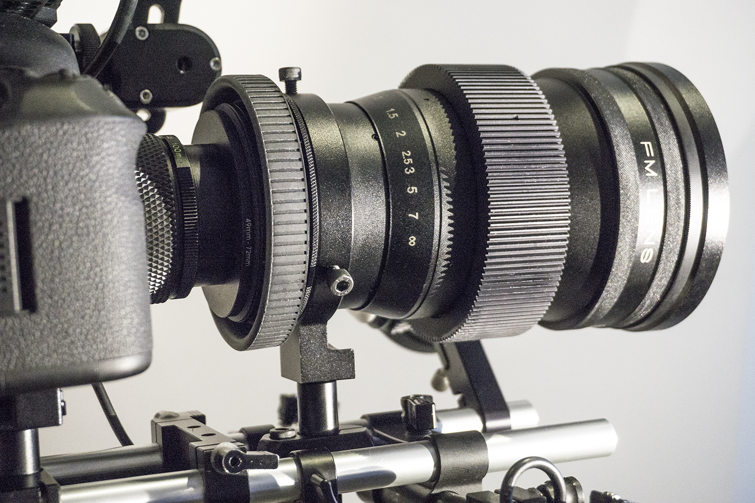

Kristoferman Posted January 21, 2015 Share Posted January 21, 2015 How well does it work with the edelkrone?? Link to comment Share on other sites More sharing options...
Kristoferman Posted January 21, 2015 Share Posted January 21, 2015 I guess my question is why the need for the metal tube at all??? If the smaller anamorphics go inside the tube, couldn't you just clamp to the anamorphic instead? Sorry for the basic questions. Link to comment Share on other sites More sharing options...
Hans Punk Posted January 21, 2015 Share Posted January 21, 2015 How well does it work with the edelkrone??Not great to be honest - as the edelkrone only clamps to one 15mm rod, so the heavy torque of the FM focus helicoid tends to push the alignment off unless the Edelkrone is seriously cranked down on it's locking lever.A follow focus with regular duel rod clamp would work better - i'll dig out my other FF to give that a try soon.When not using a follow focus, having a solid chunky focus gear feels better in the hand anyway - allows smoother pulls and further range, having that larger diameter. Cosimo murgolo 1 Link to comment Share on other sites More sharing options...
Hans Punk Posted January 21, 2015 Share Posted January 21, 2015 I guess my question is why the need for the metal tube at all??? If the smaller anamorphics go inside the tube, couldn't you just clamp to the anamorphic instead? Sorry for the basic questions.The FM lens clamps itself to the cinelux type lenses via tiny grub screws - then the rear of the cinelux body is clamped to the large ring clamp.When not using a Cinelux - the tube acts as a proxy cinelux, allowing an alternative (smaller) anamorphic lens to take it's place. Here is a reminder of how it all fits together...imagine the cinelux is a hollow aluminium tube with a smaller anamorphic lens inside - then it should make sense: https://vimeo.com/105787520 Cosimo murgolo 1 Link to comment Share on other sites More sharing options...
Kristoferman Posted January 21, 2015 Share Posted January 21, 2015 Oh OK....So make smaller anas fit, you're gonna HAVE to screw through the metal tube and clamp the ana to that in first, THEN attach to FM? Starting to make sense. Link to comment Share on other sites More sharing options...
Hans Punk Posted January 21, 2015 Share Posted January 21, 2015 Oh OK....So make smaller anas fit, you're gonna HAVE to screw through the metal tube and clamp the ana to that in first, THEN attach to FM? Starting to make sense.Cosimo did a nice job by drilling the mounting tube - then inserting nylon screws to make it a clamp smaller anamorphics (again, info is in this thread a few pages back).I however can pack my Kowa B&H into the tube (after taking kowa's focus ring off) and simply tape it in centered to the FM mounting tube.I'll probably make a video on how that is done soon, as the principle is the same for any smaller anamorphic lens that people may want to use within the FM lens. Cosimo murgolo 1 Link to comment Share on other sites More sharing options...

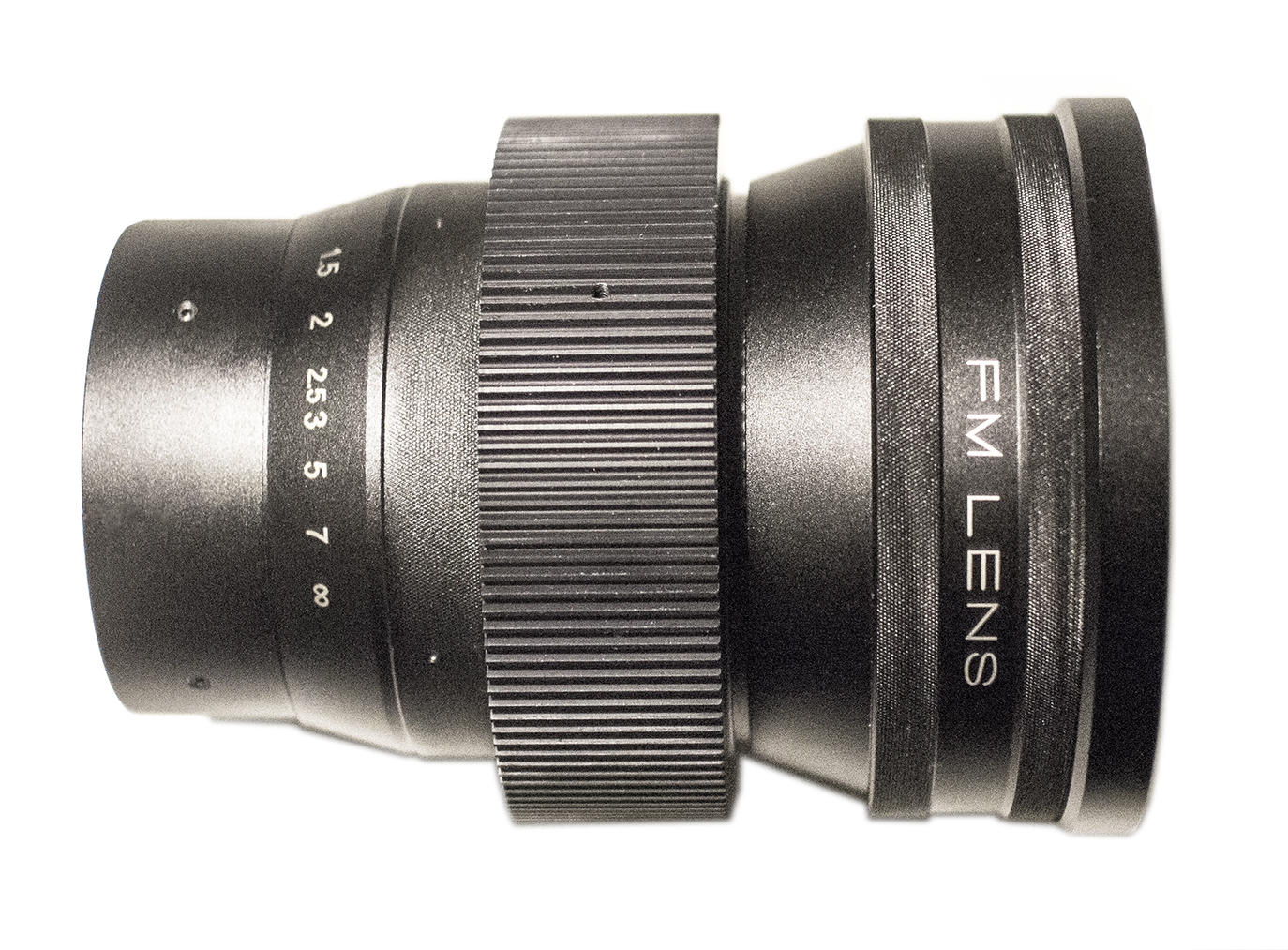

Kristoferman Posted January 22, 2015 Share Posted January 22, 2015 trying to install my FM tonight. my unit doesn't seem to rotate (no focus spin) ? at the end where it meets the taking lens, there are 4 screw thingies but they're extremely tiny (the included hex key doesn't fit) and according to the installation video, there should be two sets. I think something is stuck? Did anyone else have this problem? Link to comment Share on other sites More sharing options...
Hans Punk Posted January 22, 2015 Share Posted January 22, 2015 trying to install my FM tonight. my unit doesn't seem to rotate (no focus spin) ? at the end where it meets the taking lens, there are 4 screw thingies but they're extremely tiny (the included hex key doesn't fit) and according to the installation video, there should be two sets. I think something is stuck? Did anyone else have this problem? Sounds like the wrong holes.take your thumb and finger and pinch the back lip of the FM lens opening and twist counter-clockwise. It sounds like the helicoid is wound closed (normal for shipping).When the lens turns it will extend to reveal the 4 hex screws that you use to clamp onto the cinelux body or mounting tube. Cosimo murgolo 1 Link to comment Share on other sites More sharing options...
Cosimo murgolo Posted January 22, 2015 Author Share Posted January 22, 2015 This a quick video showing you all how I did fit the Sankor 16D, the Isco animex s8/2x and proskar.It’s my first video tutorial so forgive me if it’s not done in a proper way. I hope this will help you out, and I am sure someone will do a better job than I did, I just wanted to show you the idea behind all this.I just want you to remember that the FM will work best with all those anamorphic lens that fit 70,5mm to 71 diameter tube and have a length of at least 10 to 12cm as the inner tube of the FM is 89mm long. The end part of your anamorphic lens has to stick out in order to get close to the taking lens. If the diameter of the anamorphic is less than what has been mentioned above but has the proper length there is a workaround with the need of a metal tube that comes with the FM, like I am showing you in the video If you need to know more do not hesitate to ask, I will be happy to help you out if I can. This is one of the advantages of the FM , you can really stick in any vintage anamorphic lenses, but they need to have those dimensions. This is the main reason I chose to work with the FM. People still did not realize the potential of this, you can swap vintage anamorphic lenses and achieve different look and have single focus of course. Now the sankor among the other 2 anamorphic I fitted is the longest one and sat very well inside the FM, touching the optic of the FM, the Isco animex and the proskar are a bit too short and they do not touch completely the optic of the FM there is approximately 1 cm still to go but they do work fine.I will post some video with both anamorphic to show you that even if they do not touch the optic of the FM they still work fine.https://vimeo.com/117484987 Link to comment Share on other sites More sharing options...

Hans Punk Posted January 22, 2015 Share Posted January 22, 2015 Focus gear update! RafCamera has just confirmed to me that he will from now on supply his FM focus gear with the internal diameter bored out by an additional 0.1mmThis will allow the gear to be fitted on and off much more smoothly - without it being such a super tight fit.It seems that my initial measurements were correct, but did not fully take into account the friction caused by the knurled aluminium finish on the FM body.Gear available here: http://rafcamera.com/en/accessories/ff-gears/gear-fm-lens-88-107-32mm Cosimo murgolo 1 Link to comment Share on other sites More sharing options...
