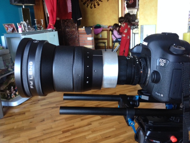

Cosimo murgolo Posted December 22, 2014 Author Share Posted December 22, 2014 That's my set up at the moment, I am very happy with it, I didn't get how to calibrate the FM focus soon, but thanks to Hans and the anamorphic guys I managed to get the FM focus right.Next I am going to try to fit the proskar and the sankor, if I can.At the moment I didn't have time to make a video, very busy flying around, I am looking forward to play with my toy soon.I am so excited !!!!The combo in the photo includes schneider cinelux with lips and olympus 100mm f2.8.http://http:// nahua 1 Link to comment Share on other sites More sharing options...

nahua Posted December 22, 2014 Share Posted December 22, 2014 That's my set up at the moment, I am very happy with it, I didn't get how to calibrate the FM focus soon, but thanks to Hans and the anamorphic guys I managed to get the FM focus right.Next I am going to try to fit the proskar and the sankor, if I can.At the moment I didn't have time to make a video, very busy flying around, I am looking forward to play with my toy soon.I am so excited !!!!The combo in the photo includes schneider cinelux with lips and olympus 100mm f2.8. Damn that thing looks huge. Can't wait to see more tests. I'm waiting for mine I hope to get it soon. Thanks again Cosimo for setting up the group discount! Link to comment Share on other sites More sharing options...

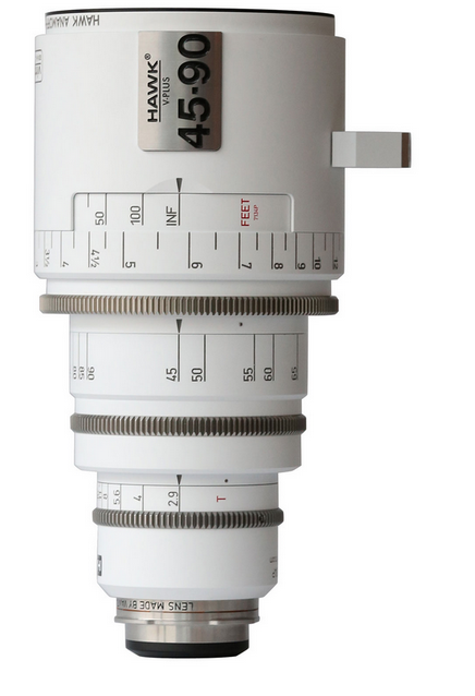

Cosimo murgolo Posted December 22, 2014 Author Share Posted December 22, 2014 Damn that thing looks huge. Can't wait to see more tests. I'm waiting for mine I hope to get it soon. Thanks again Cosimo for setting up the group discount!The Hawk in the photo it's huge and expensive, FM it's only heavy , you are welcome Nahua. nahua 1 Link to comment Share on other sites More sharing options...
Kristoferman Posted December 22, 2014 Share Posted December 22, 2014 sexy though...big 'n sexy. Link to comment Share on other sites More sharing options...

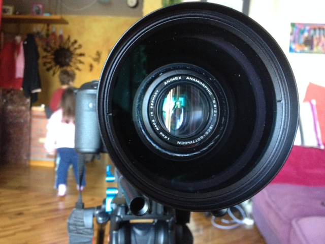

Cosimo murgolo Posted December 23, 2014 Author Share Posted December 23, 2014 I spent the whole morning trying to fit my Isco animex s8/2x inside the FM, at end I did it. Next I am going to try to with my ishico proskar and last the Sankor 16D. I am crossing my fingers. Link to comment Share on other sites More sharing options...

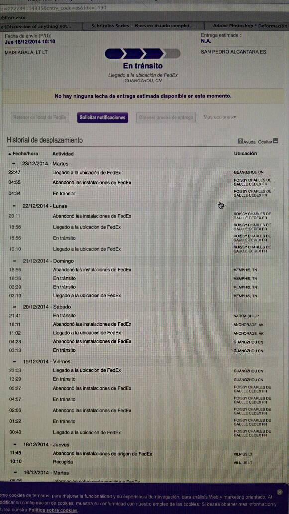

Julio Garcia Fernandez Posted December 23, 2014 Share Posted December 23, 2014 My FM is now giving the second round to the world thanks to FEDEX.....Im sure Santa is not coming to the town this Christmas..... Link to comment Share on other sites More sharing options...
Cosimo murgolo Posted December 23, 2014 Author Share Posted December 23, 2014 My FM is now giving the second round to the world thanks to FEDEX.....Im sure Santa is not coming to the town this Christmas..... I am very very sorry to hear that, I know how it feels, puta mierda!!!! Link to comment Share on other sites More sharing options...
