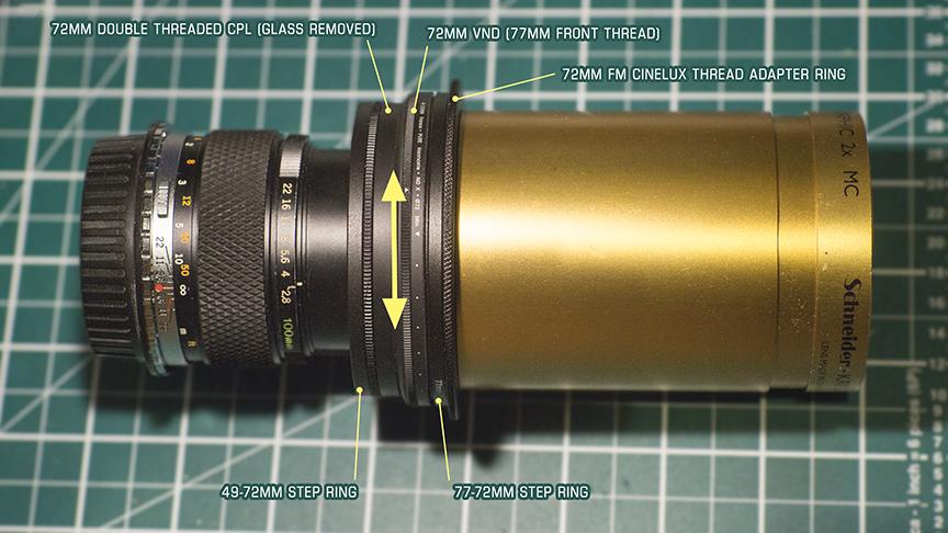

Cosimo murgolo Posted December 26, 2014 Author Share Posted December 26, 2014 For mirror-less cameras unfortunately...the flange focal distance on your (and my) 5DmkIII does not allow an internal ND setup like that. So the best solution would be to use a regular screw-on VND or fixed ND filter at the rear of the FM lens. When I am back home tomorrow I will post an image of the VND setup I constructed - it's pretty simple but it works well.Ok, what a shame, yes please, post some photos, that will be great, thanks again man! Link to comment Share on other sites More sharing options...
Liszon Posted December 26, 2014 Share Posted December 26, 2014 Häns, that sounds like a smart solution to use VND's, could you post a close-up shot of your filter setup? Link to comment Share on other sites More sharing options...

Hans Punk Posted December 27, 2014 Share Posted December 27, 2014 Häns, that sounds like a smart solution to use VND's, could you post a close-up shot of your filter setup?Ok, so this is what I've come up with so far using what bit's I had lying around. Basically this setup allows light-proof and hard linkage between the taking lens and the cinelux rear, yet allows free spinning of the VND in the middle section of the ring assembly.To make it work you need to get a cheap double threaded CPL filter and remove the glass. This give you a rotating double threaded filter (in my example 72mm). The purpose of this empty spinning filter is so that the VND can spin freely when coupled together - without unscrewing itself from the other rings.Then attach a double threaded VND filter (in my case 72mm Cokin 'Slim Pure Harmonie') to the empty CPL filter. The cokin VND has a front female thread of 77mm (other VND's may not have a front thread but this one does)Attach that to a 77-72mm step down ring....Then screw into the FM cinelux 72mm rear thread adapter ring. Once assembled and all rings tightened together properly - it gives a nice VND solution that is sandwiched between adapter rings. In my case I am using taking lenses with a 49mm front thread, but that step down from 72mm can be whatever is needed. The distance between taking lens optic and cinelux rear is just under 30mm - which does not seem to cause any vignette issues when shooting 85mm + with 4:3 ML raw on canon 5DmkIII.It is a work in progress, but does allow your favorite taking lens to be 'hard' attached to the FM lens if you want. So the whole setup can be treated as if a monoblock design. The cool thing is the taking lens can twist into the lens mount as normal, as the linkage to the cinelux will allow rotation.If I were to be using a non-cinelux type anamorphic inside the FM, I suspect a good solution would be to simply have a VND screwed onto the taking lens - with a rubber lens hood attached to the front thread of the VND. This would allow a bit of light-proofing of the join between taking lens and anamorphic rear, without hard linkage or screw fitting of any additional rings. Julian, Cosimo murgolo, richg101 and 2 others 5 Link to comment Share on other sites More sharing options...

Cosimo murgolo Posted December 27, 2014 Author Share Posted December 27, 2014 Ok, so this is what I've come up with so far using what bit's I had lying around. Basically this setup allows light-proof and hard linkage between the taking lens and the cinelux rear, yet allows free spinning of the VND in the middle section of the ring assembly.To make it work you need to get a cheap double threaded CPL filter and remove the glass. This give you a rotating double threaded filter (in my example 72mm). The purpose of this empty spinning filter is so that the VND can spin freely when coupled together - without unscrewing itself from the other rings.Then attach a double threaded VND filter (in my case 72mm Cokin 'Slim Pure Harmonie') to the empty CPL filter. The cokin VND has a front female thread of 77mm (other VND's may not have a front thread but this one does)Attach that to a 77-72mm step down ring....Then screw into the FM cinelux 72mm rear thread adapter ring. Once assembled and all rings tightened together properly - it gives a nice VND solution that is sandwiched between adapter rings. In my case I am using taking lenses with a 49mm front thread, but that step down from 72mm can be whatever is needed. The distance between taking lens optic and cinelux rear is just under 30mm - which does not seem to cause any vignette issues when shooting 85mm + with 4:3 ML raw on canon 5DmkIII.It is a work in progress, but does allow your favorite taking lens to be 'hard' attached to the FM lens if you want. So the whole setup can be treated as if a monoblock design. The cool thing is the taking lens can twist into the lens mount as normal, as the linkage to the cinelux will allow rotation.If I were to be using a non-cinelux type anamorphic inside the FM, I suspect a good solution would be to simply have a VND screwed onto the taking lens - with a rubber lens hood attached to the front thread of the VND. This would allow a bit of light-proofing of the join between taking lens and anamorphic rear, without hard linkage or screw fitting of any additional rings. Thanks Hans, I will have a close look at this. Link to comment Share on other sites More sharing options...

Liszon Posted December 28, 2014 Share Posted December 28, 2014 Häns, that looks great, thanks for the explanation! I can't wait to try it. Link to comment Share on other sites More sharing options...
Hans Punk Posted December 28, 2014 Share Posted December 28, 2014 Häns, that looks great, thanks for the explanation! I can't wait to try it.I also think rubber lens hood mounted to the front of a VND would be a good all round solution for the taking lens - as that would provide a seal against light entering the taking lens front and the anamorphic rear. The VND can be spun by twisting the rubber hood.When I get my 77mm rubber lens hood - i'll test that and see if it is better than hard mounting. Liszon 1 Link to comment Share on other sites More sharing options...
