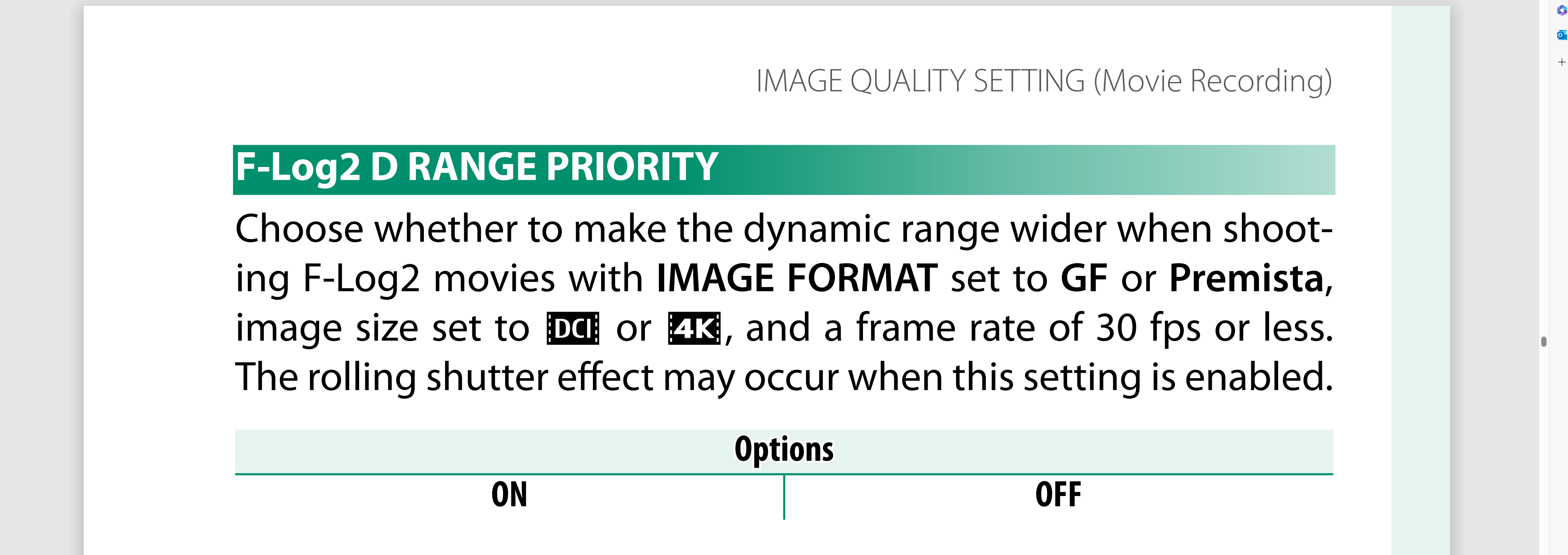

Kino Posted October 6, 2023 Share Posted October 6, 2023 9 hours ago, androidlad said: 2 x readout speed is achieved by using 12bit readout mode https://blog.kasson.com/gfx-100-ii/more-on-gfx-100-ii-electronic-shutter-speeds/ GFX100/S aren't able to do that likely because of the limitation of the processor, not the sensor. Fuji has confirmed that video mode on the GFX 100 II is 12 bit. Does the original GFX 100 have 14-bit readout in 4K video? Perhaps they wouldn't be offering a "new and improved sensor" for $2500 less. The new PDAF could be exclusively software based. There is also the interesting setting described in the manual on page 197: It seems like this will restore 14-bit readout in video, as the tradeoff is increased rolling shutter, but Fuji will not confirm how this extra DR is achieved. I would be curious to see some tests in this mode. Link to comment Share on other sites More sharing options...
androidlad Posted October 6, 2023 Share Posted October 6, 2023 2 hours ago, Kino said: Fuji has confirmed that video mode on the GFX 100 II is 12 bit. Does the original GFX 100 have 14-bit readout in 4K video? Perhaps they wouldn't be offering a "new and improved sensor" for $2500 less. The new PDAF could be exclusively software based. There is also the interesting setting described in the manual on page 197: It seems like this will restore 14-bit readout in video, as the tradeoff is increased rolling shutter, but Fuji will not confirm how this extra DR is achieved. I would be curious to see some tests in this mode. 2 x readout speed in Fujifilms advertising mainly refers to stills performance, the max 8fps CH mode has been confirmed by Jim Kasson that it's 12bit readout then dithered to 14bit. Original GFX100/S are limited by the processor and I/O. Flog2 D range priority mode is achieved by using 12bit Low Noise readout mode. The sensor is not fast enough for 14bit readout in video mode. Link to comment Share on other sites More sharing options...
Kino Posted October 6, 2023 Share Posted October 6, 2023 54 minutes ago, androidlad said: Flog2 D range priority mode is achieved by using 12bit Low Noise readout mode. Dual Conversion Gain (DCG)? Something has to account for the increased rolling shutter. Link to comment Share on other sites More sharing options...
