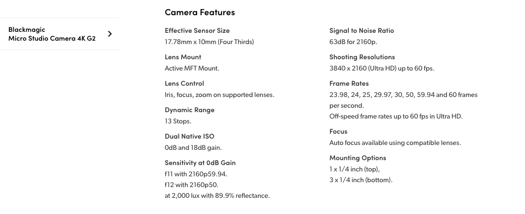

kye Posted November 4, 2023 Share Posted November 4, 2023 On 11/2/2023 at 2:47 AM, Emanuel said: Forget the model just for a while : P and tell me if this is not the best bang for the buck nowadays? Actually, here's my nomination for best-bang-for-buck camera nowadays - the Blackmagic Micro Studio Camera 4K G2 just announced by BM. Here's why: It's tiny, and fits the entire ecosystem of the previous Micro models, including battery type (Canon LP-E6) It can record BRAW up to DCI 4K60 to USB-C....   so you don't need a big expensive external recorder, you can use any old HDMI monitor you like! BM specifies 13 stops of DR, the same as all their previous cinema cameras, and up from the 11 stops they quoted for the previous Micro Studio camera It has AF (it won't be fast, but the previous BMMCC didn't have AF, and the OG BMPCC one was quite useful) It's $995! So, it's smaller and cheaper than the P4K, but appears to only have one native ISO.  Interesting. bjohn, solovetski and Emanuel 3 Link to comment Share on other sites More sharing options...
Super Members BTM_Pix Posted November 4, 2023 Author Super Members Share Posted November 4, 2023 5 hours ago, kye said: Appears to only have one native ISO. It does have two but with it being made for broadcast it is expressed as gain (0db and 18db in this case). Emanuel and kye 2 Link to comment Share on other sites More sharing options...
kye Posted November 5, 2023 Share Posted November 5, 2023 9 hours ago, BTM_Pix said: It does have two but with it being made for broadcast it is expressed as gain (0db and 18db in this case). Ah, I missed that. Any idea what ISOs they correspond to? Â I'm guessing one is three stops above the other, and this document here lists some cameras sensitivities and ISOs, so maybe 500 and 4000? Link to comment Share on other sites More sharing options...
IronFilm Posted November 5, 2023 Share Posted November 5, 2023 19 hours ago, kye said: Actually, here's my nomination for best-bang-for-buck camera nowadays - the Blackmagic Micro Studio Camera 4K G2 just announced by BM. Here's why: It's tiny, and fits the entire ecosystem of the previous Micro models, including battery type (Canon LP-E6) It can record BRAW up to DCI 4K60 to USB-C....   so you don't need a big expensive external recorder, you can use any old HDMI monitor you like! BM specifies 13 stops of DR, the same as all their previous cinema cameras, and up from the 11 stops they quoted for the previous Micro Studio camera It has AF (it won't be fast, but the previous BMMCC didn't have AF, and the OG BMPCC one was quite useful) It's $995! So, it's smaller and cheaper than the P4K Yup! That's why I rated it as one my camera releases of note from 2023:  kye 1 Link to comment Share on other sites More sharing options...
Super Members BTM_Pix Posted November 5, 2023 Author Super Members Share Posted November 5, 2023 8 hours ago, kye said: Ah, I missed that. Any idea what ISOs they correspond to? Â I'm guessing one is three stops above the other, and this document here lists some cameras sensitivities and ISOs, so maybe 500 and 4000? Based on a presumption of the ISO/Gain relationship between the P6K and the Ursa Broadcast G2/Studio Camera 6K Pro (which are both P6K in different form factors) then I would expect the same relationship between the P4K and the Micro Studio Camera 4K G2. So, 0dB and 18dB would equate to the Pocket 4K's dual native ISO values of 400 and 3200 respectively. Â kye 1 Link to comment Share on other sites More sharing options...
kye Posted November 5, 2023 Share Posted November 5, 2023 1 hour ago, BTM_Pix said: Based on a presumption of the ISO/Gain relationship between the P6K and the Ursa Broadcast G2/Studio Camera 6K Pro (which are both P6K in different form factors) then I would expect the same relationship between the P4K and the Micro Studio Camera 4K G2. So, 0dB and 18dB would equate to the Pocket 4K's dual native ISO values of 400 and 3200 respectively. It's all slightly relative too - I recall a video that Toneh made where he tested a bunch of cameras to see what level of exposure they got at the same ISO setting, and the results were that there was quite a lot of variation despite them all being tested in controlled conditions - IIRC the differences were more than a stop different across the range of cameras. Link to comment Share on other sites More sharing options...
Super Members BTM_Pix Posted November 5, 2023 Author Super Members Share Posted November 5, 2023 16 minutes ago, kye said: It's all slightly relative too - I recall a video that Toneh made where he tested a bunch of cameras to see what level of exposure they got at the same ISO setting, and the results were that there was quite a lot of variation despite them all being tested in controlled conditions - IIRC the differences were more than a stop different across the range of cameras. I’m guessing one of the camera brands involved as showing a lot of variance would have been Fuji as they had a very optimistic idea of how much light there was when I was using them side by side with Nikons.  kye 1 Link to comment Share on other sites More sharing options...
