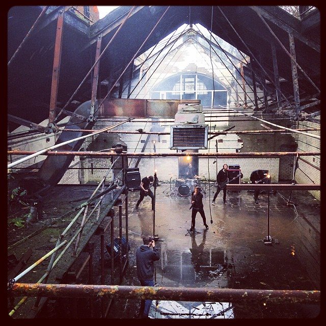

Oliver Daniel Posted December 17, 2014 Share Posted December 17, 2014 Don't be expecting an Andrew Reid review here! These are my quick thoughts.... An FS7 landed on my desk yesterday for a music video shoot. The camera is built like a rock and the grip is very comfortable. Shoulder mounting was pretty nifty. I had a brief go of shooting things round the office - yep, got it! We set up the band performance scene in a derelict swimming baths inside a lunatic asylum estate. The roof had fallen in, so plenty of light. 2 inches of water was on the surface and it was slippy. Ideal day for a new camera! ;) I started shooting with Canon FD L Series lenses, the mount I had was shit as it didn't click into place on the mount but it stayed on solid. No gulpy moments! I came into an issue straight away. When I turned the camera on, it would just freeze when loading the image. It was set to 4k 50fps, so to unfreeze I had to set it back to 25fps then back to 50fps. This started to become a major issue as every time the camera was switched off I would have to do this over and over again. Needs a fix fast!!! Another issue was the responsiveness of the buttons. It felt like the buttons didn't work properly combined with slow software. This was tedious because the menus are ridiculously complicated. To change from 4k to 1080p 180fps feels like a lifetime!! They definitely need to work on this!!! I filmed in Slog3, dynamic range is superb. You can also view footage with a LUT. I did in 709. Images looked great on the monitor, very clear and sharp. Peaking is very good too. I held the camera for around 25 angles of a 3:30min song. All handheld for a frantic feel. My right arm was dead by the end of the shoot, and my back was punished. Expected really. Shooting felt right though. ;) To get the most out of this camera, you need a lot of hard drive space. A 64gb card lasts 15 minutes at 4k 50fps. I filled 6 cards and dumped them throughout the day. As an owner, you will definitely need to factor in hard drives into the cost. You will need many. I really loved this little feature with a light meter on the display to tell you if parts of the image were too high in exposure or too low. The function of a histogram but different. Quite nifty. The footage looks great, very impressive. Very low noise. Clear and sharp. Dynamic range is fabulous. I can't release any images or footage due to confidentiality yet, but very pleased with the results. Will share on release. My overall thoughts on first use is that the camera is a great piece of kit, but let down by some shoddy firmware which ruins the user experience. Sony really need to update it fast. This is a serious production camera and it covers so many bases. You can shoot in lower bit rates at 1080 if you wish, but to use the best features - you need a crapload of hard drives. Once Sony sort out the firmware, this will be an excellent camera! tosvus, Cinegain, nahua and 1 other 4 Link to comment Share on other sites More sharing options...

Oliver Daniel Posted December 17, 2014 Author Share Posted December 17, 2014 Thanks Maxotics, there should be some behind the scenes stuff on the company Instagram account - we had a DJI Phantom too coming through the roof! That was the best shot of the day. I'm used to DSLR size cameras having also operated everything from a RED to BM Pocket, and the FS7 has a great balance for features and quality. It's just the firmware performance - simply unforgivable for a camera this price. It should just "work." This is Sony! It does make the FS700 a wimp in comparison. I've shot so much on that camera yet I've always disliked the image. It's horrendous. It does that slo-mo though that the music vids crave.... The video is out Jan 29th. :) Link to comment Share on other sites More sharing options...
