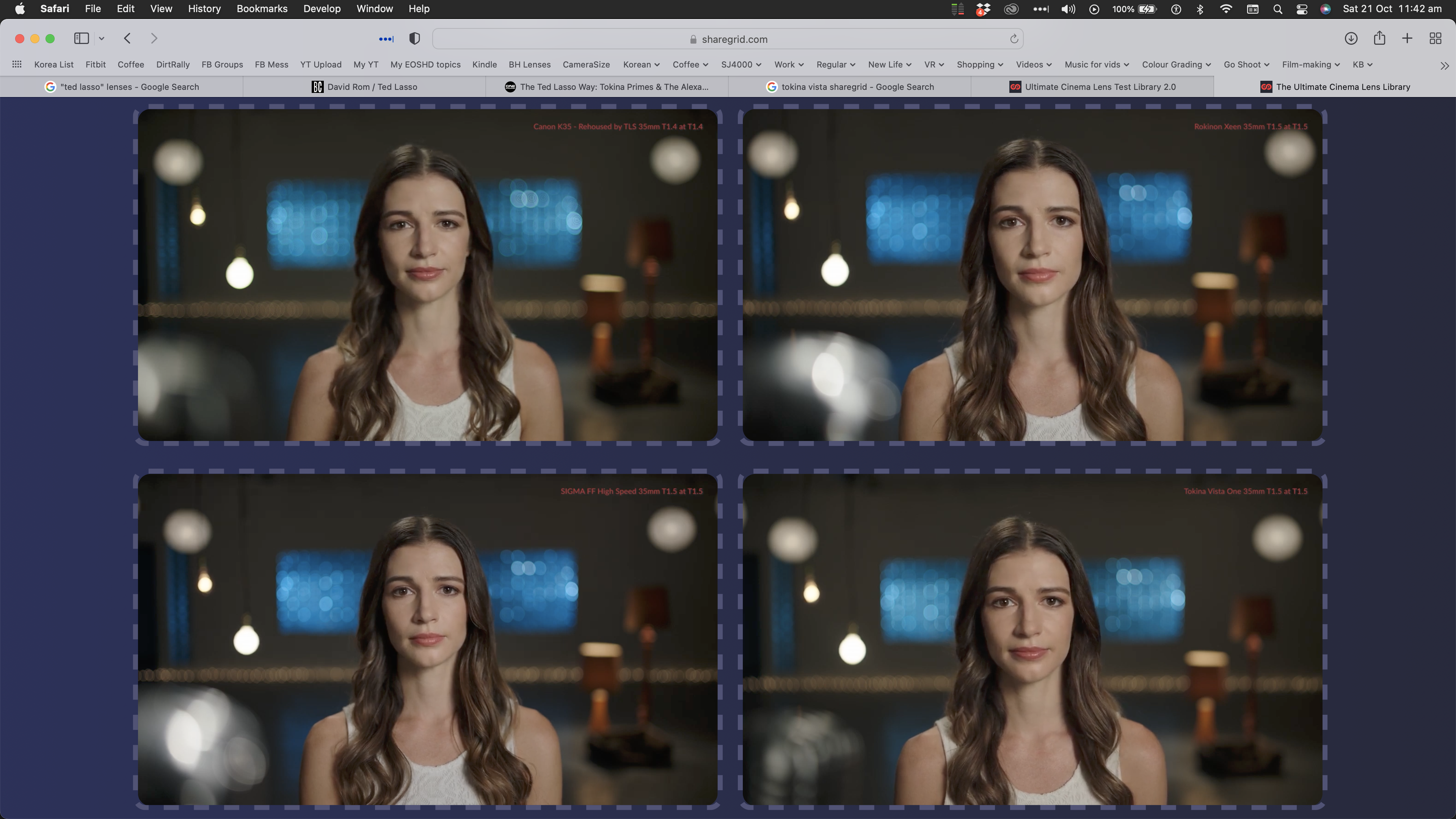

markr041 Posted October 20, 2023 Share Posted October 20, 2023 I wish people would give a link to a film, stream series, TV show, wedding video etc. they like the look of, then maybe explain what was used to achieve it ("1917" was one example). I will commit: I like the look of Ted Lasso. Colorful without the teal and yellow/orange, no hiding of backgrounds, high resolution (delivered 4K with no mist filter). But still a bit hyper reality. The best part was: subject isolation. This series was shot on an ARRI LF, which has a sensor bigger than FF. There was no super blurred backgrounds, just enough DOF for subject isolation and seeing what was around. Some close ups, of course. I also like the look of The Searchers - big widescreen and wide angle with seemingly infinite DOF. A look relevant to the setting, should not work for London! Not a controversial choice. In neither of these do I think "lens character" mattered, so much as focal length and aperture (and sensor size for the digital one). But maybe I missed the subtelties. Link to comment Share on other sites More sharing options...

kye Posted October 21, 2023 Share Posted October 21, 2023 12 hours ago, markr041 said: I wish people would give a link to a film, stream series, TV show, wedding video etc. they like the look of, then maybe explain what was used to achieve it ("1917" was one example). I will commit: I like the look of Ted Lasso. Colorful without the teal and yellow/orange, no hiding of backgrounds, high resolution (delivered 4K with no mist filter). But still a bit hyper reality. The best part was: subject isolation. This series was shot on an ARRI LF, which has a sensor bigger than FF. There was no super blurred backgrounds, just enough DOF for subject isolation and seeing what was around. Some close ups, of course. I also like the look of The Searchers - big widescreen and wide angle with seemingly infinite DOF. A look relevant to the setting, should not work for London! Not a controversial choice. In neither of these do I think "lens character" mattered, so much as focal length and aperture (and sensor size for the digital one). But maybe I missed the subtelties. Specific examples are useful. The Tokina Vista lenses on Ted Lasso are relatively neutral but still do have a bit of character. Here is a comparison of them vs the ARRI Signatures nearest focal lengths and apertures. (Click to view image in proper resolution) I see differences in colour cast, contrast, background separation, and even aspect ratio perhaps? All lenses exhibit SOME character, although in the context of cinema, rather than TV, these lenses are relatively neutral. One thing to be aware of is how quickly we adapt to a look. Our eyes and visual system is incredibly adaptable, so much so that a significant element in colour grading is the design of the colour grading suite and workflows and processes so that your eyes continually have a neutral reference and so they don't gradually drift over the course of a project. With lenses etc there is no neutral reference. One thing that is interesting to look at is the VFX breakdown videos from shows like The Mandalorian where they show the process of making the 3D objects look as real as possible, then applying the same lens characteristics as the production used, which often has a significant effect aesthetically. Lens character is a tool that can be used to reinforce or undermine the creative intent of the film. It won't make or break your production, but it's available to you so why not use it? Link to comment Share on other sites More sharing options...
