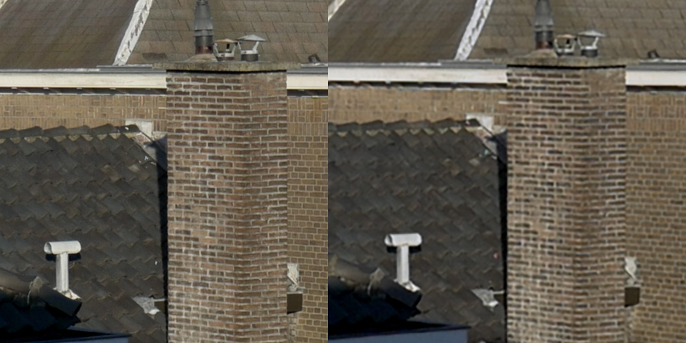

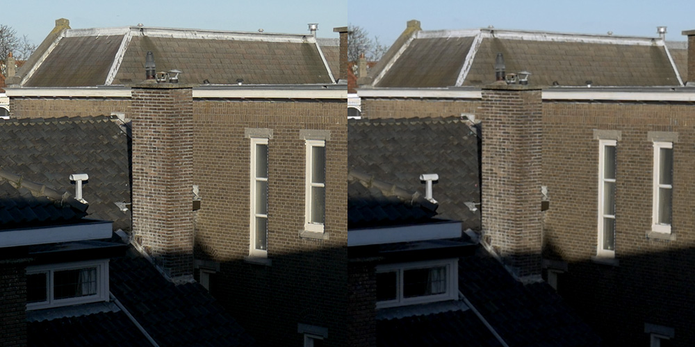

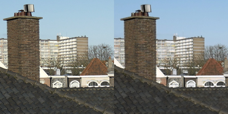

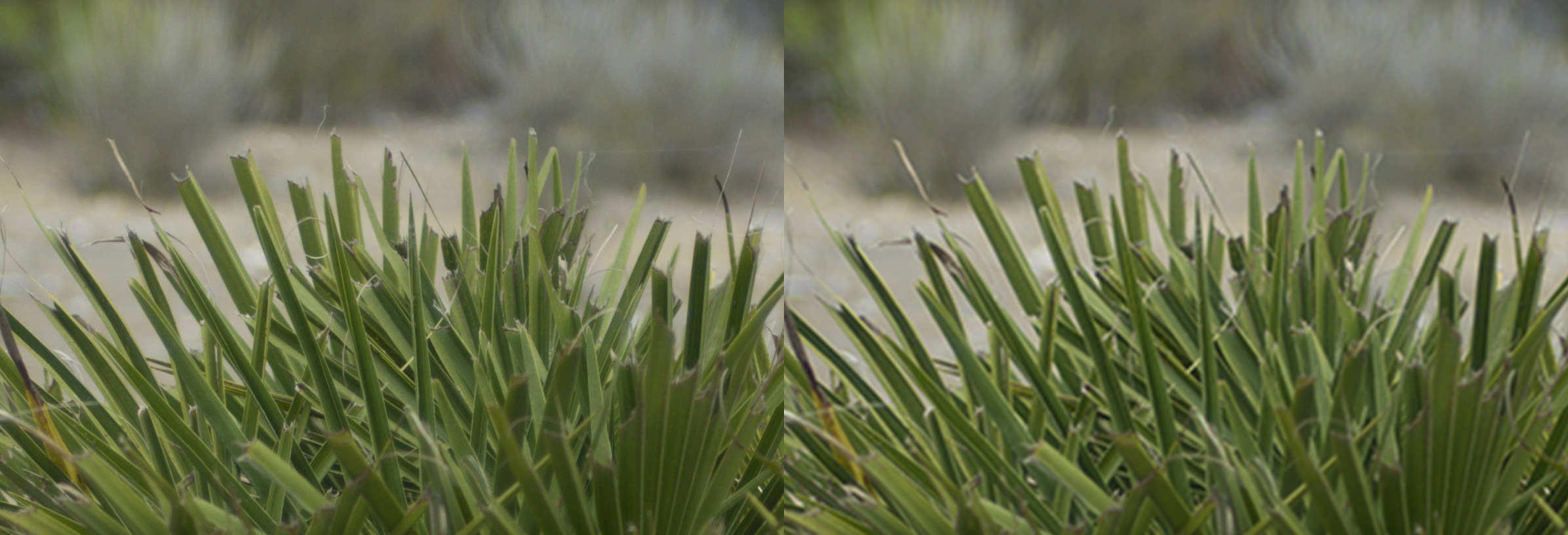

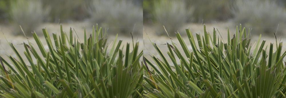

Julian Posted December 31, 2014 Share Posted December 31, 2014 Quick unscientific test (no tripod, not the same focal lenght, because of extra 4K cropfactor with GH4). Shot with GH4 and 14-42mm f/3.5-5.6 II kit lens that resolves 7 megapixels according to DxO Mark. Lens set at f/4 - pretty much wide open.All 100% crops. 100MBPS UHD and 100MBPS 1080p. Same settings. Cine-D sharpness -5.4K at 100% vs 1080p upscaled to 4K 4K downscaled to 1080p vs 1080p at 100%4K downscaled to 1080p vs 1080p @ 100% Link to comment Share on other sites More sharing options...
