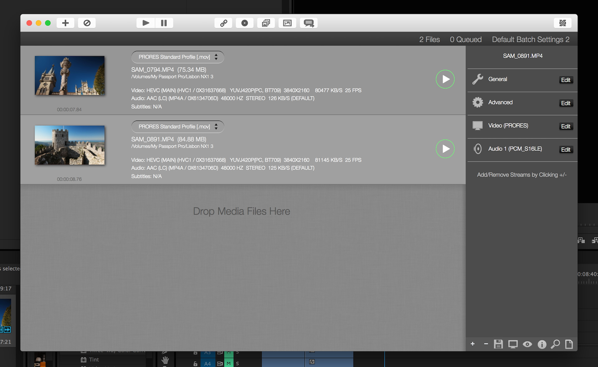

Administrators Andrew Reid Posted December 30, 2014 Administrators Share Posted December 30, 2014 One thing the Samsung NX1 shares in common with the much more expensive Canon 1D C is that both produce files which are tricky (or impossible) to edit natively on most current hardware and software. The 1D C’s MJPEG is sluggish to edit on anything less than a powerhouse of a machine and the H.265 from the NX1 also needs transcoding to ProRes 4K which is editable even on a reasonably specced Macbook Pro.iFFMPEG replaces Wondershare Video Converter as my tool of choice for this.Thanks for the tip off GMaximus!Read the full article Link to comment Share on other sites More sharing options...

neosushi Posted December 31, 2014 Share Posted December 31, 2014 So funny Andrew, I just bought this app today and was about to make a topic on EOSHD forum when I saw your post I just shot a commercial (france) yesterday with the NX1, and was quite disappointed with wondershare (tons of banding). IFFMPEG is a huge improvement in terms of quality. And I also agree that when you don't want to bother with command lines 17 (21€ in France) is a bargain.Now I don't know if you noticed, but some settings needs a restart of the app to be applied - although the app doesn't warn you -. Such as changing the destination folder for example.Cheers from France! MrTony 1 Link to comment Share on other sites More sharing options...

neosushi Posted December 31, 2014 Share Posted December 31, 2014 My pleasure !Also, I found myself struggling a little bit with the Prores quality settings. They re split in many different menus :/One setting that I am testing right now is the macroblocking bit rate. I feel like this is what hurts the NX1 the most during compression. I'll let you know if it works for me !Also I m kind of surprised at the speed. I don't find the app substantially slower than wondershare for example. Regarding contrasts settings do you know if it is possible to roll it down (like wondershare) ? Thanks again ! Link to comment Share on other sites More sharing options...
Administrators Andrew Reid Posted December 31, 2014 Author Administrators Share Posted December 31, 2014 Strange, I found it faster!What system are you using?Contrast, not sure, but if it drops any further I don't think it'll reveal any more usable info in the lows / blacks, just more blocking. Will be interested to see what your macroblocking bit rate changes do. You're right that is a weakness of the NX1, it does compress the shit out of the shadows Link to comment Share on other sites More sharing options...
Administrators Andrew Reid Posted December 31, 2014 Author Administrators Share Posted December 31, 2014 Just double checked the conversion rates. Wondershare took 28 seconds to convert a 5 second long test clip from the NX1 to ProRes LT. 7 seconds of that were at the start whilst it said "Waiting"iFFMPEG for the same 5 second H.265 clip to ProRes LT took 13 seconds. Even if you subtract the 7 seconds from the Wondershare time it's still nearly double the time.That's for one clip... might be quicker with multiple clips as Wondershare can use 4 cores, one clip per core so simultaneous conversions on the go.iFFMPEG is doing a 1 pass encoding, not sure what Wondershare does but iFFMPEG produces the nicer file so it's all moot. MrTony 1 Link to comment Share on other sites More sharing options...
Administrators Andrew Reid Posted December 31, 2014 Author Administrators Share Posted December 31, 2014 Another finding... with the 1D C MJPEG 4K LOG footage Wondershare applies its own contrast setting, slightly crushing the blacks - less severe than with the NX1 but still a problem.iFFMPEG is a real find, thanks a lot GMaximus. Link to comment Share on other sites More sharing options...
