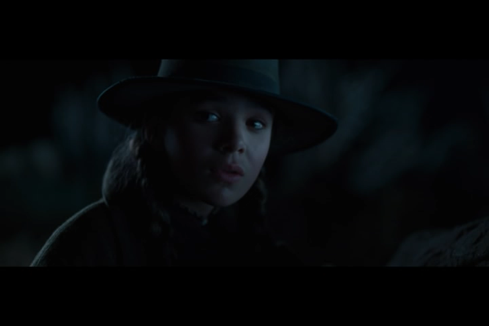

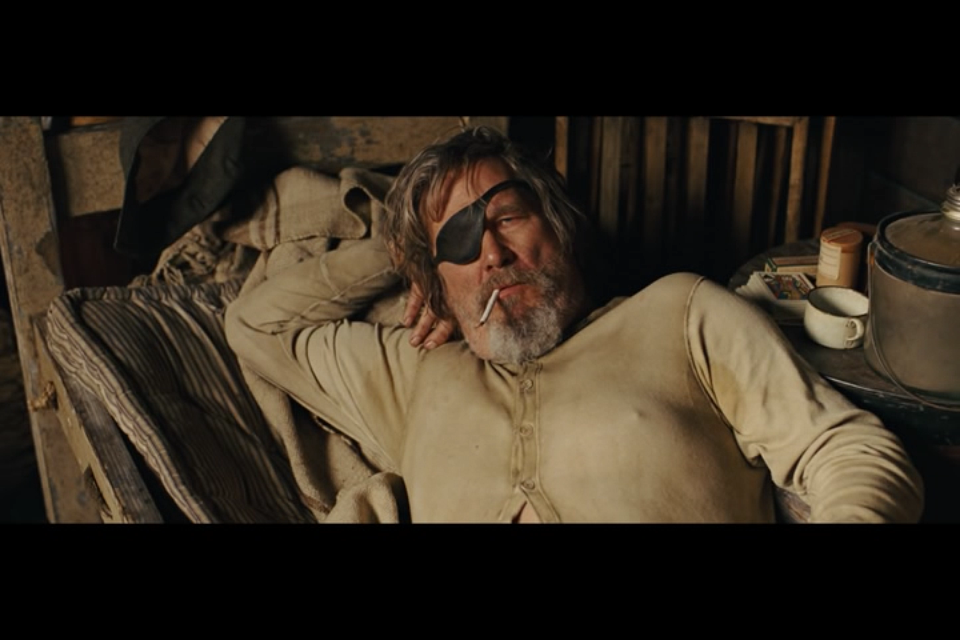

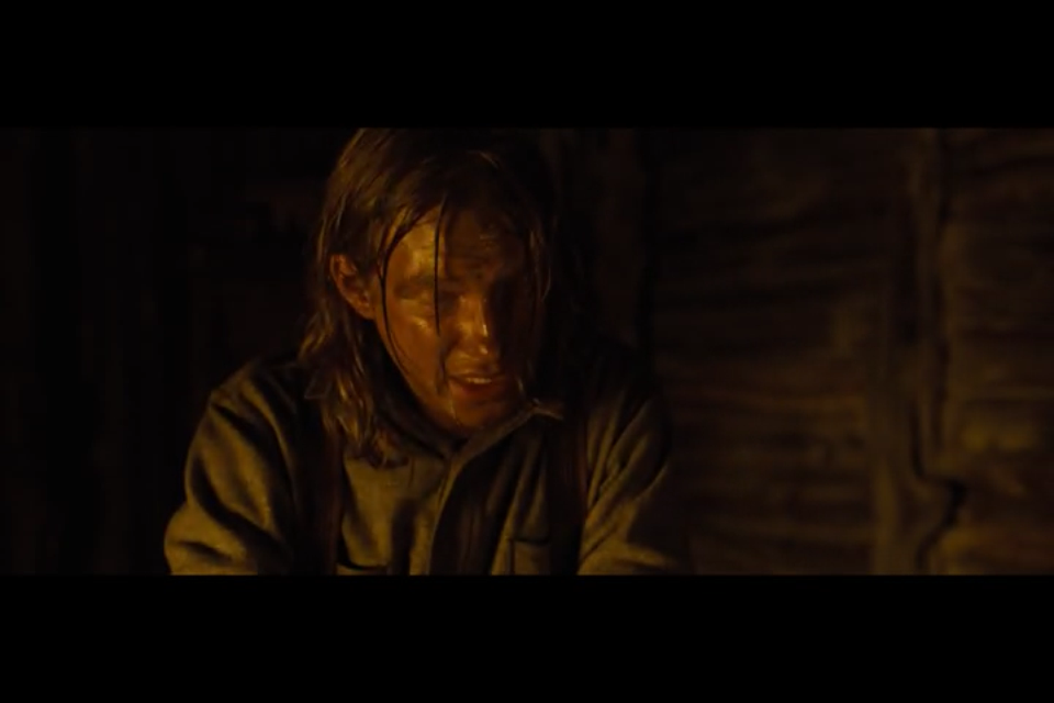

fuzzynormal Posted December 31, 2014 Author Share Posted December 31, 2014 Why not post a few screenshots of examples of what you feel are good skin tones for feedback?That's the thing. I'm not terribly particular about it. I'm perfectly comfortable making someone look blue or orange if I feel it helps tell a story and assists ambience. I'm all about context of the narrative. My color grading can get pretty wild, so I'm curious why others are such sticklers for what they imagine is an ideal.If/when a client wants something clean, I keep it clean --but no matter what camera I use they all offer images that never stray too far to create something nice, regardless. I very rarely let a shot go through post without a tweak on it. Link to comment Share on other sites More sharing options...
jcs Posted December 31, 2014 Share Posted December 31, 2014 For narrative, for sure anything goes. If you worked on those films in your post above, what camera and lighting did you use? If those aren't your work, perhaps post some examples from vimeo.com/path88/videos?Here's a GH4 example which I feel shows good skin tones (Natural profile, Panasonic 12-35 F2.8 lens), overcast with indirect reflected brown light: 5D3 RAW, 24-105 F4L, LCW Fader ND v1, overcast daylight, processed with ACR+AE (color shifts during playback courtesy of ACR): A7S, stock PP6, Sony 18200 lens, LCW Fader ND v1, overcast daylight (poster image; different lenses, light throughout video): In the first video, the skin looks good with a warm/orange tint. In the second video, skin looks pinker (more magenta; higher color temp source light, though it sometimes swings to green due to ACR), and to my eye (and the actor's) natural and pleasing. The final video (poster) looks good on it's own, but when compared to the 5D3 and GH4 looks greener though still pleasing (during playback there's magenta bias, green bias, yellow bias, etc.). Now viewing these images on different monitors will make some look better and some look worse, depending on which way out of calibration they go. For example, on a monitor with too much green, the middle video (still frame) will look less magenta but still good, however the bottom video (still frame) will look too green and less pleasing.I'm still learning and appreciate feedback from every angle. It's art so some will like and some won't. What is helpful is understanding why. Link to comment Share on other sites More sharing options...

fuzzynormal Posted December 31, 2014 Author Share Posted December 31, 2014 If those aren't your work, perhaps post some examples from vimeo.com/path88/videos?No, not my work, just examples of color grading that make "ideal skin tone" seem somewhat irrelevant. My point is this: I'm not looking for a camera that offers the best skin tone. I'm saying all modern cameras are pretty good and with color grading you can pull it into your preference anyway.If you agree with that assertion, then why worry so much about skin tone to begin with?If you disagree with that premise I'm genuinely interested why. I accept that I may be off the mark here. As for my videos, there's nothing in there where I'm upset with skin tone color. Jonesy Jones and Hitfabryk 2 Link to comment Share on other sites More sharing options...

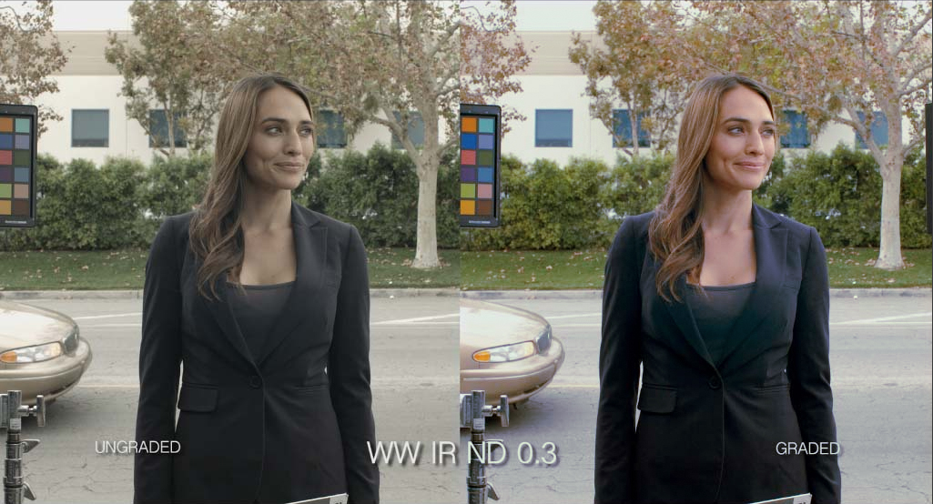

jcs Posted December 31, 2014 Share Posted December 31, 2014 toxotis70- http://www.4kshooters.net/2014/11/14/crazy-un-scientific-fatal-four-way-shootout-canon-5d-mark-iii-vs-gh4-vs-sony-a7s-vs-canon-eos-c100/ , https://vimeo.com/72566458. There's more out there...Tim- that's the pattern I found with lots of research too. Alexa > Dragon/Epic > F55.Here Shane tests the Blackmagic URSA: http://www.hurlbutvisuals.com/blog/2014/12/blackmagic-4k-ursa-tests-part-1/. In the IR tests, actress Eli Jane's skin tones look good, however the background sky, specular highlights, and the white lines in the parking lot are all too magenta: A quick try at fixing the background while preserving the skin tones:Interestingly, while the skin tones changed (global changes: didn't use any masking), they look more natural for the lighting conditions. Link to comment Share on other sites More sharing options...
