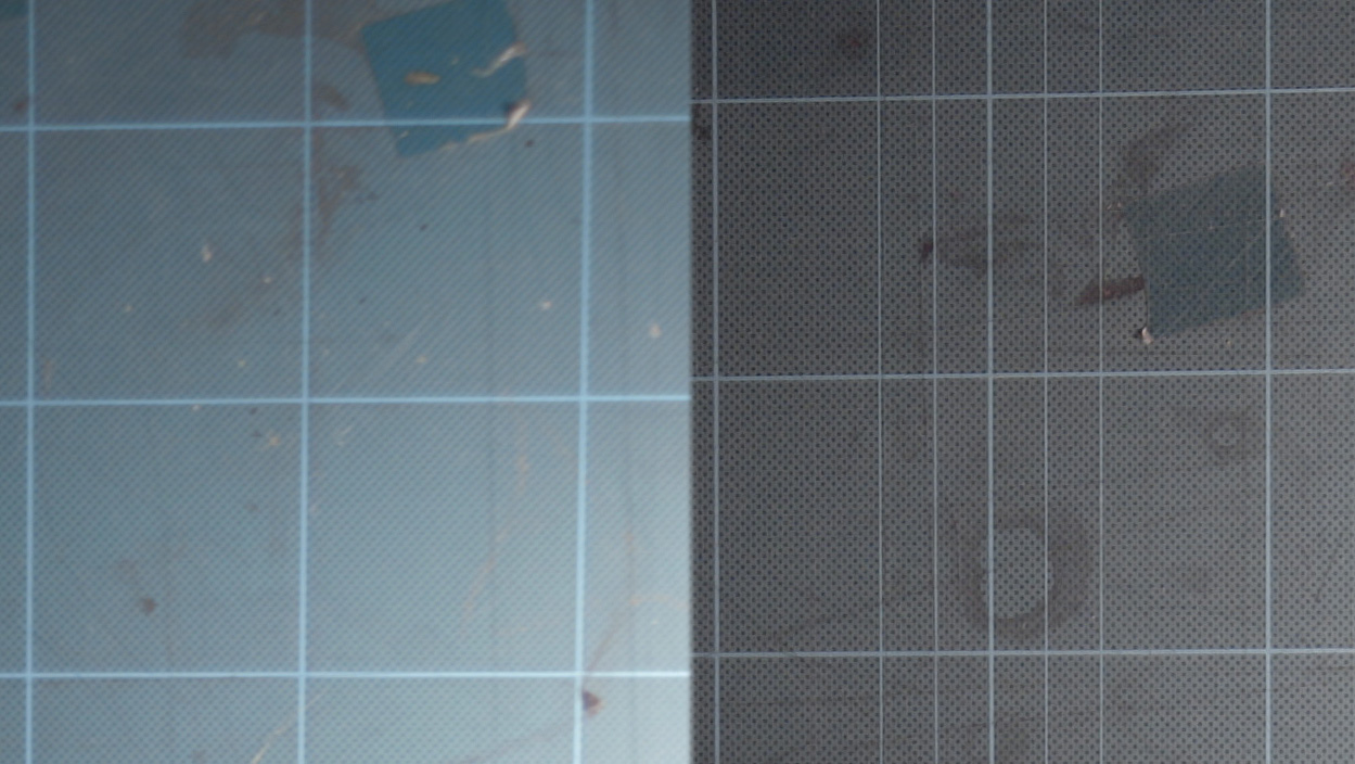

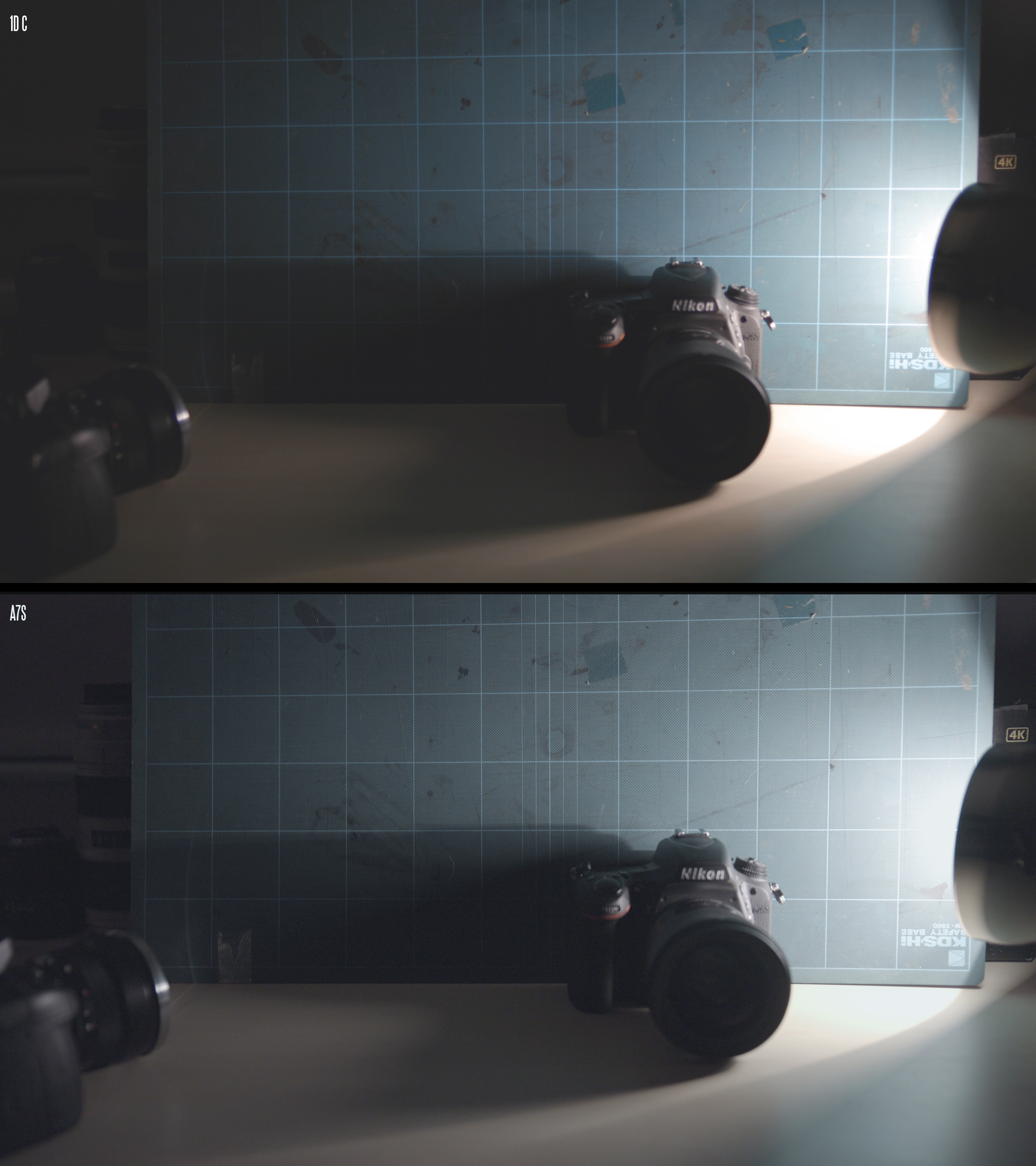

Administrators Andrew Reid Posted December 31, 2014 Administrators Share Posted December 31, 2014 A7S + Shogun 4K in S-LOG exposed for highlights.1D C the same, but 4K internal (Canon LOG).1D C seems to have a dynamic range advantage. Maybe of 2 stops more usable information.I don't understand why the A7S is dumping so much data in the shadows. Big holes in it and lots of noise.Blacks should not be crushed like that in a LOG profile!When you have a shot without a really hot area (like a window or light you want to expose for) you MUST bring S-LOG 2 up away from those lows to get a good image, even if it means putting the ISO to crazy levels.The 1D C is different. It's applying ISO at an analogue level, and ISO 200 seems to have the same dynamic range as the other ISOs.A7S needs to be at ISO 3200 as we know.Not trying to justify my purchase here, just giving you some of my research early ahead of the blog post for commenting on. Will add depth to the final article to hear your thoughts.But it seems 1D C is looking like a real bargain if the price keeps dropping... Christina Ava and jasonmillard81 2 Link to comment Share on other sites More sharing options...
vas Posted December 31, 2014 Share Posted December 31, 2014 I'm not sure if the focus is slightly of on the 1DC but the sharpness and detail the A7S is picking up is really good compared to the 1DC. Link to comment Share on other sites More sharing options...
Administrators Andrew Reid Posted December 31, 2014 Author Administrators Share Posted December 31, 2014 Focus is off a hair and different lens used so ignore that. Was purely concentrating on the spread of light from the highlight to the shadows.But that blow-up reveals something else interesting...The contrast of the A7S shot is much higher. You seem to have dark dots and the sellotape tab doesn't look right, kinda muddy and same colour as the rest of the board.The 1D C looks like it contains 10x the colour and shades to the A7S shot. Link to comment Share on other sites More sharing options...

Guest Ebrahim Saadawi Posted December 31, 2014 Share Posted December 31, 2014 I would think the a7s has more dynamic range due to cleaner shadows AND better highlight recovery, I mean Sony marketed it as 15 stops of DR at some point... so seeing it that far behind the 1dc/1dx sensor is quite shocking. Why are the shadows so noisy? I think there's something wrong here Link to comment Share on other sites More sharing options...

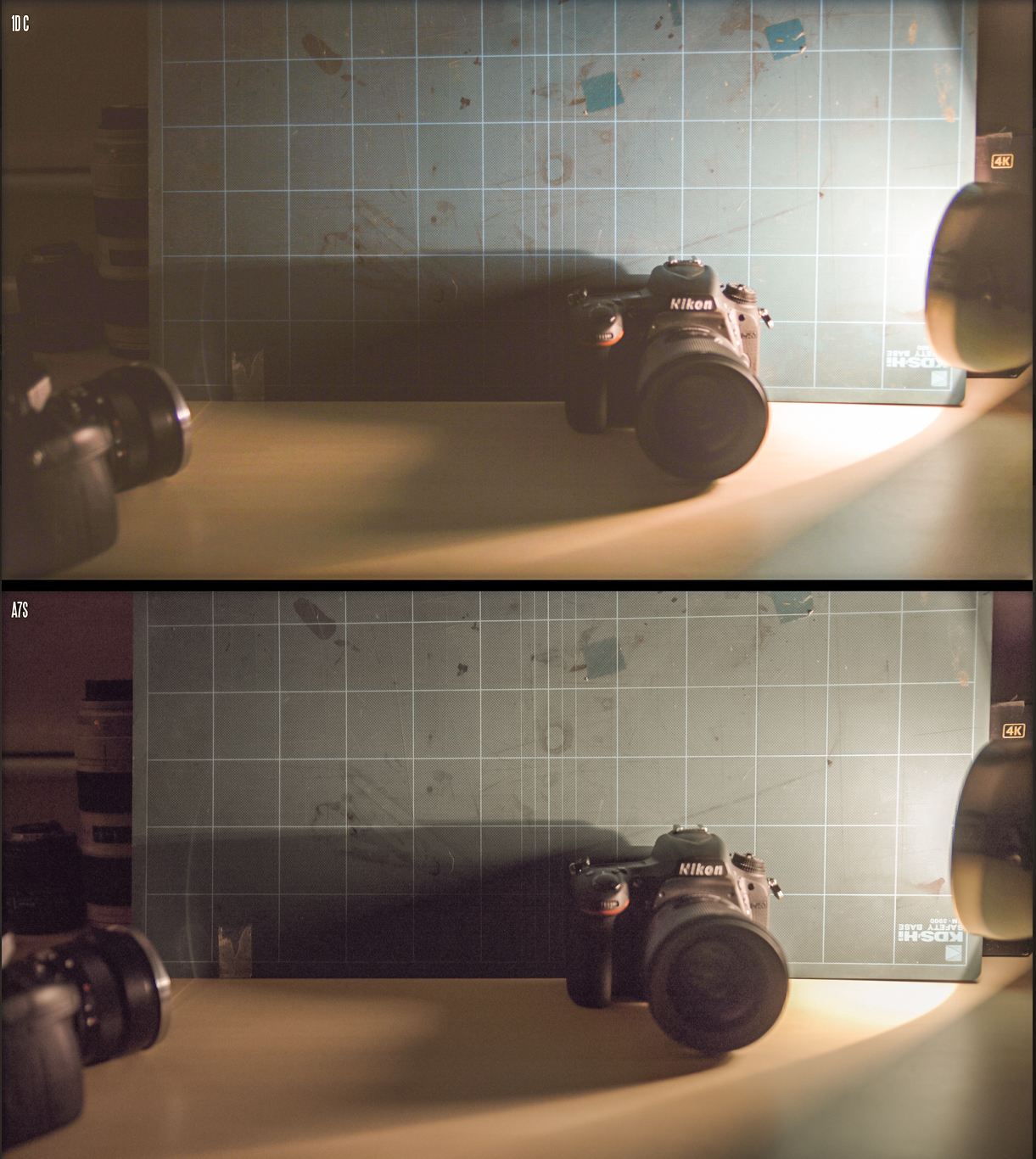

jcs Posted December 31, 2014 Share Posted December 31, 2014 A quick test in PS with ACR appears to show more DR with the A7S. More detail in the shadows and more recovery possible in the highlights. The A7S had more color noise, and is more magenta in the shadows (trying to correct overall color including shadows changed the board color too much (too much work to fix for this quick test)): Link to comment Share on other sites More sharing options...
wjkotze Posted December 31, 2014 Share Posted December 31, 2014 The A7s have significantly more shadow detail, albeit it with more noise. With Neat Video the A7s should comfortably match or exceed the the usable dynamic range of the 1dc. The lack of detail in the 1dc shadows might be an indication of aggressive internal noise reduction. Link to comment Share on other sites More sharing options...

bezerk55 Posted December 31, 2014 Share Posted December 31, 2014 As per the thread jcs linked to, I applied the levels fix to the a7s portion of the image. I also pushed the a7s white balance closer to that of the 1dc. The 1dc image remains untouched. The comparison would be better if the levels fix was applied to the prores and the WB applied in camera, but even just working with the jpg I think the a7s is the better image (more detail, better DR, less banding). Colours could be better but I'm guessing a7s was using s-gamut as opposed to cinema or pro colour.Black level on the 1dc image seems to be 32(?)The apperance of noise on the a7s image is reduced somewhat after the levels and WB fixes. And regarding noise, a comment from the same thread jcs linked:One of the things I have noticed about all the Sony cameras I have had in recent years, (AX100, RX10, FS100 and FS700) is that they apply noise reduction into the CODEC processing circuit. HDMI does not have this noise reduction because it's not passing through the H.264 encoder (and noise reducer)This is a good thing. You can apply your amount of noise reduction to your liking in post. The less processed my HDMI is, the happier I am. (In most cases) jcs 1 Link to comment Share on other sites More sharing options...

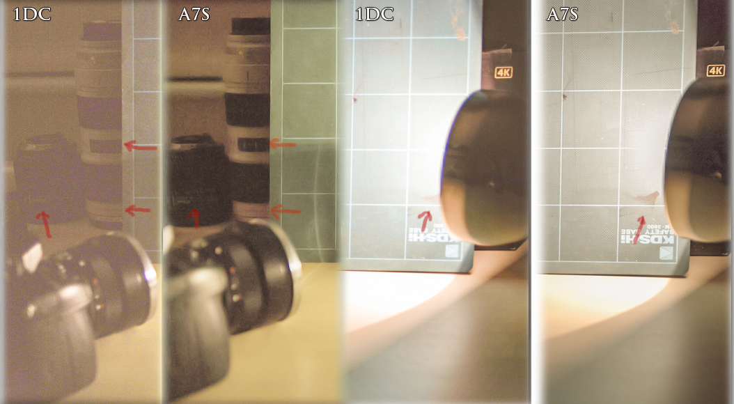

jcs Posted December 31, 2014 Share Posted December 31, 2014 Hey Andrew, I'm not seeing a 1DC DR advantage in your test image:I've marked a few areas where to my eye there's a lot more detail/SNR in the A7S shot vs. the 1DC. There's also purple chromatic aberration on the edge of the light and on the specular edge of the silver camera ring for the 1DC but not the A7S. I'm sure the 1DC is a better overall camera, especially skin tones, however it appears the A7S has more usable DR. Link to comment Share on other sites More sharing options...
Administrators Andrew Reid Posted December 31, 2014 Author Administrators Share Posted December 31, 2014 I'm not sure how you've graded that, it doesn't look like what I get. Might not be your fault, you are grading a heavily web compressed JPEG after all.I get a stop more detail in the highlight and at least 1-2 stops cleaner shadows...Top A7S 4K S-LOG and bottom 1D C MJPEG.(Click to enlarge to see the noise grain in the shadows and on table surface)That's what I mean by 'usable'. You have to crush the blacks on the A7S to get rid of the noise in the shadows. On the 1D C you can leave the shadows 'as-is'.They both have a 0% curve in Film Convert on to try and exceed the maximum dynamic range that's usable... to show as an example. No artistic merit I know it looks awful on both!S-LOG 2 needs fixing for 4K it isn't working right.And how is purple chromatic aberration the fault of the camera? It's a lens thing anyway. Link to comment Share on other sites More sharing options...
