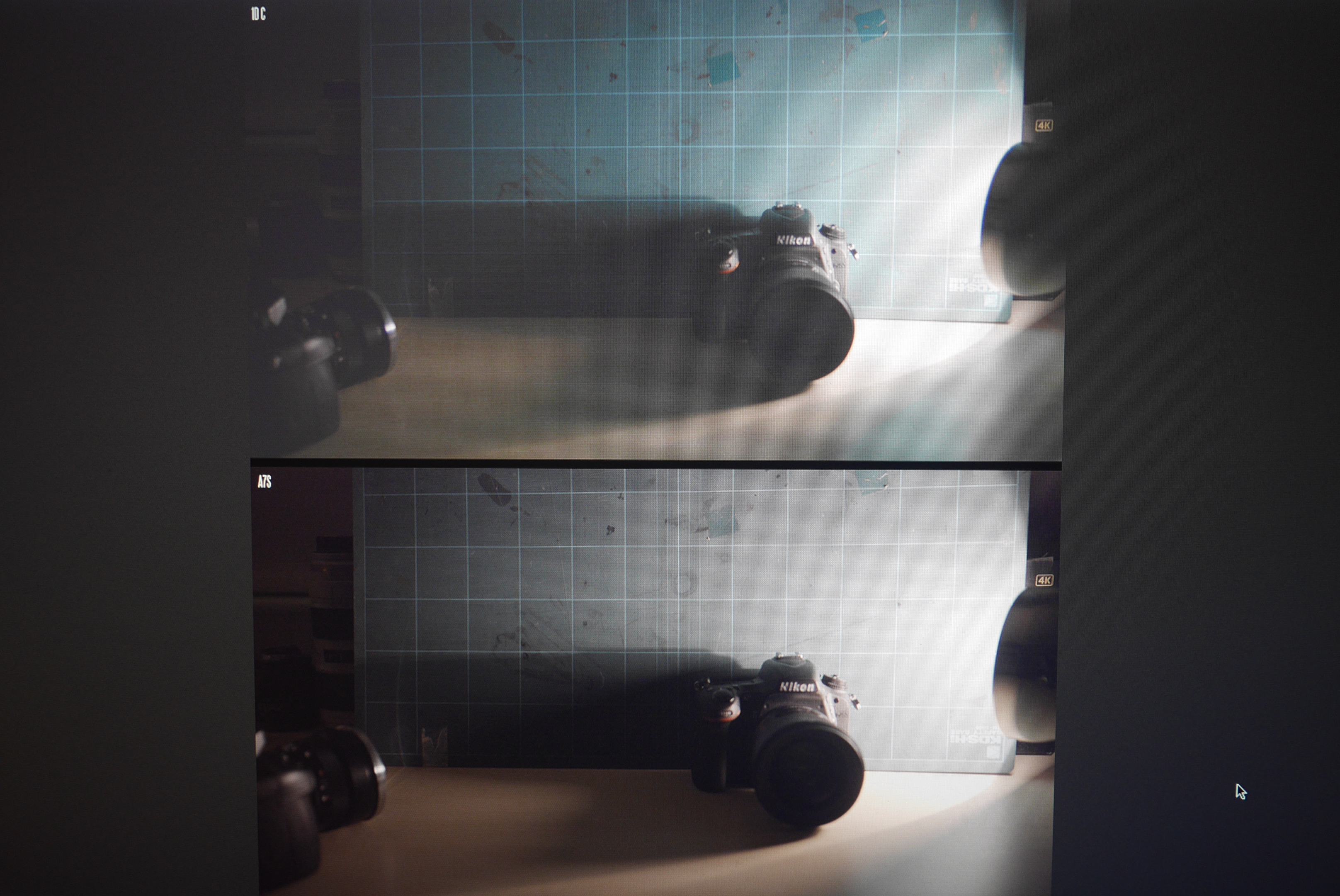

Inazuma Posted January 7, 2015 Share Posted January 7, 2015 The shadows on that 1DC image just look more crushed to me than the A7S'. I'm not seeing any dynamic range advantage. Maybe different monitor gamma? Link to comment Share on other sites More sharing options...
Administrators Andrew Reid Posted January 7, 2015 Author Administrators Share Posted January 7, 2015 The shadows on that 1DC image just look more crushed to me than the A7S'. I'm not seeing any dynamic range advantage. Maybe different monitor gamma?Yes that sounds likely. Any way to show visually what you're seeing on your screen? Take a photo of your display perhaps? Link to comment Share on other sites More sharing options...
Administrators Andrew Reid Posted January 7, 2015 Author Administrators Share Posted January 7, 2015 I'm not seeing any dynamic range advantage.The light rope highlights are burnt in one and not the other. C'mon now get a grip. Link to comment Share on other sites More sharing options...

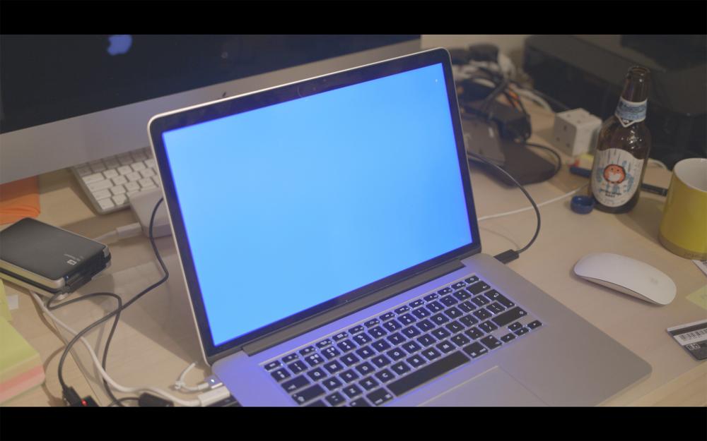

toxotis70 Posted January 7, 2015 Share Posted January 7, 2015 I dont have any yellow /green tint in my videos.i always shoot slog2-sgamut and then color grading with right lut in resolve.... Maybe you can try that too. blue color clipping is because of wrong white balance, if you put 5000 kelvin or more, there is no blue clipping Link to comment Share on other sites More sharing options...
Inazuma Posted January 7, 2015 Share Posted January 7, 2015 Yes that sounds likely. Any way to show visually what you're seeing on your screen? Take a photo of your display perhaps?Not sure if you will be able to see this here either (photo of the photo attached). But what I'm talking about is that I can see clear tonal differences between the lenses on the left and the wall. I can see more of the sheen on the lens of the camera in the centre. I can see more tonality on the camera at the front on left. It looks more 3D where the on the 1DC image it looks more flat because of the crushed shadows. If I copy and paste the image into Photoshop and increase the contrast in the shadows of the 1DC image to get that same detail out, the image reveals a lot of banding and chroma noise. I will concede that there is slightly more range in the highlights of the 1DC image, but it really is slight.But anyway, I guess it doesn't matter to me much since I am not in the market for either camera right now. Just thought I'd point out that I can see differences that don't seem to match the OP's findings. Link to comment Share on other sites More sharing options...
jcs Posted January 7, 2015 Share Posted January 7, 2015 I've seen the yellow/green skin in practically every a7s video outthere, it's not easy to correct, but I can do it. This issue + the faulty blue clipping gives the 1DCa clear advantage in colour science/rendition. If Canon = red bias (R), and Sony = yellow bias (R+G), then taking the difference D = Sony - Canon, D = (R+G) - R, D = G: the difference simplifies to a green bias. The green bias with Sony is mostly with SGamut color mode. Cinema color mode has less green, Pro has even less. I can now fairly well match 5D3 RAW with the A7S skin tones with custom tweaked profiles, never using SGamut. While SGamut make work OK if corrected in post, I suspect without the proper color science workflow in post, when skin tones are corrected to look less green, the background may end up magenta, etc. Some lights have color spikes/bias, especially low CRI LED, FL and CFL, adding to the challenge. More info here: http://www.eoshd.com/comments/topic/7762-lighting-white-balance-and-skin-tones/ Link to comment Share on other sites More sharing options...

Administrators Andrew Reid Posted January 8, 2015 Author Administrators Share Posted January 8, 2015 That S-Gamut chart applies to the F35 and F65 top end only not the FS7 or A7S.And in Inazuma's reproduction of my screen grab he seems to think more contrast = less crushed blacks and a flatter image = more crushed blacks when it is the opposite, so make your own view of that people, that's all. Link to comment Share on other sites More sharing options...

AccordingToMe Posted January 8, 2015 Share Posted January 8, 2015 …on the 1DC image it looks more flat because of the crushed shadows.An image can't be more flat with crushed shadows. When people say crushed shadows they mean "crushed down", as in turning dark gray areas completely black.Crushing the shadows makes an image more contrasty and punchy, often with the purpose of removing the dark, noisy part of the image by sending it to black. Link to comment Share on other sites More sharing options...
Inazuma Posted January 8, 2015 Share Posted January 8, 2015 That S-Gamut chart applies to the F35 and F65 top end only not the FS7 or A7S.And in Inazuma's reproduction of my screen grab he seems to think more contrast = less crushed blacks and a flatter image = more crushed blacks when it is the opposite, so make your own view of that people, that's all.Are you trying to discredit me because I'm unfamiliar with the terminology? That's really fine. I never claimed to be an expert of any kind. I'm just pointing out what I see. My professional knowledge doesn't play into that. jase 1 Link to comment Share on other sites More sharing options...
