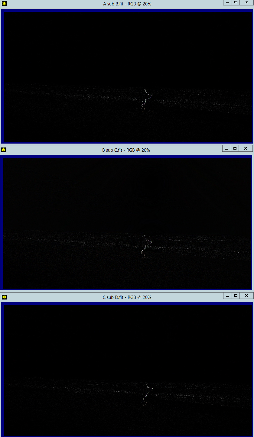

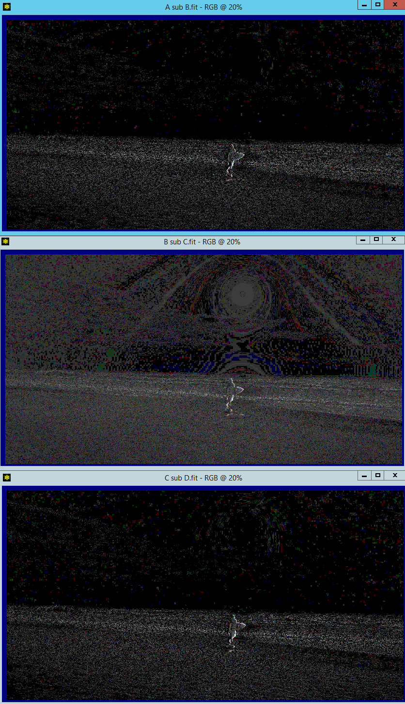

GXAlan Posted January 18, 2015 Share Posted January 18, 2015 You know, I didn't even put flicker and exposure drift together -- I just thought it was a flicker and had imagined the exposure drift as being something different in my mind. There's definitely exposure drift.I ran some numbers on the still frames from ProRes clips exported as 16-bit TIFFs.Two bright frames (L / R / G / B average + SD). The total range is 0-65535A. 48059 + 17964 / 44718+17233 / 46517+17824 / 47545+18283B. 48059 + 17967 / 44718+17235 / 46517+17824 / 47545+18285So it's pretty close. Then you get to the flicker. First, the brightness drops by 1.18%C. 47288 + 17952 / 43497+17231 / 45746+17810 / 47031+18252 (total range is 0-65535)Then the red frame gets messed up with the range from 257-65535 instead of 0-65535D. 47288 + 17951 / 43974+17233 / 45746+17810 / 47031+18252The error in the lower limit of the red channel suggests that there may be an encoding error. I'm going to see if I can transcode directly to TIFFs instead of ProRes and will follow-up. Link to comment Share on other sites More sharing options...
GXAlan Posted January 18, 2015 Share Posted January 18, 2015 Ok, exporting the HEVC to TIFF directly, skipping the ProRes. 1) All channels DO show 0-65535 range. So ProRes is making it worse.2) The flicker is visible on source HEVC as well. Here are the median values L/R/G/B (i'm skipping the standard deviation) TIFF A 48059 / 44461 / 46260 / 47545ProRz A 48059 / 44718 / 46517 / 47545 TIFF B 48059 / 44461 / 46260 / 47545ProRz B 48059 / 44718 / 46517 / 47545(overall brightness is the same, but it is slightly higher on ProRes. Would be one tick in 8-bit 0-255 scale) TIFF C 47288 / 43690 / 45489 / 46774 ProRz C 47288 / 43497 / 45746 / 47031TIFF D 47288 / 43690 / 45489 / 46744ProRz D 47288 / 43974 / 45746 / 47031So compared to ProRes, the overall brightness drops the same 1.18%. However compared the ProRes is a bit brighter in green/blue and darker in red.I compared the frames and then did an stretched the histogram. So there you go. agolex 1 Link to comment Share on other sites More sharing options...

GXAlan Posted January 18, 2015 Share Posted January 18, 2015 ** Since I cannot edit the earlier post. The first set of 3 images are EXAGGERATED with a stretched histogram to highlight the differences visually. The second set of 3 images are the true linear difference from the subtraction) *** But TBH, with exposure drift I was imagining more of the auto-exposure effect -- we should probably call it "flicker" instead of exposure drift so people understand that it's a tiny difference. I sometimes think of flicker as shutter issue.What's interesting is that you're looking at only 3 points of brightness a 0-255 scale which is TINY. The Samsung is probably running 12-bit ADC in video mode. 0-4096, So it's probably 48 point difference in 12-bit.Given the average scene brightness in frames A/B, the image C/D are only darker by 0.02 eV. I don't remember what the electronic shutter is like but it's possible that the 1.2% variation in the e-shutter is enough to cause this problem?The other possibility is that most CMOS sensors have black pixels which are used to automatically calibrate the black level. As the sensor heats up (i.e. light on a black surface") it potentially may convince the sensor that it's too hot and then it recalibrates itself on the fly. If the sensor and CPU are fast enough that it's recalibrating in real-time for every frame, maybe when shooting into the sun, it heats up the sensor just a little bit.If Samsung does a true exposure lock, it probably won't flicker but over a 30 minute recording, you may end up with more noise or the opposite where it slowly gets brighter as the sensor heats up. We see this with the 5D Mark II and extended shooting -- it gets noisier. If this is the problem, I'd probably tell Samsung to give owners the power to make the customization. You could do a moving average where it waits for a number of frames to show increased heat before adjusting the black level or Samsung could do a more gradual ramp up/down such that if it detected increased heat, it would +1 the compensation each frame.Read noise and Thermal noise on the Samsung is pretty good though. ISO 1600 NX1Two 1/8000 bias frames: StdDev 11.4Two 30 second dark frames: StdDev of 22.3ISO1600 A7RTwo 1/8000 bias frames: Median difference of 0 on a 16-bit scale, StdDev 5.7Two 30 second dark frames: Median difference of 0, StdDev 13.029Sony's noise increases 2.29x. Samsung's increases 1.96x only (even though there's more inherent noise at baseline -- it's APS-C and more densely packed?)From a read-noise perspective, NX1 is pretty good too.NX1ISO100 3.14 e-/pixel (SD 7.9 e-)ISO1600 1.68 e-/pixel (SD 4.0 e-)A7RISO100 2.73 e-/pixel (SD 81.4 e-)ISO1600 2.19e-/pixel (SD 4.7 e-) My gut says that when the inherent noise is so low, thermal noise (from light) may be higher than we're used to dealing with... I sent an email to Samsung. Link to comment Share on other sites More sharing options...
