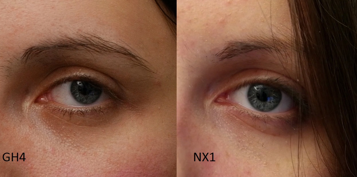

Beritar Posted February 4, 2015 Share Posted February 4, 2015 The two last firmwares have improved HD video, DOF, 4k DCI (not tested, if anyone can confirm ?) and fixed some bugs.UHD is great in good light, better than GH4. But we really need control over noise reduction on low ISO. In low light or in dark areas of the image, some details are washed away, the GH4 is noiser but retain really more details. Link to comment Share on other sites More sharing options...
