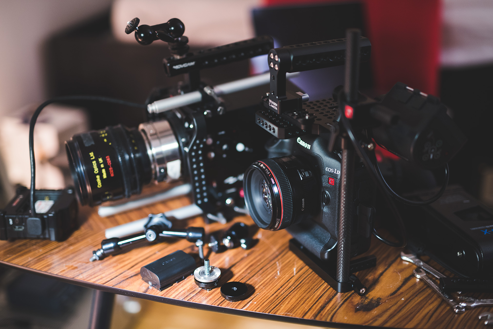

Here she is not quite rigged up but the 1D C is ready to provide some competition :)
Very impressed with the changes they've made over the old Mini so far. 4K image looks amazing and the camera is 10x more responsive. Much nicer feel to the all important command joystick and record buttons too. Start up time has been more than halved, down to 20 secs.
