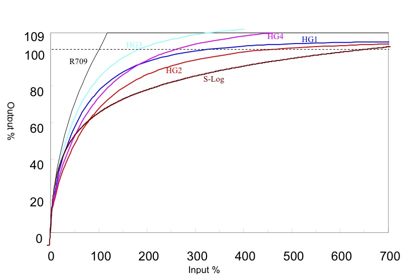

jcs Posted January 12, 2015 Share Posted January 12, 2015 Hey Rich, -3,0,-3 is how I had set up Neutral with PP off (unless it's the default?). It appears to be a Rec709 gamma and color mode. In my test environment, I need to set White Balance Adjustment to A4, G3 to get skin tones looking similar to my custom PP for skin tones. Using PP OFF + Neutral -3,0,-3 with the appropriate WB and WBA looks pretty good, however it's possible to get nicer highlight behavior and skin tones with a custom PP.It looks like PP OFF + Neutral blows to white sooner than the cine gammas and of course Slog2 using a Rec709(?) gamma similar to the graph below. This isn't for the A7S (any online?), however the curves are similar (HG's similar to cine gammas):Slog2 is usable with custom tweaks (#1 being don't use SGamut for color mode). Link to comment Share on other sites More sharing options...
richg101 Posted January 12, 2015 Share Posted January 12, 2015 Hey Rich, -3,0,-3 is how I had set up Neutral with PP off (unless it's the default?). It appears to be a Rec709 gamma and color mode. In my test environment, I need to set White Balance Adjustment to A4, G3 to get skin tones looking similar to my custom PP for skin tones. Using PP OFF + Neutral -3,0,-3 with the appropriate WB and WBA looks pretty good, however it's possible to get nicer highlight behavior and skin tones with a custom PP.It looks like PP OFF + Neutral blows to white sooner than the cine gammas and of course Slog2 using a Rec709(?) gamma similar to the graph below. This isn't for the A7S (any online?), however the curves are similar (HG's similar to cine gammas):Slog2 is usable with custom tweaks (#1 being don't use SGamut for color mode).I've been finding with wb set correctly I am getting more greens so need to dial them down / adjust with more magenta - almost the opposite of your findings. I guess 'correct skintones' are a subjective thing within reason. I find if I dont notch greens down a bit i need to always hit the greens in rgb curves.yes, the neutral doesnt have as much dynamic range as the PP's, but is the widest dr of the r709 'creative style' options as far as i am aware. Rather than filling up the somewhat limited xavc-s codec with more information than it can really cope with, I find the neutral creative style is very smooth and feels rather dynamic in it's handling of contrasty scenes - i always need to apply additional contrast in post suggesting that for me the camera is capturing enough dr for most situations where grading hassle might be a turn off. the fact that nd's need to be used for the additional dr due to the annoying 3200iso minimum, - most people using substandard options like nasty vari nd's, and the fact that you need to be seriously good at curves to get something worth the added hassle. Or luts which just crush the dr down to similar to the neutral creative style it seems moot to bother with log on this camera for most situations - and particularly for those worried about having to learn how to grade just to get something watchable. Link to comment Share on other sites More sharing options...
jcs Posted January 12, 2015 Share Posted January 12, 2015 Have been testing under ~3000K continuous spectrum incandescent light (primary, along with (and without) blue-heavy ~5000+K monitor light). Will double check results including high CRI LED and CFL (not continuous spectrum). Will also check scopes in Resolve. The general pattern in my test case is the PP's have a green bias and PP OFF + Neutral has a magenta bias. Will post pics when I'm done testing.Slog2 has a base ISO of 3200- the Cinegammas are down in the 100's (e.g. 200). I use a 77mm gen 1 LCW Fader ND outdoors regardless of base ISO or PP. The 'cross pattern' at higher ND settings is indeed not pretty but so far has worked well enough if backed off a bit from max. The newer variable NDs are nicer (and work much better at longer focal lengths). The polarizers from variable NDs change the look as well (especially the sky when perpendicular to the sun- sometimes a good thing). I picked up standard NDs but have found the variable ND to be very handy for run & gun shooting- just a quick ring turn to adjust ND level (vs. screwing on/off or using magnetic mounts and having to swap/add/remove NDs). Link to comment Share on other sites More sharing options...
