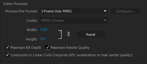

matthewcelia Posted January 19, 2015 Share Posted January 19, 2015 Have you tried the same clip in FCPX? Maybe premiere isn't working in 32bit color space, or your sequence settings aren't set up for maximum bit depth. Link to comment Share on other sites More sharing options...

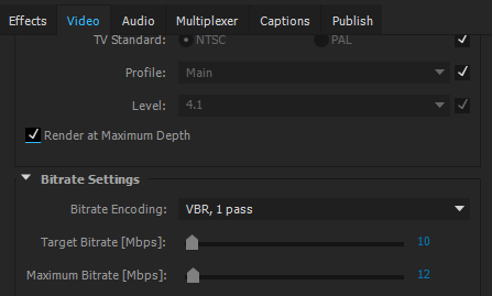

johnnymossville Posted January 19, 2015 Share Posted January 19, 2015 It looks like Resolve is doing some kind of dithering? Have you checked maximum render quality in Premiere? I haven't noticed this problem lately with my videos in Premiere. I'm going to check this out when I get a chance. Link to comment Share on other sites More sharing options...

sunyata Posted January 20, 2015 Share Posted January 20, 2015 A couple things you might want to also check (I see you've done a lot), make sure there is no transcoding or conforming happening on import, I'm assuming there isn't because it would be an obvious thing to check (this is akin to rendering media on import), some software does that automatically. Then to test your theory "What I think Premiere might be doing is remapping the 0-255 MJPEG material to the broadcast standard 16-235 " also check with an eye dropper etc in Premiere to see if your blacks and whites are still full range (0-255), this will rule out gamma scaling issues due to possibly working in a rec709 project. If there is no transcoding/conforming on import and no gamma/LUT applied, then I'm not sure why the banding is baked in even when rendering unncompressed, very odd. Also, you can do a test with an image sequence of the same clip at 8bit uncompressed just to be sure it's definitely something relating to mjpeg movie files. Link to comment Share on other sites More sharing options...
Daniel Lee Posted January 20, 2015 Share Posted January 20, 2015 IIRC, you can edit in 16-bits in Premiere and output in 10-bits when exporting/rendering. Have you tried this? You can also edit in 16 and 32-bit in After Effects and output the same in various formats in the render queue. Have you tried pulling in your project with banding via Dynamic Link and turning on 32bpc and then rendering out to 8-bit video, 10-bit or 16-bit formats? http://blogs.adobe.com/VideoRoad/2010/06/understanding_color_processing.html Link to comment Share on other sites More sharing options...
