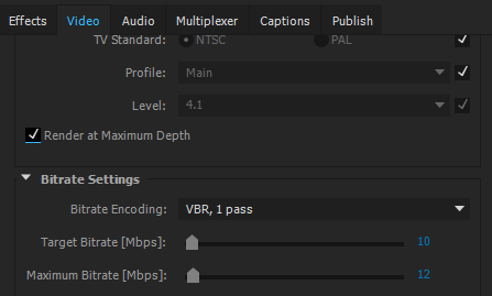

jgharding Posted January 25, 2015 Share Posted January 25, 2015 Perhaps try ticking the maximum bit depth option at export, it processes the video in float point. If you untick it it will be processed in 8 bit space.When editing, timeline video tends to play back at draft banding and scaling unless you tick max quality and max bit depth in sequence settings, which could be the cause.You may find that such things aren't on your exports if you use maximum settings, even if they appear in the timeline draft mode. Certainly I have no such problems.Many After Effects users complain of banding in their animations, until they realise they need to render in something other than 8-bit for the engine! It's often missed by users. Link to comment Share on other sites More sharing options...

sunyata Posted January 26, 2015 Share Posted January 26, 2015 Perhaps try ticking the maximum bit depth option at export, it processes the video in float point. If you untick it it will be processed in 8 bit space.When editing, timeline video tends to play back at draft banding and scaling unless you tick max quality and max bit depth in sequence settings, which could be the cause.You may find that such things aren't on your exports if you use maximum settings, even if they appear in the timeline draft mode. Certainly I have no such problems.Many After Effects users complain of banding in their animations, until they realise they need to render in something other than 8-bit for the engine! It's often missed by users. I tested importing a Premiere project into AE and rendering the mjpeg clip as an uncompressed tiff sequence from within an 8bit and 16bit project, thinking maybe that would be a workaround, but the banding was still re-baked into the file. Although this banding was a little different, not an identical match to the render test from Premiere. I didn't test rendering float from Premiere after the 16bit AE test though, or check the video preview box, I looked for something like that but couldn't find it.Can someone please post a link to a source file that they believe Premiere has a problem with? Since no one has yet posted any export settings or sequence settings (why?), I would like to rule out user error. One file is enough...Renders were tested early on by Andrew and I also tested in Premiere and AE, but as discussed above, I have not tested rendering float with the settings above for Premiere, only tested 8bit render and also used default video preview settings in Premiere. If you want to play around with it, you can use this slate:http://collectfolder.com/temp/slate_test_8bit_srgb_mjpeg.mov.zip Link to comment Share on other sites More sharing options...
