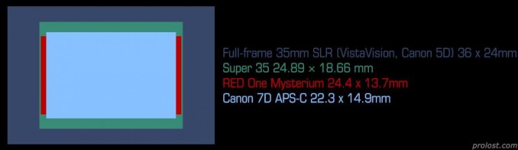

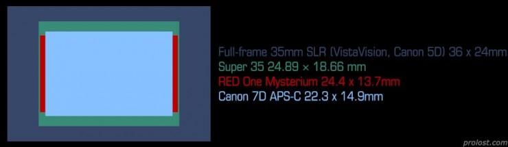

fuzzynormal Posted January 25, 2015 Share Posted January 25, 2015 ...if he had to choose one lens, it'd be 32mm...on your camera, that would be a lens in the low 20's. Isn't the 600D an ASP-C sensor, essentially the same size as s35 motion picture film?A 32mm lens is a 32mm in this context.It's not the crop factor, camera bodies, or lenses alone that determines "cinematic look." I understand why this notion persists, but people starting out should recognize that there's no simple solution to achieving such an aesthetic. The difference in 10mm focal length and 2 f-stops isn't going to determine the cinematic look of your film.Personally, and only just regarding the technical side of things, I feel that motion blur, frame rate, and skillful lighting are the bigger factors of the cinematic look...but one man's opinion...others will go on and on about skin tones and dynamic range as if the foundation of the industry is wholly reliant on those notions. But please don't let me dissuade anyone from pursuing gear purchases on a gear-centric site to solve a problem ... that gear alone cannot solve ;-) My lecturing aside, if I had to make an action film with one of those lenses I'd choose the 40mm and shoot @f2.8 at 24fps and a 50 shutter speed. Lock that in and don't change it. I'd control exposure with ND filters, lighting, and ISO.Above all, have fun. Link to comment Share on other sites More sharing options...

Jonesy Jones Posted January 30, 2015 Share Posted January 30, 2015 Actually no. Your'e right about the sensor's size being roughly the same as s35 film, however, cinema lenses are described in full frame equivalents. When Mr Deakins is describing a 32mm cinema lens on 35mm film, it is behaving like a 32mm lens on a full frame dslr. To achieve the same FOV on an aps-c sensor you'd need a 20mm lens (20x1.6=32). EDIT: I don't have this quote thing down but fuzzy said "Isn't the 600D an ASP-C sensor, essentially the same size as s35 motion picture film?... A 32mm lens is a 32mm in this context."Also, my explanation is probably atrocious, but the math is good. Link to comment Share on other sites More sharing options...
tbreade Posted January 30, 2015 Share Posted January 30, 2015 cinema lenses are described in full frame equivalents.No, they're not. The only people talking about focal length equivalents are DSLR/mirrorles stills camera users. In cinema 50mm is 50mm is 50mm, no matter 65-mm, 35-mm or 16-mm film/sensor is used. Also in cinema world "full frame" is called VistaVision. leeys 1 Link to comment Share on other sites More sharing options...
