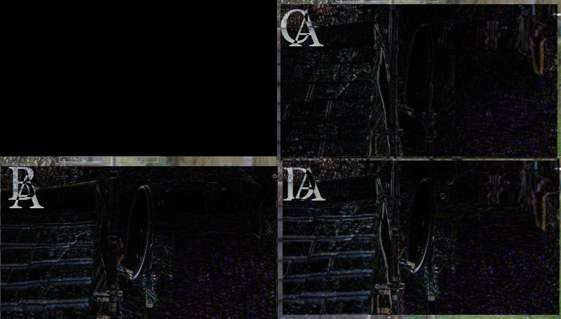

Nick Hughes Posted February 25, 2015 Share Posted February 25, 2015 They're not same image- you can test yourself using photoshop and the "difference" blend mode. I overlaid A with every image in the third example. The first box is black because it's an exact match. None of the other images disappear because they are all slightly different. Certain points line up and cancel out (it's very close after all, that's the point of the test), but no matter how you move, resale, tilt the images, they never cancel out completely. jcs 1 Link to comment Share on other sites More sharing options...
jcs Posted February 25, 2015 Share Posted February 25, 2015 Come on man the last two shots dont even have the slightest change in perspective, and for the other two are perfect color and character match. You are the perfect camera operator who can put cameras one a tripod without moving it at all and who can match two different cameras with different lenses to have exact the same color. Seriously you should go to hollywood they will pay you bigtime.See the bricks in the periphery- there are differences. Nick's example makes the differences more clear. Link to comment Share on other sites More sharing options...
