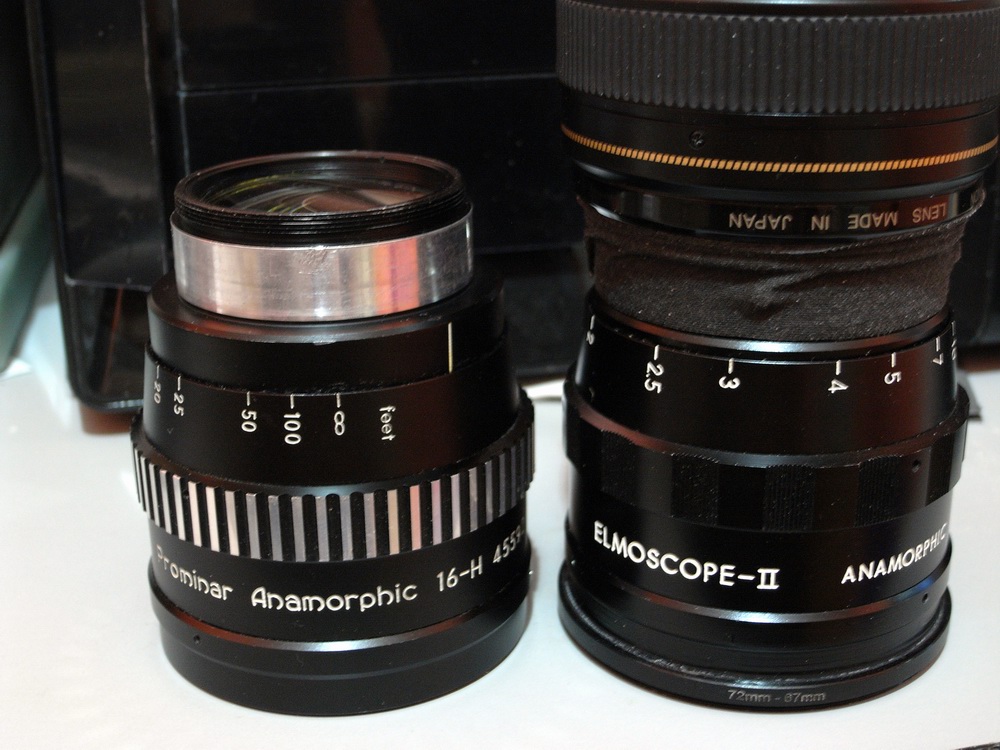

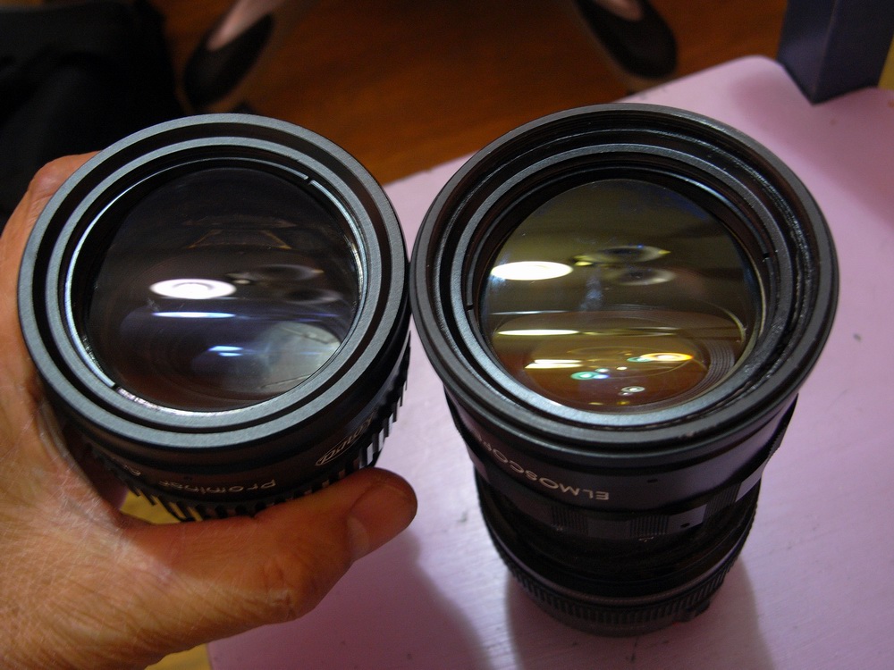

ken Posted June 16, 2016 Share Posted June 16, 2016 BTW, which coating you guys like? I owned 16h, Elmoscope-II and B&H. Elmoscope-II and B&H have the same coating, like yellowish, and 16h like blue. In 2 pictures, left is 16H, right is Elmoscope-II. Link to comment Share on other sites More sharing options...
tweak Posted June 16, 2016 Share Posted June 16, 2016 I've had 2 x Elmoscope II, 2 x 8Z and 1 x B&H. One 8Z had Gold flares, one Blue flares. The Blue one flared the easiest of any lens I've owned. Both Elmo Scopes were Gold flares, Both B&H were Gold flares. The Elmo IIs I had seemed to flare a bit easier than the B&H. The one I kept and use the most now is an Elmo II, but I think it's really dependent on production factors as to which is the sharpest/ best. They all can be good. ken and webrunner5 2 Link to comment Share on other sites More sharing options...
ken Posted June 16, 2016 Share Posted June 16, 2016 10 hours ago, tweak said: I've had 2 x Elmoscope II, 2 x 8Z and 1 x B&H. One 8Z had Gold flares, one Blue flares. The Blue one flared the easiest of any lens I've owned. Both Elmo Scopes were Gold flares, Both B&H were Gold flares. The Elmo IIs I had seemed to flare a bit easier than the B&H. The one I kept and use the most now is an Elmo II, but I think it's really dependent on production factors as to which is the sharpest/ best. They all can be good. To me, I like Elmo II the most. It is only metric system of all these type lenses. So I can tell distance 10 meter more easily than than 30 ft. Btw, looks like the gold flare is stronger than blue flare, right? Link to comment Share on other sites More sharing options...
tweak Posted June 17, 2016 Share Posted June 17, 2016 My Elmo has pretty strong flares, but my 8Z blue flare is the strongest, it will flare from anything (and it looks nice unlike some other blue flares from certain brands). I also prefer Metric. ken 1 Link to comment Share on other sites More sharing options...
