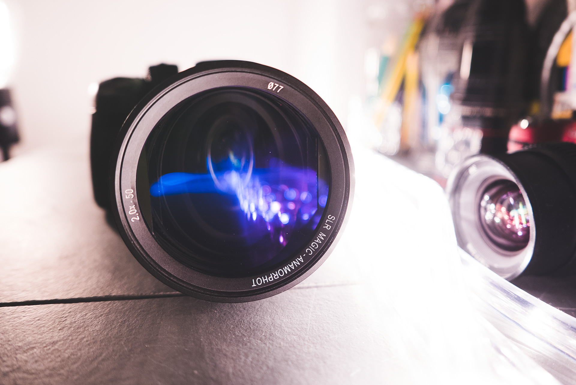

Administrators Andrew Reid Posted February 26, 2015 Administrators Share Posted February 26, 2015 SLR Magic Anamorphic 2x on the Panasonic GH4 (4:3) http://www.eoshd.com/2015/02/slr-magic-2x-anamorphic-anamorphot-on-the-panasonic-gh4-43/ Orangenz and Sebastien Farges 2 Link to comment Share on other sites More sharing options...

Rudolf Posted February 27, 2015 Share Posted February 27, 2015 So it's a unit-focus lens, but the focusing is done with the taking lens?How well does that work? Definitely sounds like solid competition with the Iscoramas if it's single-focus.It is a focus through adapter and as all focus through adapter not sharp beyond 5.6 or so. Therefore it is no competition for an Iscorama. What I like about it is that it is light.And maybe it is not that bad to blur the too sharp GH4 especially with modern lenses?!Otherwise I'd prefer the other new kids on the block like FM or Rectilux. Unfortunately I haven't seen real life tests from the Rectilux yet otherwise I'd go for that with Moellers.Also no support needed and easy swap as John pointed out.Furthermore I don't expect the SLR 2x to be sifnificantly cheaper then one of the above mentioned competitors. Cosimo murgolo 1 Link to comment Share on other sites More sharing options...

nahua Posted February 27, 2015 Share Posted February 27, 2015 You can use vintage lenses. But you have to shoot 2-3 stops from wide open - F2 means F5.6/F8 (Helios/Jupiter 9). Modern lenses like Panasonic or SLR Magic's CINE lenses work fine but are maybe too clinical or too sharp. Also recommended minimum aperture is F2.8, no matter what lens you use.BTW this is NOT a focus-through lens. You still have to use the Near/Normal ring to focus, plus focus the taking lens. It's a compromise - it's not a single focus unit, but it's not as bad to dual-focus as some projector lenses. I've used AF with the Panasonic 12-35mm X lens at F2.8, and then manually focused for distance with the Near/Normal ring. Works really well and the IS helps stabilize the image. Link to comment Share on other sites More sharing options...
Zak Forsman Posted February 27, 2015 Share Posted February 27, 2015 Sweet, what was your cam setup by the way?this is on a GH4 w/ speedbooster and an old Nikon 35mm f/1.4 AIS lens set to f/2.8. i didn't use 4x3 mode because i didn't want to lose 24fps. so this is a 2.39:1 center crop from the 3.55:1 original. Link to comment Share on other sites More sharing options...
