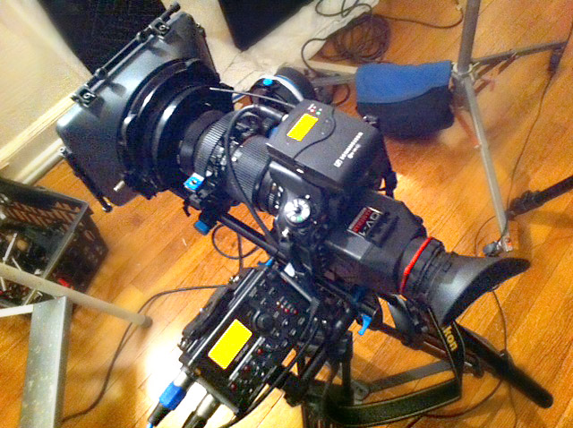

M Carter Posted March 9, 2015 Share Posted March 9, 2015 I've wondered myself - if the screw mount on the 70d is the same hardware as the 60d, that thing is pretty big!My only issue with the 60D? When the meter says it's peaking, it's not even close. I've gotten a lot of audio tracks that are pretty weak until I learned to (A) kinda slam the meters, (B) activate the -6DB safety track for peace of mind and (C) use the limiter (See"B")!Also, it has some issues with rechargeable batteries, announcing they're too low of a charge. But the 60D will run ALL FREAKING DAY with something like an Anker USB battery - $30!!I mount mine on a crossbar of 15mm rod, works great for tripod work... 1tkman 1 Link to comment Share on other sites More sharing options...

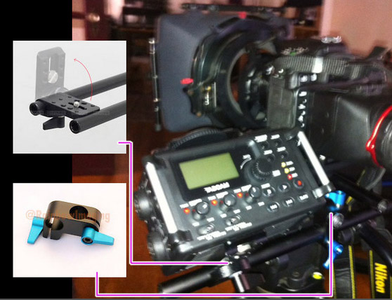

Nick Hughes Posted March 9, 2015 Share Posted March 9, 2015 I mount mine on a crossbar of 15mm rod, works great for tripod work... I've been looking for a practical way to mount mine- you look like you've find a pretty great solution! Mind posting any detailed pics? Link to comment Share on other sites More sharing options...

1tkman Posted March 9, 2015 Share Posted March 9, 2015 What a rig! What are you shooting with here? Link to comment Share on other sites More sharing options...
M Carter Posted March 9, 2015 Share Posted March 9, 2015 I've been looking for a practical way to mount mine- you look like you've find a pretty great solution! Mind posting any detailed pics?I use a 15mm rod fitting I found on ebay on the bottom of the DR, and a 90-degree fitting on a piece of 15mm rod. The rod is fastened at 90 degrees on the left rod in the pic, and the right rod keeps it from twisting (the weight of the DR would make it drop, but the rod under the DR hits the right rod so it's stable, if that makes sense!). Can't remember the link for that little part, it was like 9 bucks from China. If you go into eBay photo and search "15mm rod" you'll get about 400 little doodads, some of which are pretty useful.By the way, now I use a little Anker USB battery - I had an old Sennheiser G3 receiver shoe mount, I just velcro the Anker to that and it lives on top of the DR via the DR's male screw. Link to comment Share on other sites More sharing options...
M Carter Posted March 12, 2015 Share Posted March 12, 2015 What a rig! What are you shooting with here?That's my "there's time to get it right" without a rental setup, vs run & gun camera... Nikon D7100, Fotga follow focus, a loupe, matte box, and (somewhere off frame) a monitor with peaking and 1:1. Probably an 85 1.8 on the camera, this was a corporate interview and that lens... if I had panties they'd be soaked! I just use rubber hoods pressed against the matte box instead of donuts, that's very quick and easy and I can leave them on the glass. Well, just scrolled up, not sure what lens that is, could be a nikkor 35-70 2.8? Sold that a while ago for a 28-70. It's a great little setup and was pretty cheap - that Fotga FF is really a super buy. Link to comment Share on other sites More sharing options...
