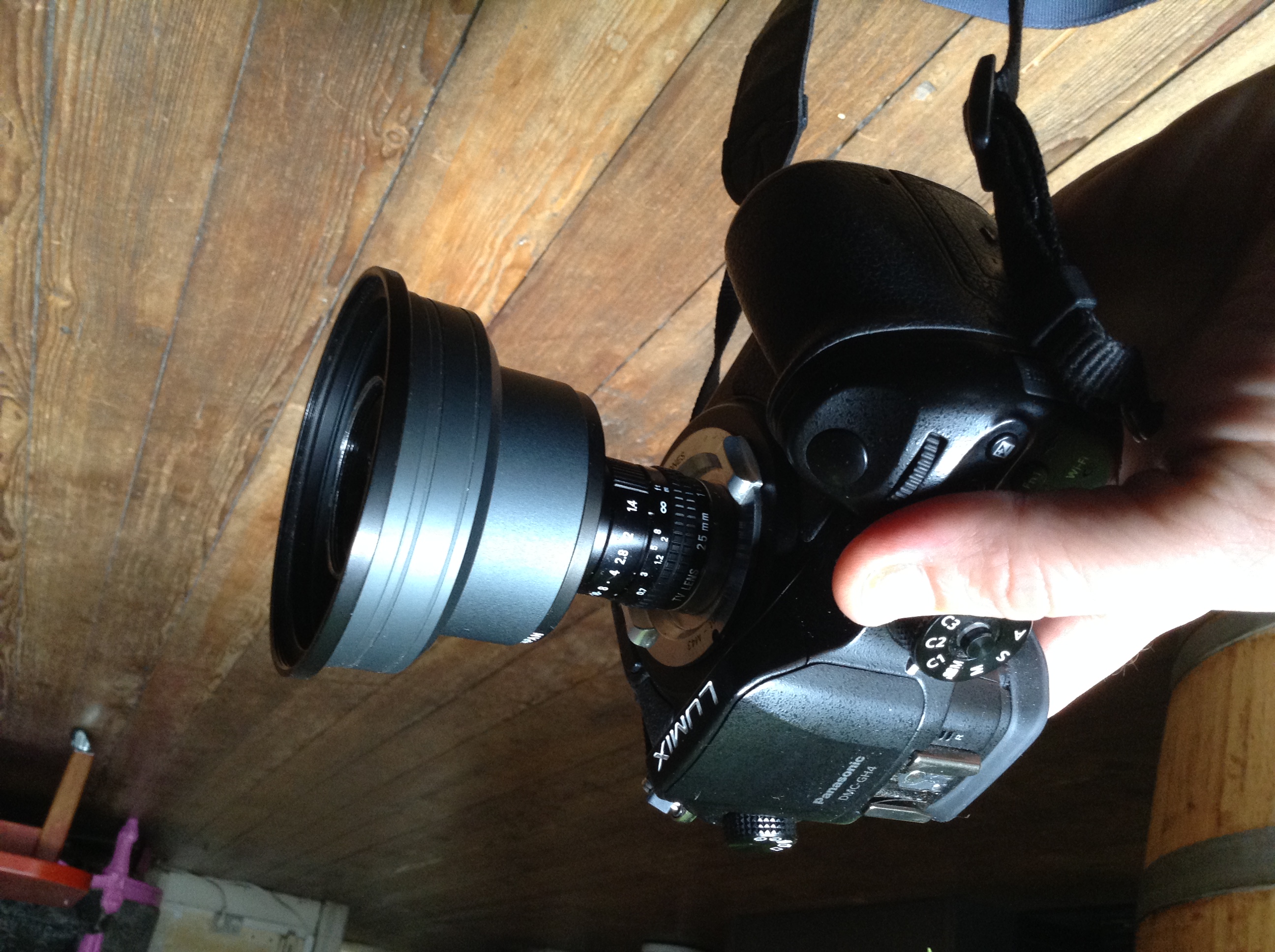

Hi my anamorphic friend, here is a a new match I've found for my baby Hypergonar, the Pentax Cosmicar 25mm f1.4 C-mount lens, and I like the result, despite the distortion and the slight vignetting. What do you think ? (more information below)
Oleron Island (Baby Hypergonar on Pentax Cosmicar C-mount)
GH4 UHD photo mode 3:2 25p
Cinelike V +0 -5 -5 -2 +2
Highlight +1 Shadow +5
Master Pedestal +11
Baby Hypergonar 1.75x anamorphic lens
Redstan clamp
SLR Magic +0.33, +1.3, +1.8 diopters, Narumi +3 diopter
SLR Magic ND variable filter
Lumetri CC and levels adjustments in Premiere
Everything was shot between @f2 / f2.8 (because upper gives more vignetting) or more when exposition needs, except close shost with diopters @f1.4
