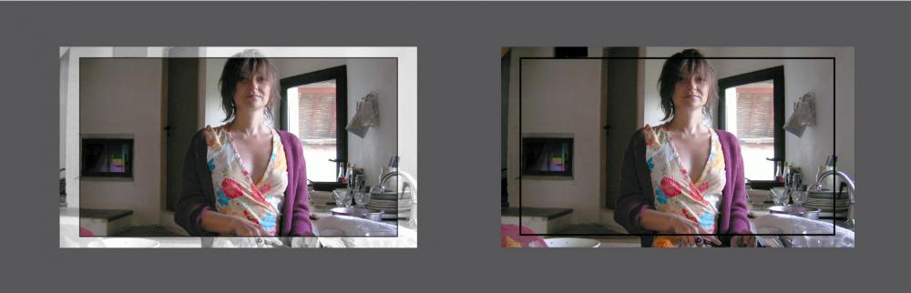

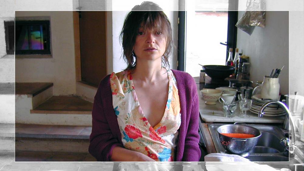

jpb Posted March 21, 2015 Share Posted March 21, 2015 http://www.atdelectronique.com/our-offer/bae-systemsthis Fairchild LTN sensor is a dream for a camera manufacturer, with its 4608x2592 pixel count,it scans images from which you can extract 4096x2304 Super35 16x9 images for 4K deliverywhile you send to the viewfinder the entire non cropped image displaying the standard +12%out of frame field of view that all professionnal filmmakers request.When designing the Aaton Delta Penelope, to clearly differentiate the extra field imagefrom the recorded one we were showing it in +/- bright b&w as shown in the attached image.It would be good if a manufacturer could offer that option which better emulates a film camera OVF. IronFilm 1 Link to comment Share on other sites More sharing options...
Guest Ebrahim Saadawi Posted March 21, 2015 Share Posted March 21, 2015 I'd prefer to record the entire sensor and do my cropping later, with frame guidelines on the LCD or EVF. Link to comment Share on other sites More sharing options...
jpb Posted March 22, 2015 Share Posted March 22, 2015 I'd prefer to record the entire sensor and do my cropping later, with frame guidelines on the LCD or EVF. In the feature film world, all directors and camera operators are adamant : "don't touch our framingcarefully performed on stage".But if you are the man of all hats (camera operator / editor / colorist) on a documentary film,recording these extra pixels can help you reframe or stabilize your images on some occasions.Whatever the situation, the out-of-frame grayed area is a good alternativeto the standard white or black lines that in the fire of action your eye no longer sees...letting you frame onto the full viewing screen. richg101 and studiodc 2 Link to comment Share on other sites More sharing options...
Guest Ebrahim Saadawi Posted March 22, 2015 Share Posted March 22, 2015 What I think is that recording the entire sensor window is a superior option to choose in a camera, rather than recording a center portion and wasting the outer area for the viewfinder lookaround. Since we've gone digital, when you record the entire area you can draw the crop lines in the EVF, grey them out, brighte them, anything, which will give the operator the exact same lookaround area, but with the full record option, you habe the chance to use the larger sensor shall you need it. I find that digital cropping is not relevant in cameras that record their full pixel readout, because it can be performed in post with a single click. I guess the only reason one might still want to crop in-camera is if someone is handing off the footage straight off the card, and they have absolutely no communication with the post-production area, can't leave a note, a metadata flag, or simply tell them to crop to 16:9 4K without changing framing. This reminds me of the Log-Gamma debate of whether to get things in-camera or shooting Log for post correction. Turns out the answer is: for most people who have communication with the post production process LOG is superior, gives more options, but for those handing off the footage straight of the camera for a viewer or without having communic. with post production at all, then shooting baked-in is the way to go. So I guess for a camera manufacturer, it's best to give all the options. Give the option for shooting LOG and for shooting Rec.709, give the option to record entire sensor, and option to record crop. but if the manufacturer has to choose between the two (which seems to be common for all manufacturers for some reason I cant quite understand) then for a cinema/film camera sticking with LOG+full sensor is the better option as this area shooters are seeking the absolute highest image quality, while with a documentary, news camera it's better to choose the Rec.709 + in-camera cropping option as their users deliver immediately any care less about getting the ultimate quality/DR/flexibility in post, just want to get things done. All companies should just offer both options, why not? If a small hacking team like Magic Lantern can simply give control on every single little function and add EVERY possible feature with full user cusgomizability, sometimes it makes me wonder how these huge corporations still can't give us similarly powerful software (as good as one created by a punch of reverse engineering hackers online), where are the internationally-recognised engineers, highest-end academic developers and professional software design teams within these companies? what are they doing? maybe they can do it and exceed it but forced to stop by the marketing departments (which is sadly the most logical explanation) that would be honestly just non-respectful behaviour to everyone, just being able to offer something usefull for other people and not doing it on purpose is a shamefull thing to do' or at least that's how I was raised as a ''good'' human being! Link to comment Share on other sites More sharing options...
