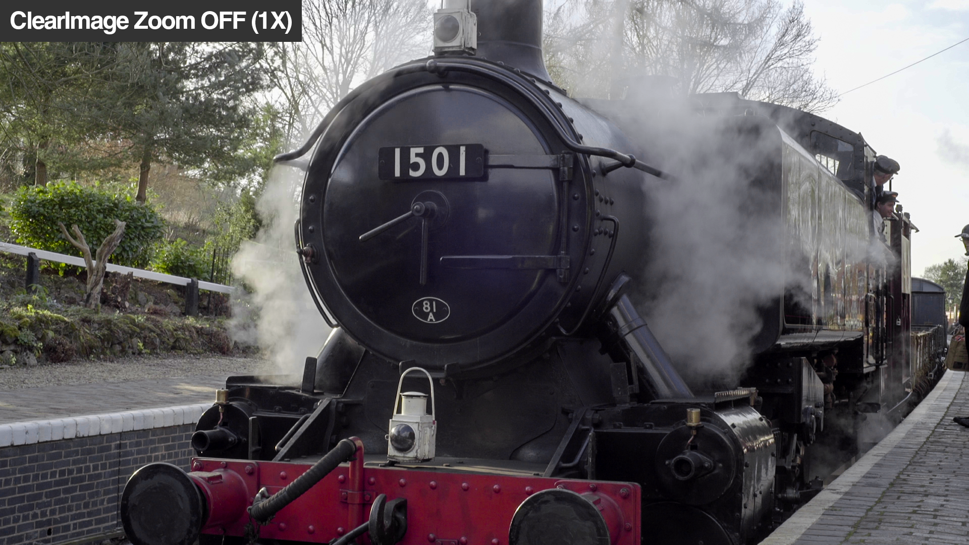

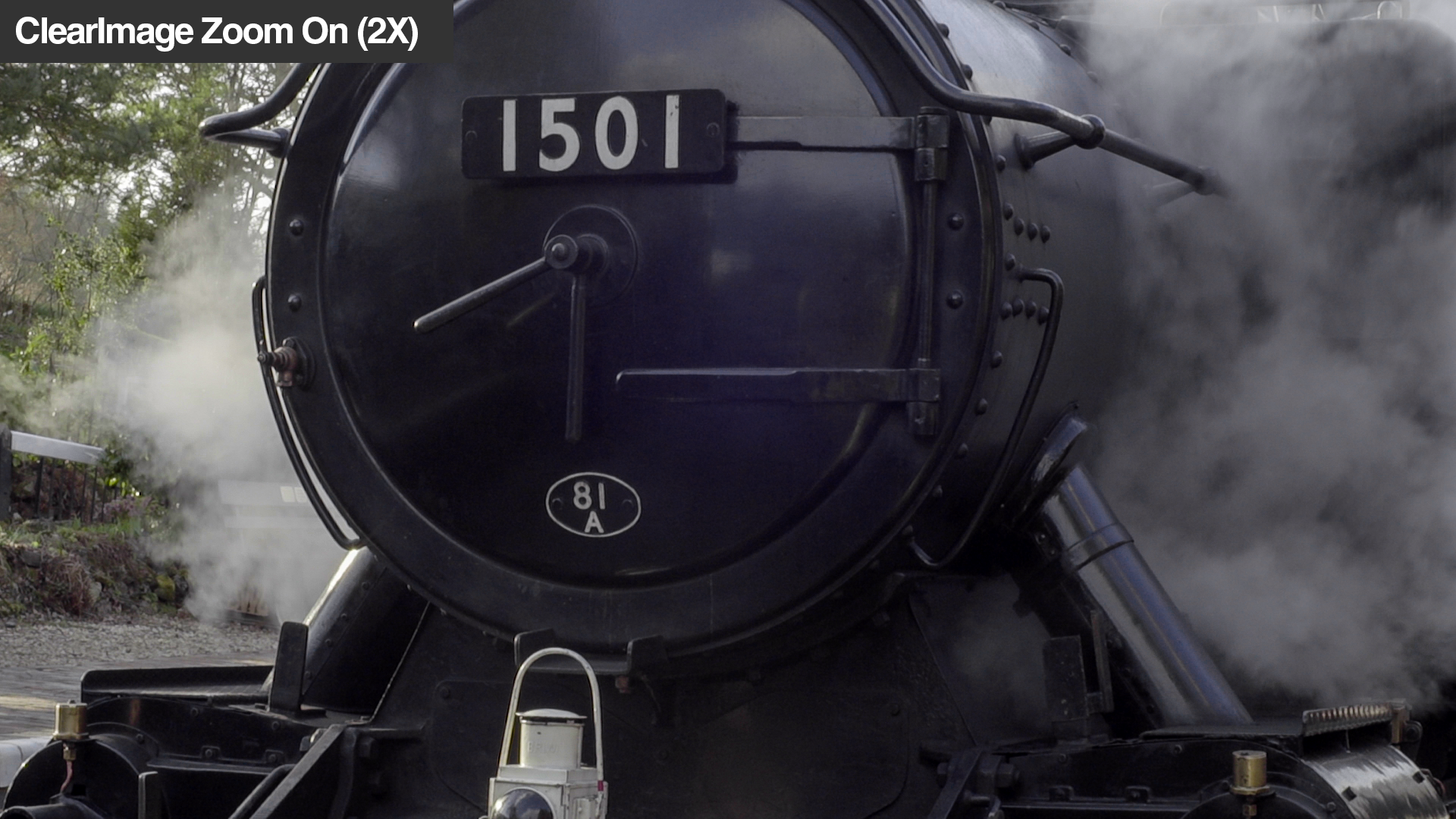

Jimmy Posted March 22, 2015 Author Share Posted March 22, 2015 Click to view 1080p screenshots... (Focus was slightly off... Check the detail in the right of the engine). Link to comment Share on other sites More sharing options...
