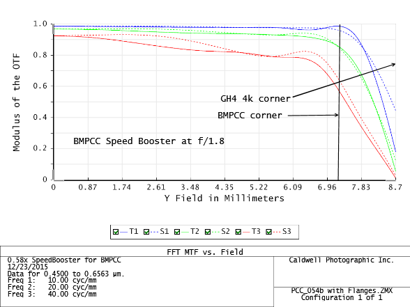

Brian Caldwell Posted December 23, 2015 Share Posted December 23, 2015 performance will take a hit but not enough to warrant disregarding the fact that the system provides a half a stop advantage in speed and quite a difference in fov. with the extra 1/2 of a stop from the bmpcc one could close down by half a stop and gain a lot more performance than the filter thickness will degrade. The 0.58x BMPCC Speed Booster is designed to cover an image circle of about 15mm diameter, which is slightly larger than the BMPCC sensor diagonal. Aberration correction is extremely good within this 15mm diameter, as is the relative illumination. However, for the GH4 4k mode you need to cover at least 17.4mm. Assuming you don't damage your camera by trying to mount the BMPCC S.B. on a GH4, you will encounter vignetting and significant image degradation in the corners. I do not recommend trying this. By contrast, the new m43 XL Speed Booster will cover the entire m43 format, not just the reduced 4k crop, and you won't have any problems with image quality. The difference between the BMPCC and XL is only 1/3 stop. Phil A and jonpais 2 Link to comment Share on other sites More sharing options...

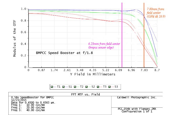

richg101 Posted December 23, 2015 Share Posted December 23, 2015 Either you've been over engineering your lenses, or I'm tired and confused:) I just checked sensor specs and based on sizes of the bmpcc sensor and the area used on the gh4 (UHD, 16:9 mode) I'm seeing a pair of different corner reference points on your chart. obviously that steep droop towards the farthest edge of the field is still there, but with the two reference points moved to the sensor horizontal edges based on what I'm seeing from the sensor data then things look a lot more promising on both the gh4 and the bmpcc..Just to clarify, your Y axis is the horizontal and not the diagonal isnt it? if so, the new pink line I've added shows 6.25mm from sensor edge (bang on the edge of the bmpcc sensor's 12.5mm width), and the orange line plots the edge of the gh4 sensor area used in 4k 16:9 mode (15.65mm pickup area width). Link to comment Share on other sites More sharing options...
Brian Caldwell Posted December 23, 2015 Share Posted December 23, 2015 Either you've been over engineering your lenses, or I'm tired and confused:) I just checked sensor specs and based on sizes of the bmpcc sensor and the area used on the gh4 (UHD, 16:9 mode) I'm seeing a pair of different corner reference points on your chart. obviously that steep droop towards the farthest edge of the field is still there, but with the two reference points moved to the sensor horizontal edges based on what I'm seeing from the sensor data then things look a lot more promising on both the gh4 and the bmpcc..Just to clarify, your Y axis is the horizontal and not the diagonal isnt it? if so, the new pink line I've added shows 6.25mm from sensor edge (bang on the edge of the bmpcc sensor's 12.5mm width), and the orange line plots the edge of the gh4 sensor area used in 4k 16:9 mode (15.65mm pickup area width). Hi Rich:Your numbers would be for the horizontal dimension of the format, not the diagonal. My numbers indicate the full diagonal dimension. According to my data, the diagonal (corner-to-corner) of the BMPCC sensor is 14.32mm, and the diagonal of the GH4 Cinema 4k crop is 17.4mm. richg101 1 Link to comment Share on other sites More sharing options...
richg101 Posted December 23, 2015 Share Posted December 23, 2015 hahahaha. it would appear i was (and am) tired and confused. I've been looking at mtf's for an anamorphic (with 3 charts for points of reference on the vertical plane rather than a single diagonal). My Y fields have been horizontals of late.on the subject of speed boosters...What are your opinions of this upcoming kipon medium format focal reducer? There's been heated debate as to whether it's worthwhile or not. Are you of the belief that if a focal reducer is designed and manufactured within a typical budget for consumer sale and with enough focal reduction to present the exact same fov it can replicate exactly the look of the lens fitted to its original format? for instance.. If you had a 80mm/2.8 planar and took a photo on a 645 frame of full 56mm width, then took that same 80mm lens and put it on a focal reducer with enough magnification change to compress that same image circle onto a 24mmx36 frame, would the two render the fov/depth of field exactly the same? or would you expect the dof rolloff to render differently? Link to comment Share on other sites More sharing options...
