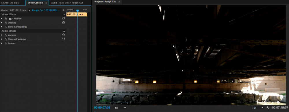

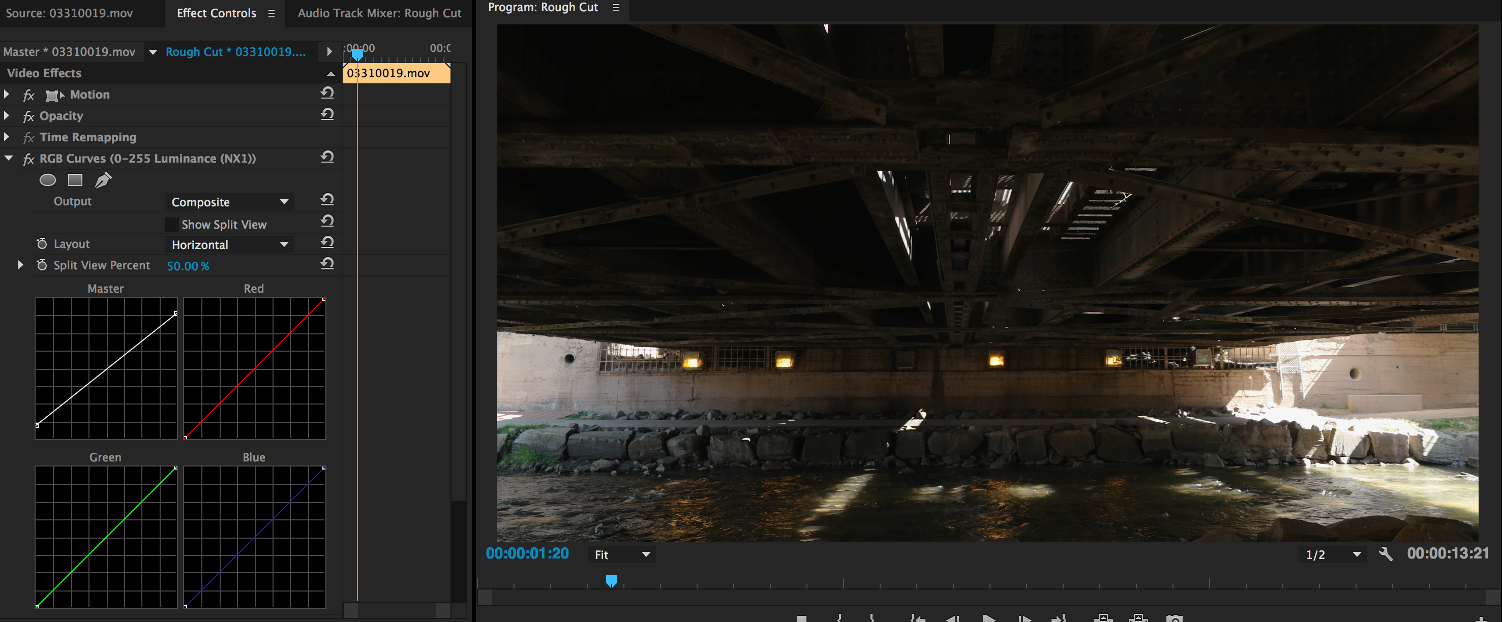

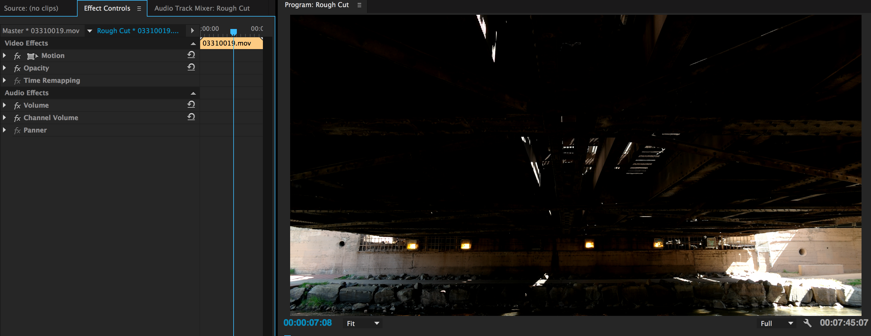

neosushi Posted April 1, 2015 Share Posted April 1, 2015 Yeah, top image is iFFmpeg — lower image is EditReady.I talked with the good people at EditReady (killer customer service, by the way). They explained that iFFmpeg is keeping the imported 0-255 luminance level in their ProRes files while EditReady converts the footage to 16-235. So the shadow and highlight detail isn't lost completely, a simple curves adjust can bring it back. It isn't an ideal solution, but I have found EditReady's ProRes files are much easier on my CPU / GPU. I found that iFFmpeg ProRes files really bogged down my machine. Maybe we could try with the fast color correction, setting the output to 16-235. This did the trick wit the GH4... I'll see if it works Link to comment Share on other sites More sharing options...
Administrators Andrew Reid Posted April 1, 2015 Author Administrators Share Posted April 1, 2015 Nice to know about the 0-255 issue.Switched to 16-235 in-camera and the problem has gone. Makes grading that bit more straight forward.Loving EditReady. It's a beast. Link to comment Share on other sites More sharing options...

iFFmpeg Posted April 7, 2015 Share Posted April 7, 2015 Just dropping some iFFmpeg hints here:You can convert 0-255 to 13-235 by setting the color range in the Advanced/Generic options at the bottom.And don't forget the "Convert Color Matrix" video filter. Makes it easy to convert between BT.601 and BT.709. Link to comment Share on other sites More sharing options...
Colin McFadden Posted April 28, 2015 Share Posted April 28, 2015 Hi folks - I'm one of the developers from Divergent Media, and I thought I'd chime in a bit here. If folks have questions about why we're doing what we're doing (IE, not remapping 0-255 to 16-235) let me know. We *think* this is the right approach, since presumably people shooting 0-255 generally are doing so for a specific reason. Has anyone created a basic LUT for NX1 footage at this point? We'd be happy to help spread the word.Just to clarify one point - while EditReady does use the ffmpeg libraries for reading MXF files and (currently) for h.265 decoding, EditReady isn't just a wrapper on FFmpeg. We also leverage Apple's VideoToolbox framework (the framework that underlies AVF) and even old QuickTime frameworks for legacy codecs. All the hardware accelerated / OpenCL code is custom, in-house stuff, which means we have full control of the image pipeline - all the color transforms, etc.If folks have questions, just let me know!-Colin Link to comment Share on other sites More sharing options...

Ed_David Posted May 13, 2015 Share Posted May 13, 2015 Andrew, I ended up purchasing an NX1 a couple weeks ago to compliment my C100 after reading many of your articles on your site and watching your tests on Vimeo. Today, I just purchased EditReady.. I just wanted to know which video format would you recommend converting to? ProRes 422 or ProRes422 (HQ)?I'll let Andrew chime in but pro res 422 and pro res hq are both 10 bit codecs 4:2:2 - the difference is the bit rate. So grading is not much different unless it is fast-paced motion or tons of motion like filming water.But do a test to see yourself - process one clip.The big thing is to make sure you have the NX1 set up to output at the proper light level - so that editready doesn't export a crushed-black pro res file. Link to comment Share on other sites More sharing options...
Drives Posted May 13, 2015 Share Posted May 13, 2015 I'll let Andrew chime in but pro res 422 and pro res hq are both 10 bit codecs 4:2:2 - the difference is the bit rate. So grading is not much different unless it is fast-paced motion or tons of motion like filming water.But do a test to see yourself - process one clip.The big thing is to make sure you have the NX1 set up to output at the proper light level - so that editready doesn't export a crushed-black pro res file.Thank you! I set the Luminance Level to "16-235".. Is that what you're talking about?If I'm shooting some scenes at 120fps, then I guess I should convert it to ProRes HQ? Link to comment Share on other sites More sharing options...
Ed_David Posted May 13, 2015 Share Posted May 13, 2015 Thank you! I set the Luminance Level to "16-235".. Is that what you're talking about?If I'm shooting some scenes at 120fps, then I guess I should convert it to ProRes HQ?yes that's what editready developers recommend here - As I said, we’ll keep investigating and then do a writeup, but I think the best advice is if you’re not planning to go through a full LUT/CC pass, you should be shooting video range (16-235), rather than counting on your transcode to clamp your values. I think in general go to pro res HQ unless you need the space. Higher bit rate is always worth it. Link to comment Share on other sites More sharing options...
