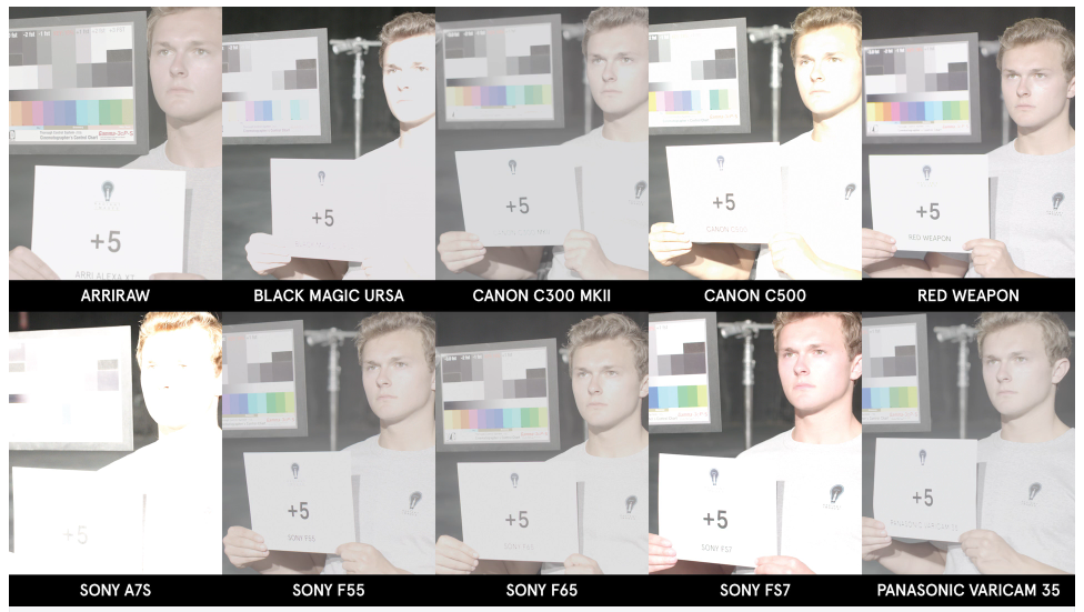

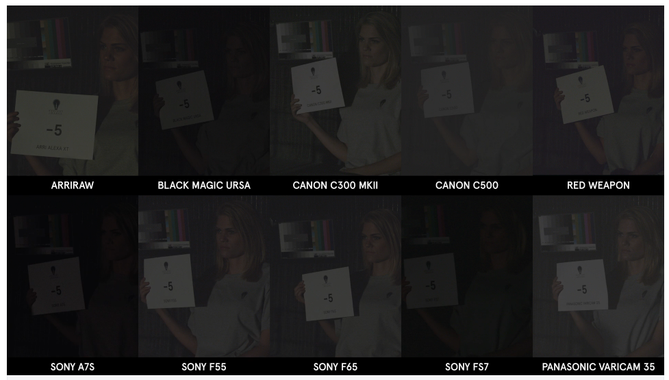

Jimmy Posted September 29, 2015 Share Posted September 29, 2015 Did you see the side by sides? Not sure how this could be considered blown out really. Seems to me that the C300II holds slightly more in the shadows, whereas the Alexa holds slightly more in the highlights... Link to comment Share on other sites More sharing options...
Guest Ebrahim Saadawi Posted September 29, 2015 Share Posted September 29, 2015 The Alexa shows a slight edge in detail retention in the highlights, looking at +4 examples, the alexa advantage is 1/2-ish stop, and they have the same smooth roll-ff aesthetic, while the C300 has quite a marked advantage in the shadows/lowlight with at least 2 stops, Alexa is noisy. C300II seems to have more or at least similar DR to the much, much more expensive alexa and weapon. Link to comment Share on other sites More sharing options...

kedbear Posted September 30, 2015 Share Posted September 30, 2015 The Alexa shows a slight edge in detail retention in the highlights, looking at +4 examples, the alexa advantage is 1/2-ish stop, and they have the same smooth roll-ff aesthetic, while the C300 has quite a marked advantage in the shadows/lowlight with at least 2 stops, Alexa is noisy. C300II seems to have more or at least similar DR to the much, much more expensive alexa and weapon.It's clear from the test the Alexa has more than a 'slight edge' in the highlights. The highlight retention of the C300 from this test looks like the F55. Is it good? Yeah not bad. Is it like the Alexa? No. The Alexa does not even start to blow at +5! Look at the shirt of the guy in the frame. The C300MKII has been tested to show noise that is not as nice as the Alexa. The Alexa has a much more natural monochromatic noise that is grain like, and does not exibit the noise as early as the C300MKII.I think once more tests come out it will be clear that Canon were not accurate with their 15 stop claim. Still, it's a decent enough camera that i'm sure will make some great pictures, like the C300 did for Blue Ruin. Will it replace the Alexa for Cinematographers who can choose? No. TheRenaissanceMan 1 Link to comment Share on other sites More sharing options...

Guest Ebrahim Saadawi Posted September 30, 2015 Share Posted September 30, 2015 I think it's a great, accurate visual test, It's clear from the test the Alexa has more than a 'slight edge' in the highlights. Look at +4 and you'll see it's a less than a stop difference. Plus it's still unknown how much information can be brought down in post, this is key. Remember DR distribution is different, for example the alexa might have an extra highlight stop and a lower shadow stop, therefore the C300II can be lowered one stop to get identical DR, if the C300 has extra two shadow stops, then it can be lowered 2 stops and get 1+ stop of DR over alexa (15), which is what I am seeing (alng with Geoff boyle & bloom) Distribution is different. One key element the test doesn't show is how the image looks brought down in terms on colours and detail, without this it's just a roll-off comparison, which alexa and c300 excel at.Wait for an accurate DR test side by side before making conclusions. Pretty premature. All what we're seeing might very well be wrong. It's not out and tested yet.The C300MKII has been tested to show noise that is not as nice as the Alexa. Pre-productioon C300 units has horizontal FPN and chroma noise that will not exist in the final version. Will it replace the Alexa for Cinematographers who can choose? No.I disagree, this is just based on the alexa name tag stuck in our head as the film camera, but others have caught up and that will change. I think the varicam and C300II will perfectly replace Alexa for many shoots as better cameras, according to the image. As filmic as Alexa in highlights with similar DR, similar colour science, better form factor, smaller, better audio, revolutionary AF, 10 stop ND without contamination, higher resolution, much, much, much better lowlight performance, extremely lower production cost, the Varicam and C300 can easily replace Alexa and compete for the feature crowd for many reasons. People can seem to get their head around the C300II being a Weapon/Alexa/Varicam rival just for the name tag of Canon broadcast C300, it changed to a film emulating camera and abandoned the mpeg-2 broadcast feature actually showing where they're aiming it. We'll see with legitimate testing, but so far I am pretty optimistic for the C300II (and Varicam, gorgeous) Link to comment Share on other sites More sharing options...
kedbear Posted September 30, 2015 Share Posted September 30, 2015 I think it's a great, accurate visual test, Look at +4 and you'll see it's a less than a stop difference. Plus it's still unknown how much information can be brought down in post, this is key. Remember DR distribution is different, for example the alexa might have an extra highlight stop and a lower shadow stop, therefore the C300II can be lowered one stop to get identical DR, if the C300 has extra two shadow stops, then it can be lowered 2 stops and get 1+ stop of DR over alexa (15), which is what I am seeing (alng with Geoff boyle & bloom) Distribution is different. One key element the test doesn't show is how the image looks brought down in terms on colours and detail, without this it's just a roll-off comparison, which alexa and c300 excel at.Wait for an accurate DR test side by side before making conclusions. Pretty premature. All what we're seeing might very well be wrong. It's not out and tested yet.Pre-productioon C300 units has horizontal FPN and chroma noise that will not exist in the final version. I disagree, this is just based on the alexa name tag stuck in our head as the film camera, but others have caught up and that will change. I think the varicam and C300II will perfectly replace Alexa for many shoots as better cameras, according to the image. As filmic as Alexa in highlights with similar DR, similar colour science, better form factor, smaller, better audio, revolutionary AF, 10 stop ND without contamination, higher resolution, much, much, much better lowlight performance, extremely lower production cost, the Varicam and C300 can easily replace Alexa and compete for the feature crowd for many reasons. People can seem to get their head around the C300II being a Weapon/Alexa/Varicam rival just for the name tag of Canon broadcast C300, it changed to a film emulating camera and abandoned the mpeg-2 broadcast feature actually showing where they're aiming it. We'll see with legitimate testing, but so far I am pretty optimistic for the C300II (and Varicam, gorgeous) I don't see the same colour as Alexa, higher resolution is of little benefit compared to the open gate mode the Alexa already gives, and the dynamic range is not as good, particularly in the highlights which do not roll off like the Alexa. Which professional film uses AF, hardly worth putting that in there as a bonus. The c300MKII from everything i've seen is not as pleasing as the Alexa. I think more tests and shooting will make this clear. To each their own i guess. Anyway, i look forward to seeing more and using the C300MKII, but i won't be choosing it over Alexa anytime soon whenever i have the choice, not least for the organic image the Alexa gives. Link to comment Share on other sites More sharing options...
hmcindie Posted October 1, 2015 Share Posted October 1, 2015 Well there is a huge price difference between the Alexa and the C300II so you would hope that it gives one stop more in the highlights 8) It's clear from the test the Alexa has more than a 'slight edge' in the highlights. It's hard to say.Imagine that one camera "blows out" at +5. That means everything is completely white. And the other camera blows out at +4.That means if you look at an image that's been exposed to +4.5 the A camera will look clearly better.But that is still only a "slight edge" as in normal exposures (+0) the difference will be negligible as long as the roll-off is good. Take a look at the +0 exposures. See a difference between those cameras? Link to comment Share on other sites More sharing options...
Jimmy Posted October 1, 2015 Share Posted October 1, 2015 And if you can pull an extra stop from the shadows, you would just slightly under expose to protect your highlights, which seems to be the case with the C300II Link to comment Share on other sites More sharing options...
