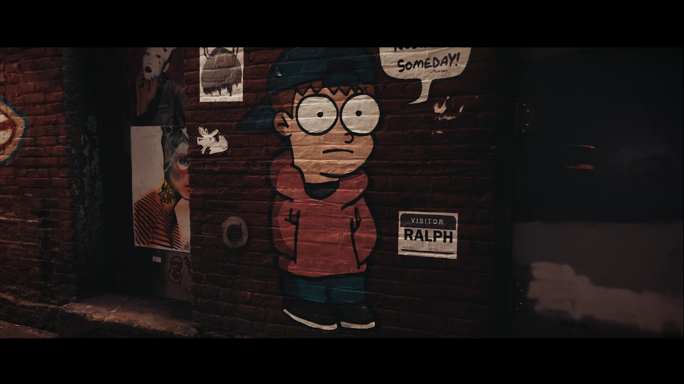

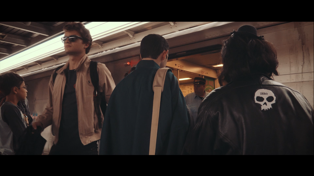

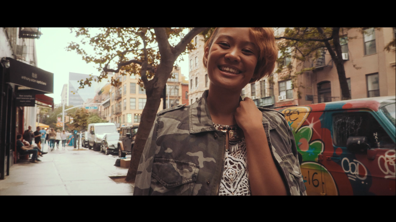

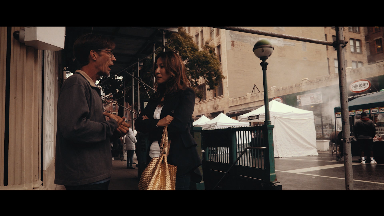

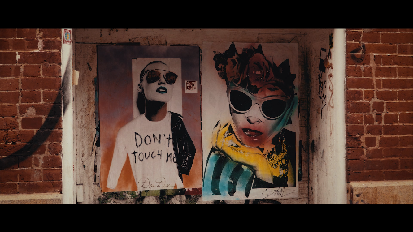

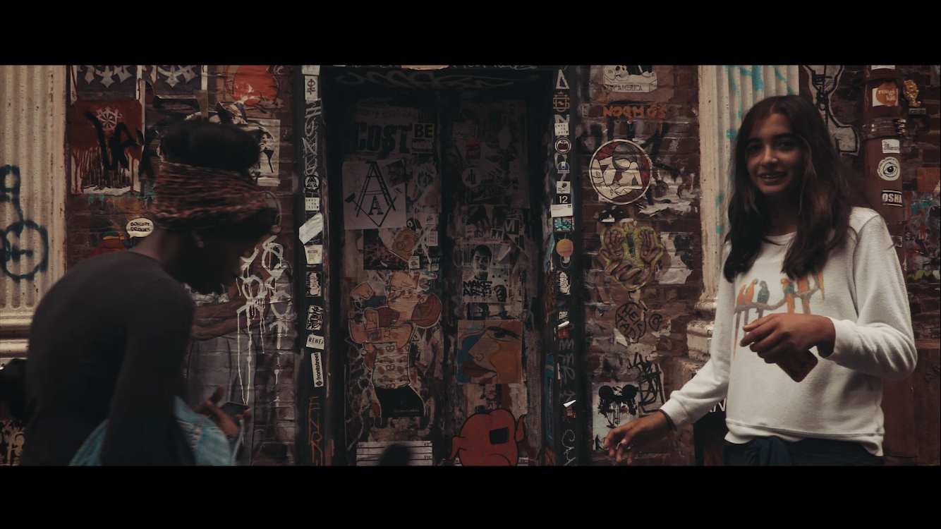

kidzrevil Posted October 9, 2016 Share Posted October 9, 2016 Guys I apologize for speaking so brashly. I looked for some clips I had that I white balanced with a grey card before shooting and that footage shined ! Plus I choose a different LUT this time. Visioncolor luts seem to work the best. Most of my shots were exposed for the midtones and I "pulled" the exposure in post while the subway shots were underexposed and "pushed" a stop. Im less worried about the slow aperture now that I know I can push the image like that in post. The motion cadence is beautiful and it sharpens really well in post. The diffusion filter im using with this thing works well with the lens & sensor combo. Link to comment Share on other sites More sharing options...

mercer Posted October 10, 2016 Share Posted October 10, 2016 1 hour ago, kidzrevil said: @mercer i think it was tetrachrome. I tried using a koji advance and deluts combo and it sucked, the impulz c300 profiles work ! Btw which is closer to the image of the xc10 ? The c100 or c300 ? I would think the 1080p is closer to the C100 and the 4K is closer to the C300. Btw, the subway shots are my favorite. They look wicked. The diffusion filter works nicely. Black Mist? Btw, is that NY? I'm there now for work. I love this city. Link to comment Share on other sites More sharing options...
kidzrevil Posted October 10, 2016 Share Posted October 10, 2016 3 hours ago, mercer said: I would think the 1080p is closer to the C100 and the 4K is closer to the C300. Btw, the subway shots are my favorite. They look wicked. The diffusion filter works nicely. Black Mist? Btw, is that NY? I'm there now for work. I love this city. Yeah this is in ny! I live here you know :-D This was with a black satin though. Works well with CLOG as it smooths the shadow transitions and fine detail...that usually helps the image compress better. Im gonna try using a heavier grade soon since this grade of filter was so light Link to comment Share on other sites More sharing options...
