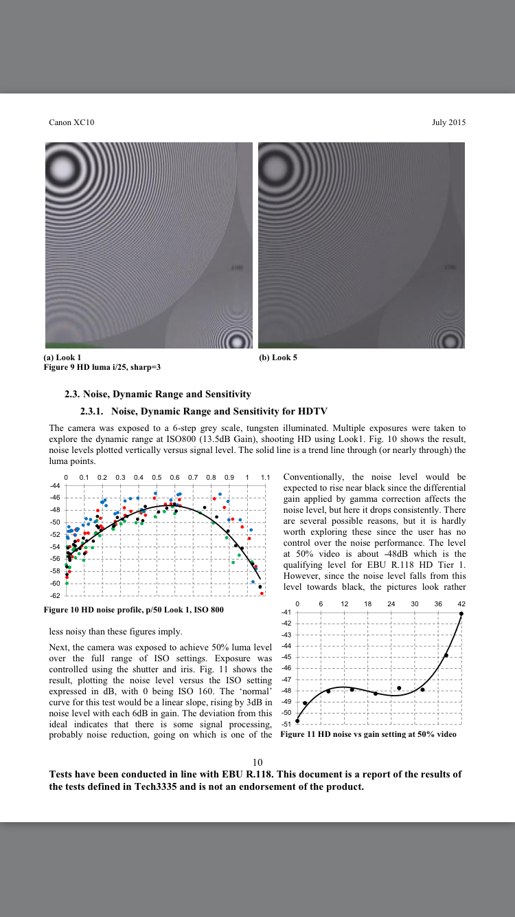

kidzrevil Posted October 26, 2016 Share Posted October 26, 2016 it is a phenomenal camera @mercer but it makes no sense to have an intra frame codec if there is going to be ghosting in between frames. That totally defeats the purpose. I am either going to wait for Canon's response or sell my xc10 and get the xc15. Its a shame the reviewers haven't caught this because I would have just gotten the xc15 to begin with. Where is @Andrew Reid with his review of this anyway ? It would be nice if he made a post about this to raise awareness of it, if anyone can bring attention to this its him. oh btw the Cinema EOS Standard profile is a complete joy to shoot with. The skintones are perfect ! Link to comment Share on other sites More sharing options...

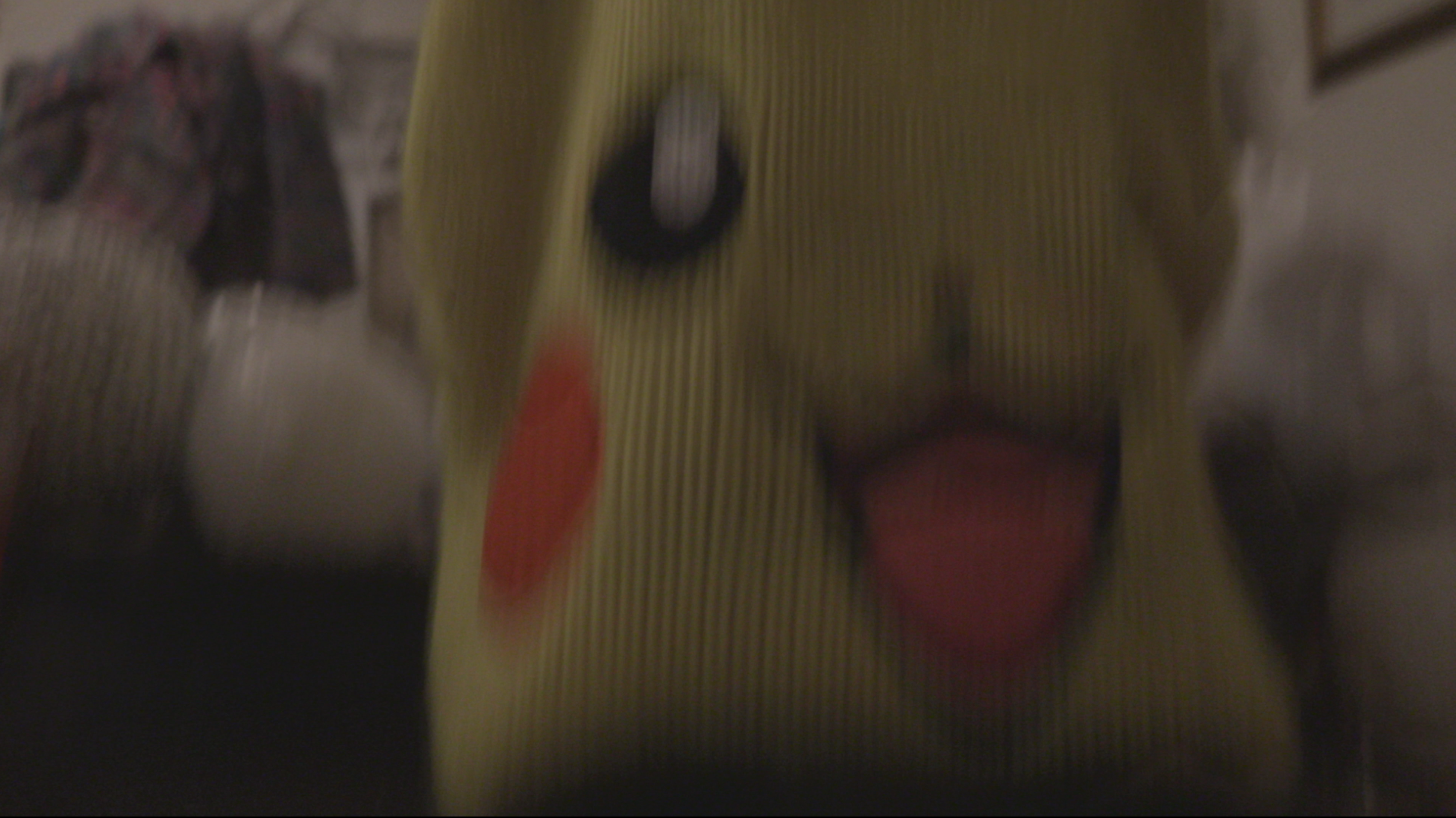

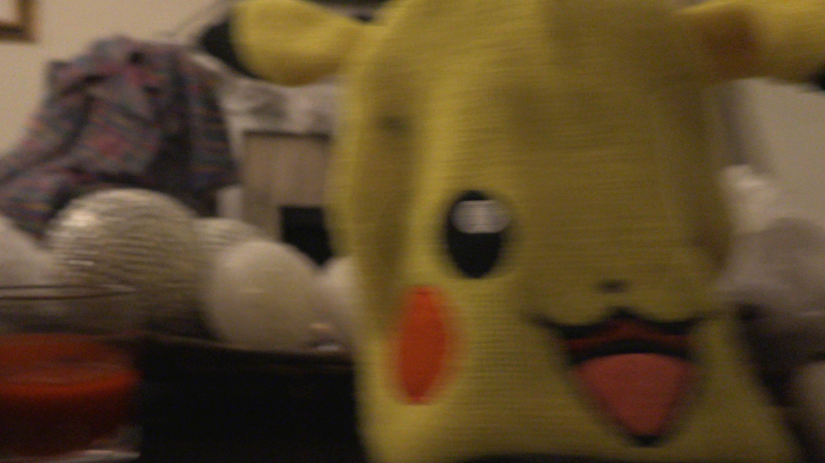

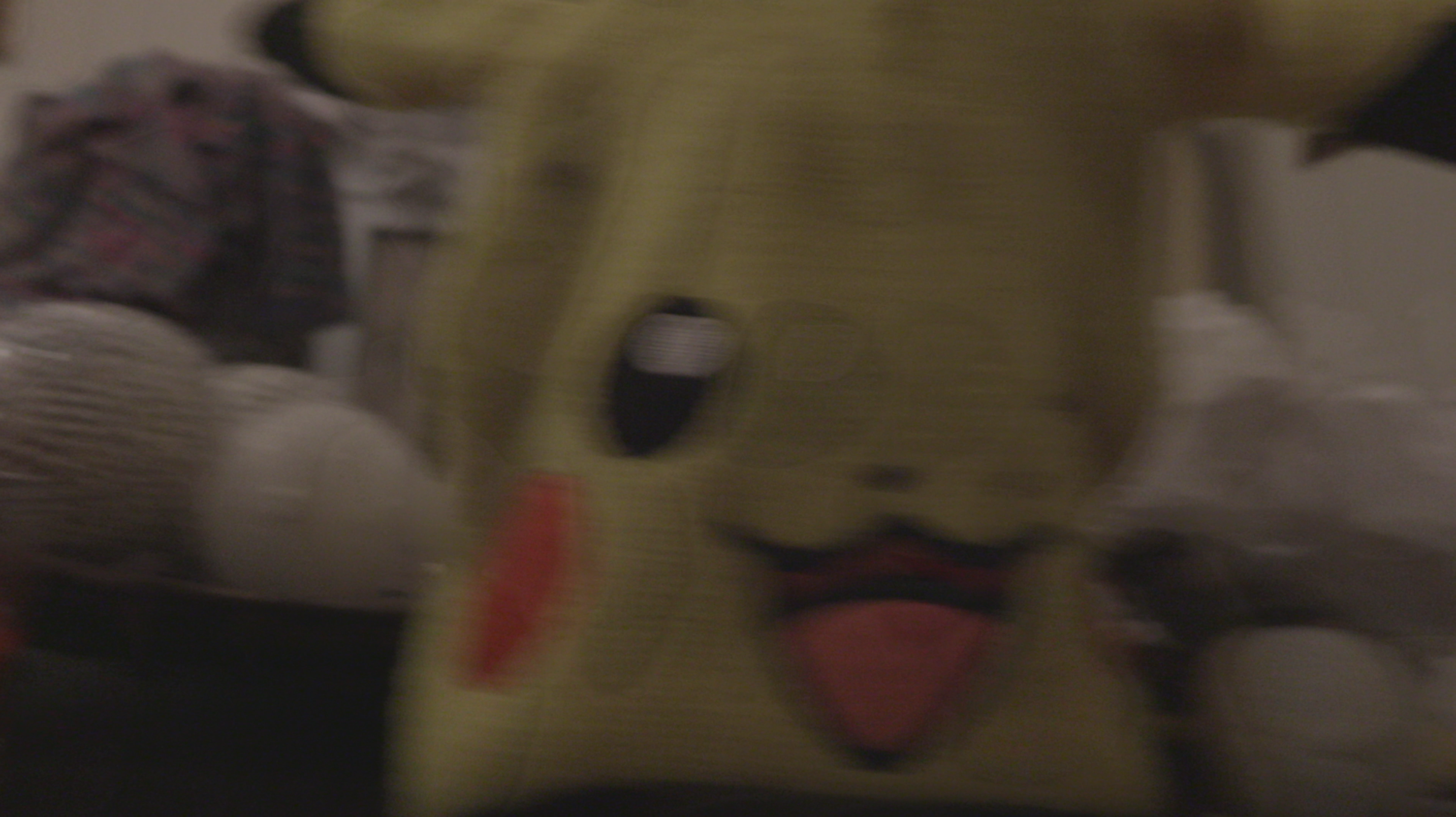

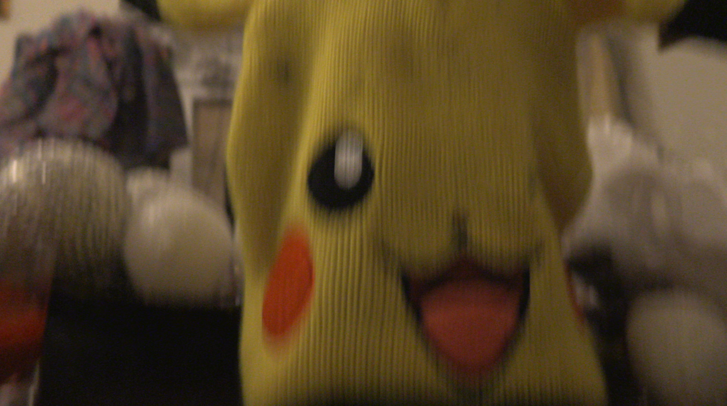

jpfilmz Posted October 26, 2016 Share Posted October 26, 2016 I retested Pikachu with less light and was able to get alittle more ghosting to appear with Clog. It happens with horizontal movement with hard pans. Vertical only doesn't seem produce it but horizontal + vertical movement does. EOS Standard and Cinema EOS Standard have the least ghosting artifacts. *ISO is set to 6400 in these test. Clog Ghosting Horizontal Clog Ghosting Vertical Cinema EOS Standard Ghosting Horizontal Cinema EOS Standard Ghosting Vertical With this level of lighting I would not be shooting with the XC10 anyway....but if i did i would not use clog. Normal panning with Cinema EOS Standard was usable with very little ghosting. Wide Dynamic range also had better performance than Clog. Lintelfilm 1 Link to comment Share on other sites More sharing options...

kidzrevil Posted October 26, 2016 Share Posted October 26, 2016 Would be great if someone could translate the EBU findings into ISO I want to know the exact point in terms of ISO does the NR start affecting resolution. I have a couple theories I want to put to the test to alleviate some of the cameras shortcomings Link to comment Share on other sites More sharing options...
