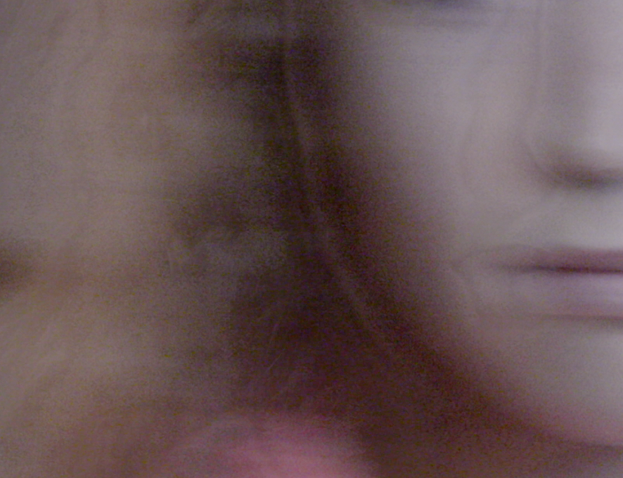

Lamplighter55 Posted November 8, 2016 Share Posted November 8, 2016 On 01/11/2016 at 9:44 AM, hyalinejim said: I agree. All of the seven or eight XC10 ghosting tests that I've seen have shown it, but it doesn't mean all XC10s have the problem. If anyone has a clean XC10 please post footage. And the one clean XC15 test doesn't mean all XC15s are free from the problem. If anyone has a ghosting XC15 please post. If you're thinking about getting either model I would strongly recommend you try before you buy, or look into your seller's return policy. I bought my XC10 back in January (2016) and have been very happy with the quality of the images/footage. This 'Ghosting' or temporal noise reduction (possibly) has also shown up on my footage (see bellow) - and I've been following this thread on the issue. Having had a close look at the artefact I can pretty much say with certainty its an error in the calculation of how Canon integrate values from one frame to the next when calculating for motion blur. Basically the maths is off and creating a 'rounding error' so the pixel bins either hold an 'over shoot' or 'under shoot' value - so you get this characteristic 'zoning' of luminance values. Its a bit like the posterising effect (thresholding) one can achieve when reducing the bit depth of an image. So what is causing this ... hopefully it's a firmware only issue, in which case the frame to frame integration algorithm needs re-writing, or it is something done in hardware ... which means a fault in the DIGIC DV 5 chip. Canon will need to check in the later case if it is a batch issue or systemic. Let's hope it only requires a firmware update! The 'good' thing is that if it is (as I surmise), then the solution is just a question of maths - but the problem is how that is implemented - at chip level in hardware or a firmware 'bug'. (I should add, this could also will explain why this is less evident on HD footage as it has 4x more 'integration' as a reduction from 4K in spatial resolution - equivalent of averaging down to a quarter sized image.) One test we could try is running at a higher frame rate (HD only) and seeing if the artefacts are reduced or increased further for the same amount if spatial moment - in other words more samples over a given time frame and spatial transfer. Link to comment Share on other sites More sharing options...
Lamplighter55 Posted November 8, 2016 Share Posted November 8, 2016 2 hours ago, Lamplighter55 said: .. and from Wikipedia 'The XC10 uses a single DIGIC DV 5, while the C300 Mark II uses a dual DIGIC DV 5 implementation.' So less sampling/super-sampling no doubt. There is also now the DIGIC DV 5+ (faster by 3x - so possibly equivalent of the dual set up in the 300 MkII) - yet to find which camera platforms it's to be used for apart from the EOS 1D X ... maybe XC15?! The technical term for these artefacts is 'Quantisation error'. Which could also hint at a way to mitigate them by spreading the pixel values over a wider range of bits - in other words shifting the luma and contrast with more light, assuming under really low light (higher ISO settings) the quantisation is lost/masked in the higher digital noise signal. Link to comment Share on other sites More sharing options...
hyalinejim Posted November 8, 2016 Share Posted November 8, 2016 5 hours ago, Lamplighter55 said: I can pretty much say with certainty its an error in the calculation of how Canon integrate values from one frame to the next when calculating for motion blur. Basically the maths is off and creating a 'rounding error' so the pixel bins either hold an 'over shoot' or 'under shoot' value - so you get this characteristic 'zoning' of luminance values. Interesting! According to this theory, would you expect ghosting to worsen with ISO, as we have seen? 5 hours ago, Lamplighter55 said: So what is causing this ... hopefully it's a firmware only issue, in which case the frame to frame integration algorithm needs re-writing, or it is something done in hardware ... which means a fault in the DIGIC DV 5 chip. Canon will need to check in the later case if it is a batch issue or systemic. Let's hope it only requires a firmware update! The 'good' thing is that if it is (as I surmise), then the solution is just a question of maths - but the problem is how that is implemented - at chip level in hardware or a firmware 'bug'. Here's the latest update from Canon: Quote CANON: Thank you for taking the time to contact us and for providing a copy of your camera’s settings with sample video of the issue. I can confirm this has been passed over to our European Product Specialists and they have been investigating the issue you reported. At present I do not have any further information but if I get any updates I will let you know. ME: Thank you. I realise that you may be limited in what you can communicate to me, but do you think there is any point in sending my camera in for repair at this stage in order to fix the issue? CANON: In response to your email, I would advise that at present sending your camera in would not resolve the issue. As this is still being investigated please await further updates from us. I guess you could interpret this in a few different ways. I'm going with "they're fixing the firmware" for now. Lamplighter55 1 Link to comment Share on other sites More sharing options...
