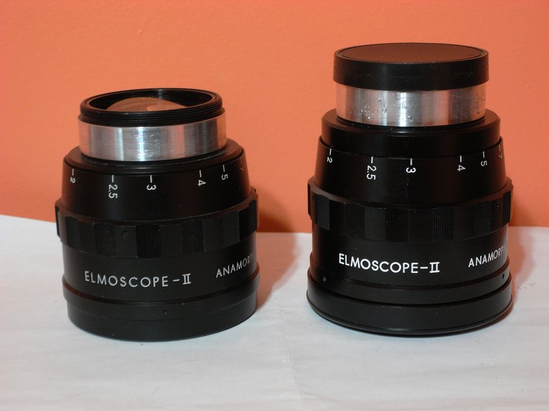

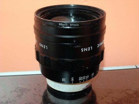

ken Posted April 11, 2015 Share Posted April 11, 2015 Mine is 67mm for $1, perfect, it still fits original front cap. Link to comment Share on other sites More sharing options...
enny Posted April 11, 2015 Author Share Posted April 11, 2015 Mine is 67mm for $1, perfect, it still fits original front cap. I have kowa for bell and howell is that Kowa that you have? and i did the same to one of my lenses where used hot glues as in relyyyyy strong metal bonding glue Link to comment Share on other sites More sharing options...
ken Posted April 11, 2015 Share Posted April 11, 2015 I have kowa for bell and howell is that Kowa that you have? and i did the same to one of my lenses where used hot glues as in relyyyyy strong metal bonding glueElmoscope II, one of the rebrand 16H/8Z, only marks distance by metric system I like. Link to comment Share on other sites More sharing options...
valid Posted April 11, 2015 Share Posted April 11, 2015 That's the 8Z. The Bell-Howell is bigger- more like 70-ish mm. I tried all combinations of step rings/filters - in the end just got the redstan clamp and it's a perfect fit :-) Link to comment Share on other sites More sharing options...
ken Posted April 12, 2015 Share Posted April 12, 2015 That's the 8Z. The Bell-Howell is bigger- more like 70-ish mm. I tried all combinations of step rings/filters - in the end just got the redstan clamp and it's a perfect fit :-)No, 8Z is imperial unit too. This is the only metric one. Link to comment Share on other sites More sharing options...
valid Posted April 12, 2015 Share Posted April 12, 2015 dude i'm talking about the front size, not about focus markings :-) Link to comment Share on other sites More sharing options...
