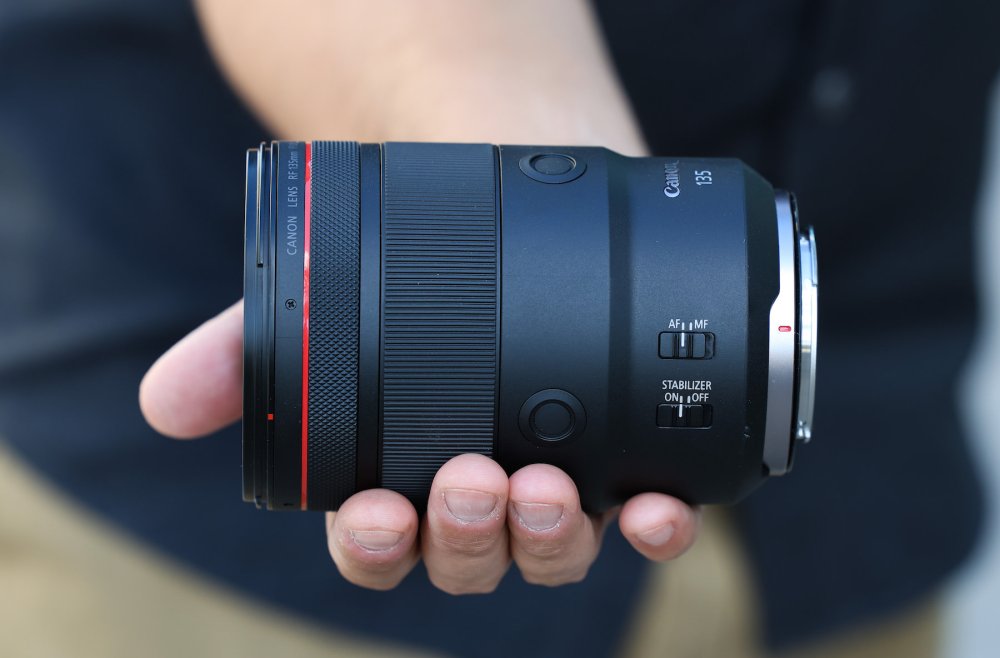

For a brand that is supposed to be trailing the others in innovation I've been particularly impressed by Canon's lens offerings. Obviously they've got the without-peer 28-70mm f/2 lens (still) but recently they've added the Canon 135mm f/1.8 IS (which I've been using this year and it is absolutely phenomenal, especially for video).
Then the ultra expensive 100-300mm f/2.8L IS and in the last couple of months they've added the 10-20mm f/4, the 24-105mm f/2.8 IS and the 200-800mm f/6.3 - 9 IS.
Each of these are pushing the boundaries of what was previously thought was achievable in a lens.
That's not to say that the other brands don't have good offerings. However, each of the above lenses I've mentioned is keeping me firmly in the Canon camp. Coupled with the likely improvements on the already exceptional Canon R5 and I honestly can't believe how far we've come with camera offerings in the 15 years since I've been using professional camera gear.
