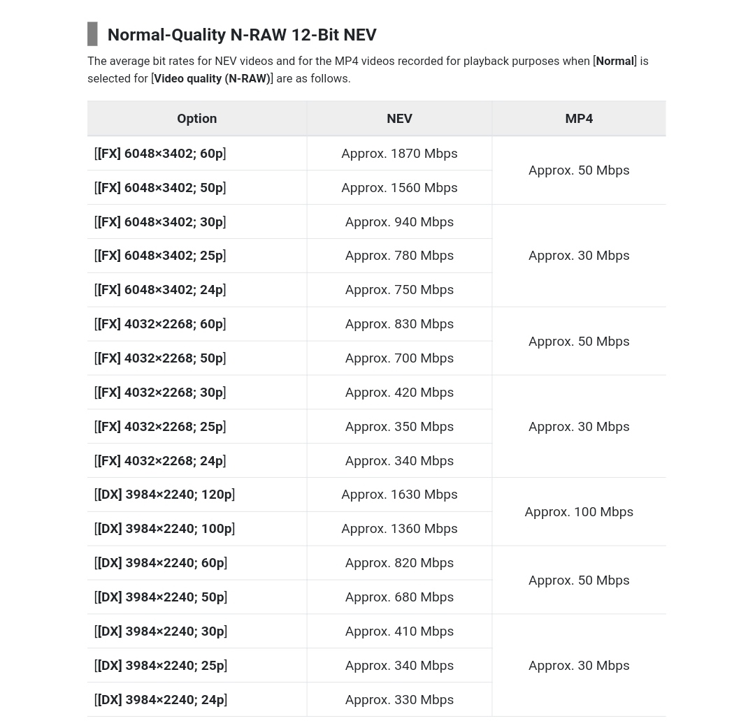

Danyyyel Posted June 25, 2024 Share Posted June 25, 2024 6 hours ago, zlfan said: this is about 40 MB/s. about the same as redcode 42. compression ratio is about 8. workable but not the best quality. This is the normal bitrate, they have a higher bitrate one, it at least give you the capability to shoot raw at what used to be normal h264/265 bitrate. zlfan 1 Link to comment Share on other sites More sharing options...

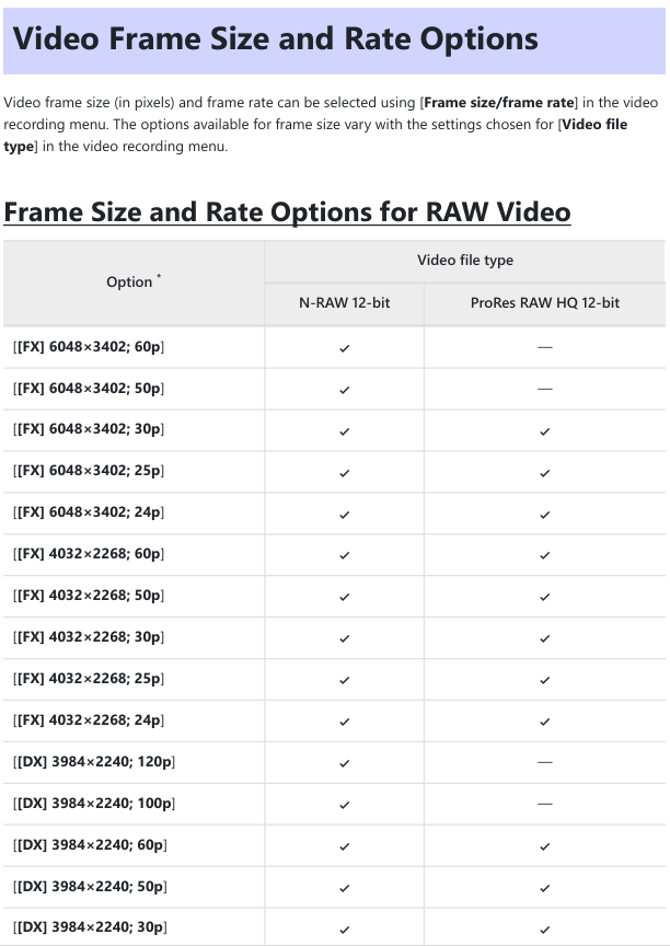

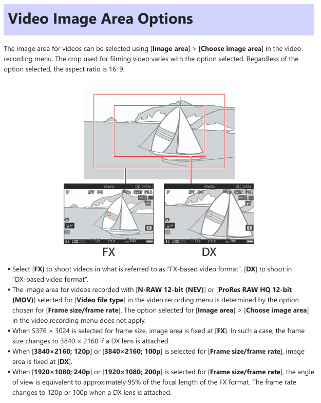

Simon Young Posted June 25, 2024 Share Posted June 25, 2024 8 hours ago, Eric Calabros said: If all you need is 4k24p raw, the bitrate is only 340mbs Is the 4K raw downsampled from 6K, thus not really raw? Emanuel 1 Link to comment Share on other sites More sharing options...
ac6000cw Posted June 25, 2024 Share Posted June 25, 2024 1 hour ago, Simon Young said: Is the 4K raw downsampled from 6K, thus not really raw? As the 4032 x 2268 RAW video is listed as [FX] (full-frame) in the tables, I think it probably is down-sampled - a couple of pages from the Z6 iii manual: Emanuel 1 Link to comment Share on other sites More sharing options...
