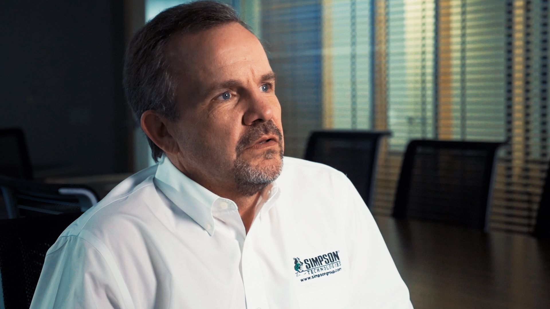

AaronChicago Posted April 16, 2015 Share Posted April 16, 2015 Hey all,I'm working on a LUT for 3200k and 4600k for Cinelike D on the GH4. I know it's a little late to the game since VLOG is around the corner, but I'm trying to focus on skin tones. Any comments on the skin tone of this shot? Too yellow, too red? Zak Forsman 1 Link to comment Share on other sites More sharing options...
TheRenaissanceMan Posted April 16, 2015 Share Posted April 16, 2015 They look good to me! My only gripe is that his shirt is going supernova around the Simpson logo. AaronChicago 1 Link to comment Share on other sites More sharing options...
Cinegain Posted April 16, 2015 Share Posted April 16, 2015 To me it looks a touch unnatural. Try this and tell me if you like it better with that correction applied, I kinda do:With the other channels less correction needed... I made a before/after gif: Link to comment Share on other sites More sharing options...
gatopardo Posted April 16, 2015 Share Posted April 16, 2015 Too yellow Link to comment Share on other sites More sharing options...
AaronChicago Posted April 16, 2015 Author Share Posted April 16, 2015 To me it looks a touch unnatural. Try this and tell me if you like it better with that correction applied, I kinda do:With the other channels less correction needed... I made a before/after gif:I do like it. Less saturated. I was creating more of a stylized look that is less natural but wanted to maintain a good skintone color. Maybe I'll just bring down the yellow saturation in the midtones. Link to comment Share on other sites More sharing options...
AaronChicago Posted April 16, 2015 Author Share Posted April 16, 2015 Tweaked - less yellow/orange saturation in the mids. tosvus 1 Link to comment Share on other sites More sharing options...
TheRenaissanceMan Posted April 16, 2015 Share Posted April 16, 2015 Tweaked - less yellow/orange saturation in the mids. Looks a little chalky/pink to me. Link to comment Share on other sites More sharing options...
AaronChicago Posted April 16, 2015 Author Share Posted April 16, 2015 I'm going to test it on a couple of more lighting scenarios and see if i can come up with a nice balance between pink and orange/yellow. It might make sense to go with a bit less saturated a dial it up when needed after the LUT. Link to comment Share on other sites More sharing options...
Nick Hughes Posted April 16, 2015 Share Posted April 16, 2015 No reason you can't make multiple LUTs depending on the look you're going for. One philosophy for grading is to apply 'too much' then dial it back. Link to comment Share on other sites More sharing options...
TheRenaissanceMan Posted April 16, 2015 Share Posted April 16, 2015 I'm going to test it on a couple of more lighting scenarios and see if i can come up with a nice balance between pink and orange/yellow. It might make sense to go with a bit less saturated a dial it up when needed after the LUT.Don't forget to keep some red in there. You need at least a little pure red to keep skin looking natural, not plasticky. Link to comment Share on other sites More sharing options...
leeys Posted April 17, 2015 Share Posted April 17, 2015 I can't comment, because I suspect you did not embed colourspace info in your JPEG - my wide gamut monitor is not liking the output. Link to comment Share on other sites More sharing options...
AaronChicago Posted April 17, 2015 Author Share Posted April 17, 2015 I can't comment, because I suspect you did not embed colourspace info in your JPEG - my wide gamut monitor is not liking the output.Native from camera to JPEG. I believe GH4 is sRGB? 0-255. Link to comment Share on other sites More sharing options...
leeys Posted April 17, 2015 Share Posted April 17, 2015 Hmm, ok, because it's looking a bit like a recent Hollywood film here (teal+orange), which I'm sure it's not what you had in mind. >.> Link to comment Share on other sites More sharing options...
BenEricson Posted April 17, 2015 Share Posted April 17, 2015 I would just comment on the shirt, looks either clipped or very near. Maybe lower the gain and raise the gamma. Honestly, I would shoot an interview with a 5D/proper white balance, low contrast and color, and try to match that. If you did a side by side, I feel like that would be a great reference. If you're anywhere close to that, then you know you're doing it right. Link to comment Share on other sites More sharing options...
