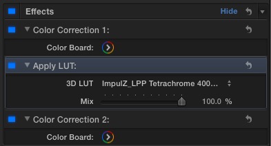

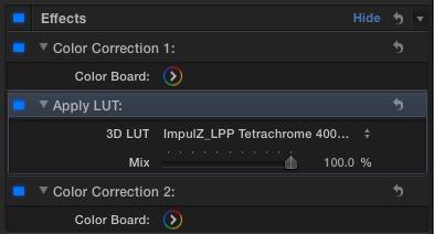

utsira Posted April 17, 2015 Author Share Posted April 17, 2015 Seems like I spoke too soon.... Just downloading FCPX 10.2 now, and I see that the built-in colour corrector is now classed as an effect, so it seems you can now sandwich it between other effects slots. It's not clear yet whether you can have multiple instances of the colour-board though (ie for the kind of pre-LUT/ post-LUT correction I was describing above). If my internet connection ever gets through the 2gb download, I'll report back. Link to comment Share on other sites More sharing options...
utsira Posted April 17, 2015 Author Share Posted April 17, 2015 Yes, in FCPX 10.2 you can now have multiple colour boards, and place them either side of effects slots. Color Finale is still very nice though for curves, wheels, LUT organisation and so on. Link to comment Share on other sites More sharing options...

utsira Posted April 17, 2015 Author Share Posted April 17, 2015 You always could have multiple color boards in FCP X - with "+". Yeah but you couldn't place them either side of an effect like a LUT because they were in a separate colour pane set apart from the effects pane. So if you wanted to do a pre/post adjustment you needed an adjustment layer. I'm certainly not suggesting Color Finale is comparable to Resolve! it adds no new possibilitiesPerhaps not, especially if you already own LUT Utility, plugins for gamma adjustments etc. And the color board does everything color wheels do, it's just a different arrangement. But if you need to use LUTs, and don't have LUT utility already, or you want an interface that gathers a useful set of tools together, this could be one to go for. As a LUT Utility owner, I'm on the fence with Color Finale (perhaps if their upgrade pricing was a little more generous....) In terms of new functionality for me (in terms of plugins I already own etc) the curves are a useful addition.And yes, it is disappointing that the colour board still isn't keyframable in 10.2. (though the master "opacity" slider for Color Finale is). Link to comment Share on other sites More sharing options...
