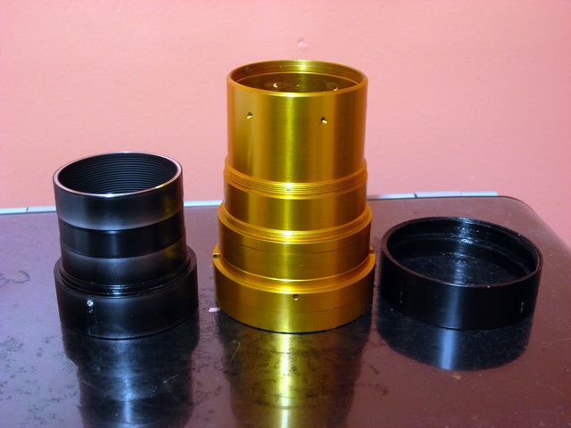

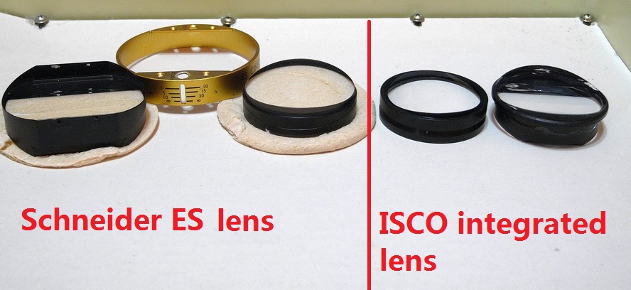

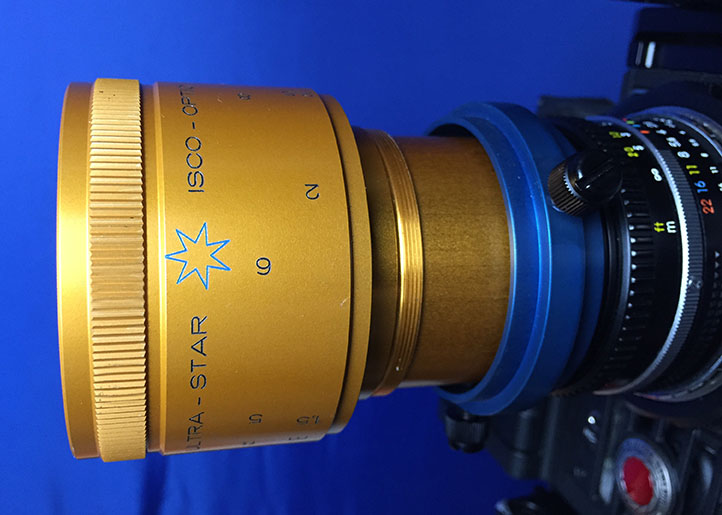

ken Posted April 28, 2015 Share Posted April 28, 2015 this is normal ISCO ultrastar with removed back housing, saves you some size and a bit of weight, i removed that housing from mine, looks the same good lens, sharp, better flares then Kowa H16, but Kowa, to my eye, is more anamorphic, on S35 works great with 50mm IMO, it cannot beat 16H, only sharpness is comparable. I think 16h's flare is stronger, but the color is different. BTW, your lens has better flare(green) than other blue start one. 16h's advantage is wide angle, no others can compete, except LOMO 35mm, but not sure the new SLR one. Who can tell that, very appreciated. Link to comment Share on other sites More sharing options...

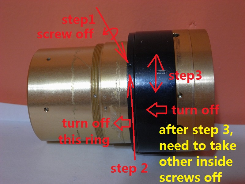

bzpop Posted June 16, 2015 Share Posted June 16, 2015 a bit off topic, sorry, does anybody know how to remove a part that is around front glass?i stripped all from that ultra star, but that built in hood, and it vignettes a little, before i take a hacksaw thx! Link to comment Share on other sites More sharing options...
ken Posted June 16, 2015 Share Posted June 16, 2015 a bit off topic, sorry, does anybody know how to remove a part that is around front glass?i stripped all from that ultra star, but that built in hood, and it vignettes a little, before i take a hacksaw thx!You can try to use heat gun. Link to comment Share on other sites More sharing options...

bzpop Posted June 19, 2015 Share Posted June 19, 2015 You can try to use heat gun.Didn't help , believe or not?I don't, what is that, pita bread?that's the part i can't remove Link to comment Share on other sites More sharing options...

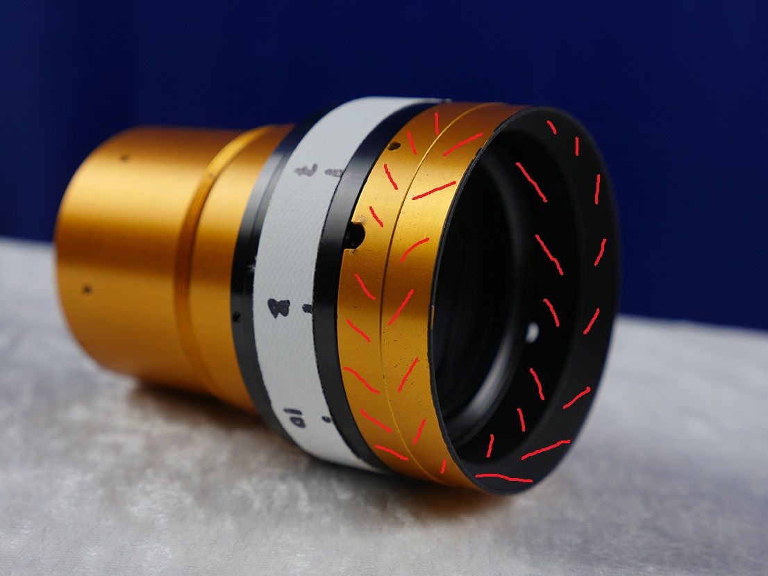

ken Posted June 20, 2015 Share Posted June 20, 2015 Didn't help , I don't, what is that, pita bread?that's the part i can't removeIMO, that is whole part thing. what you need to take apart is the little screw driver. Link to comment Share on other sites More sharing options...
ken Posted June 20, 2015 Share Posted June 20, 2015 more illustration as picture Link to comment Share on other sites More sharing options...
