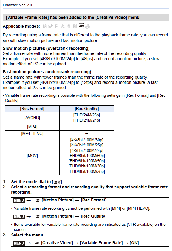

ac6000cw Posted February 19, 2024 Share Posted February 19, 2024 On 2/17/2024 at 7:16 PM, Mark Romero 2 said: I would add that - and this is just personal - if you could live with the wonky autofocus, then I would probably go for an original G9 over the E-M1 II. I really like 10-bit video, and 4K 60p is nice. Also, I find the menus on the E-M1 MK II a bit baffling. But that's just me. The G9 not only supports 10-bit video, it also supports 4:2:2 - below are the extra video modes added in the major FW 2.0 upgrade (plus variable frame rate recording, HLG support and adjustable video levels). MF linear focus control (with lenses that support it), 'red frame' record indication and vertical video support were added in later FW updates. Note it doesn't support DCI 4k or All-I compression (it's max 100Mbps for FHD, 150Mbps for 4k, long-GOP). All of that puts the G9 way ahead of the E-M1 ii for video quality and flexibility (but the E-M1 ii/iii and OM-1 are a bit smaller and better ergonomically, IMHO). Link to comment Share on other sites More sharing options...
