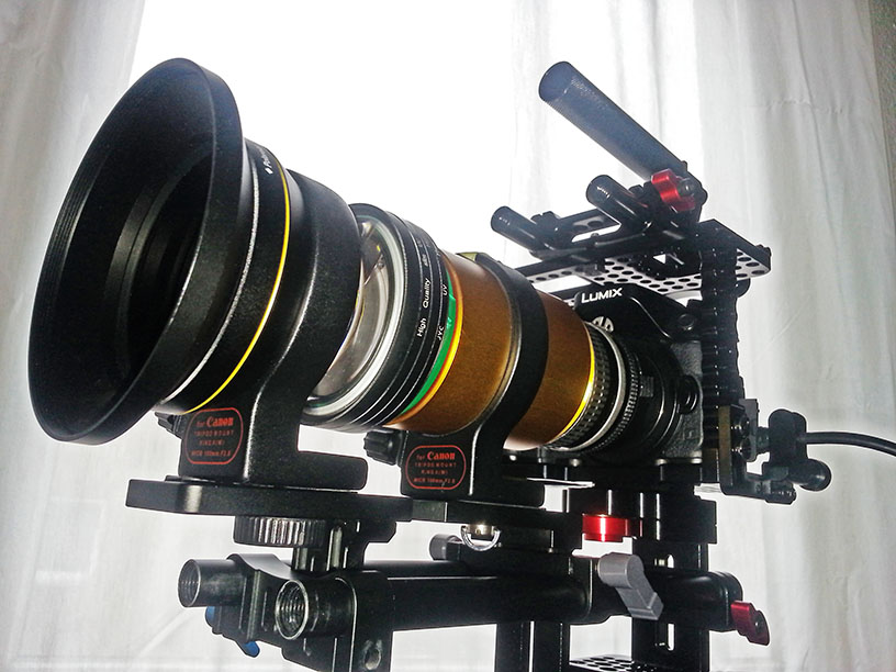

anti12 Posted April 22, 2015 Share Posted April 22, 2015 You can use those cheap parts to build your Cinelux support:http://www.ebay.com/itm/DSLR-15mm-1-4-and-3-8-Thread-Tripod-Mount-Plate-Rail-Block-Rod-Clamp-5D2-5D3-/281667005669?http://www.ebay.com/itm/Tripod-Mount-Ring-for-Canon-EF-100mm-f2-8-f-2-8Macro-/250827007518?orhttp://www.ebay.com/itm/Tripod-Baseplate-Plate-Mount-For-Follow-Focus-15mm-Rods-Rail-Support-System-5D2-/171000567512?http://www.ebay.com/itm/FOTGA-DP3000-Tripod-Mount-15mm-Rod-Support-Base-Plate-for-DSLR-Rig-Follow-Focus-/331020232705?I used some of those in my experiments dahlfors and buggz 2 Link to comment Share on other sites More sharing options...
fabre8 Posted April 22, 2015 Author Share Posted April 22, 2015 That's Fantastic! I'll order some right away, although I'll look at UK prices and sellers since I'm based there Is this setup easy to handle? Any alterations that you had to do? How do you thread the Anamorphic lens to the camera lens? Sorry to ask so many questions, but you seem to have the exact setup Im after You're a life saver! Link to comment Share on other sites More sharing options...
anti12 Posted April 22, 2015 Share Posted April 22, 2015 Didn't find it very practical, I moved on to a more expensive single focus solution.My Nikon lenses extend while focusing so I never connected them to the CineluxI tried to close the gap with a rubber lenshood.But If you like to use step-up rings: The thread on the Cinelux is 68mm.The Tripod Mount Ring is a little bit to wide so I used some Tape. You can also try to drill threaded holes for nylon screws.2x Tripod Mount Rings might help to keep the Cinelux from twisting sideways when not connected to a taking lens.Good Luck! Link to comment Share on other sites More sharing options...
ken Posted April 22, 2015 Share Posted April 22, 2015 Schneider Kreuznach WA Cinelux Anamorphic is a big lens, not ES, similar to ISCO HD attachment. Just order the close size (must be bigger) tripod mount support. Link to comment Share on other sites More sharing options...
