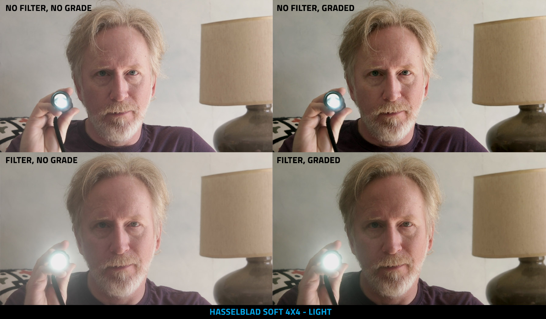

M Carter Posted January 30, 2016 Share Posted January 30, 2016 a black satin is cool, its kinda reserved but has the benefits of the black pro mist and the black diffusion fx in one. I personally use black pro mists for the better highlight roll off and subdued highlights but you may not like how it flares. A lil gaussian blur helps as well !Posted this in the low con filters thread, but - old hasseblad "soft" series 4x4 - sets of 3 often go for $50 or so. This is the "light" filter (there's medium and heavy in the set). Pardon my aging saggy mug! DPStewart and Phil A 2 Link to comment Share on other sites More sharing options...
kidzrevil Posted January 30, 2016 Share Posted January 30, 2016 Posted this in the low con filters thread, but - old hasseblad "soft" series 4x4 - sets of 3 often go for $50 or so. This is the "light" filter (there's medium and heavy in the set). Pardon my aging saggy mug! the end result after grading is pretty good man. Smooth transition from shadow to highlight while still looking contrasty Link to comment Share on other sites More sharing options...
M Carter Posted January 31, 2016 Share Posted January 31, 2016 the end result after grading is pretty good man. Smooth transition from shadow to highlight while still looking contrastyI think I paid $38 for the full set, so not bad - a 4x4 Glimmerglass is $250...I have a pile of 3x3 diffusion filters from the Cokin system, but the problem with filters made for still photography is even their light versions are over the top; I guess it was more of a cheeseball thing for portrait shooters… I do keep my eye out for deals on Tiffens used. DPStewart 1 Link to comment Share on other sites More sharing options...
