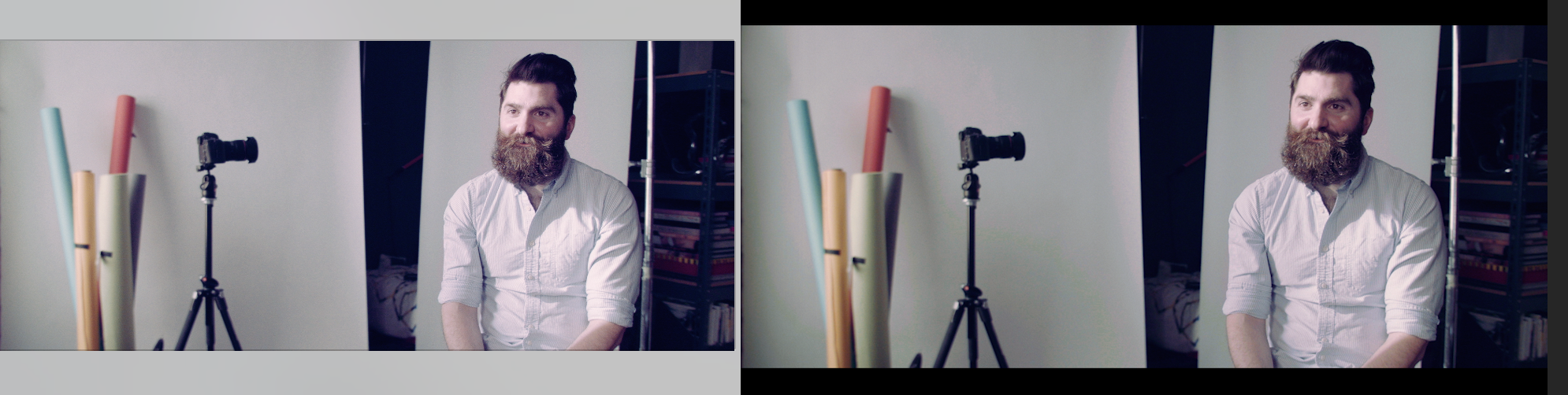

Turboguard Posted May 1, 2015 Share Posted May 1, 2015 So I'm working on this portrait piece and have heavily graded it to my liking. After encoding it and converted my final grade, Premiere changes the colors for me.Look at attached image, left side is converted Prores HQ 422 and right is my Program window in PP.Why does this happen?Thanks Link to comment Share on other sites More sharing options...
Mikey R Posted May 2, 2015 Share Posted May 2, 2015 Hi Turboguard, could be a few things - quicktime gamma shift - http://www.thedvshow.com/vault/detail.php?id=QT Gamma Stripper, could be PP's h264 encoding http://nofilmschool.com/2014/09/massive-difference-export-quality-fcpx-and-premiere-pro Try playing the file in VLC and see if that helps..The other thing is PP has no built in colour management, so afaik you have to use a (lut?) calibrated external display with a seperate ouput as you can't really trust the colours in PP's gui window https://forums.adobe.com/thread/1733974Hopefully someone else with a bit more knowledge can chip in here..Good luck! Link to comment Share on other sites More sharing options...
Turboguard Posted May 2, 2015 Author Share Posted May 2, 2015 My workflow is usually match up most of my footage (RAW) in Davinci, then encode as ProRes, then color with Filmconvert, Threeway etc in PP. I've never seen this happen before, that's why I got so confused by it happening. And thanks, I'll give your links a read! Link to comment Share on other sites More sharing options...

hmcindie Posted May 5, 2015 Share Posted May 5, 2015 Premiere doesn't change anything for me, but different players display differently. Try importing that prores back into Premiere to see if there is actually any difference. Link to comment Share on other sites More sharing options...
cantsin Posted May 5, 2015 Share Posted May 5, 2015 This page provides valuable information:http://www.drastic.tv/index.php?option=com_content&view=article&id=202:prores-colour-shifts-in-post-production&catid=59&Itemid=94Scroll down to section "ProRes Problems/Issues". This one here is particularly telling: QuickTime Player is not to be trusted. Period. On Windows, with ProRes, it is actually always wrong, using a 1.8 gamma when a 2.2 display gamma is necessary. This is true no matter what the ProRes header says or any colr atoms. Interestingly, you can get the correct gamma briefly with QuickTime Player on Windows: Load 2 ProRes MOVs and switch between them: The one that does not have focus will have the correct gamma! Useless, but interesting.With QuickTime X on OS-X, there are less playback issues than Windows, but when you export ProRes it adds a strange red hue to the video. The workaround is to post install QuickTime 7 and use that instead. Link to comment Share on other sites More sharing options...
