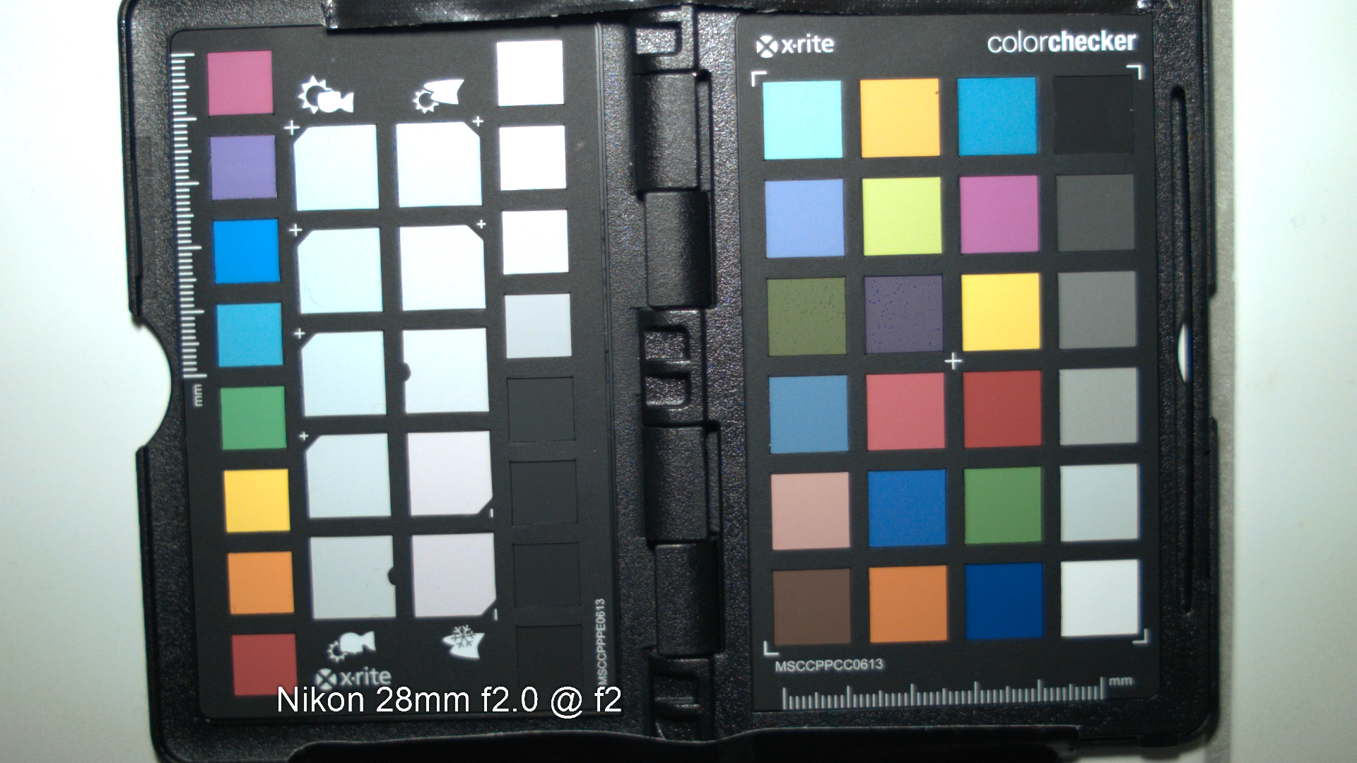

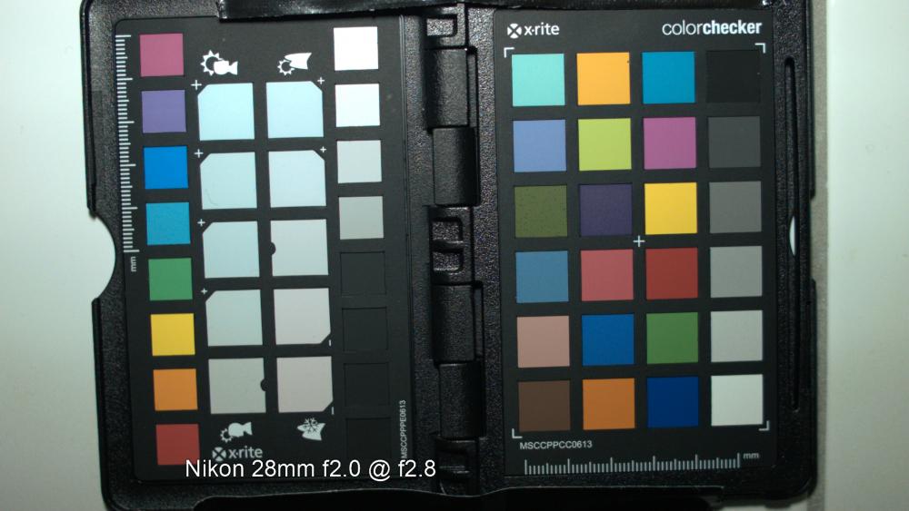

cantsin Posted May 7, 2015 Share Posted May 7, 2015 So once again I've done another test, against both my Leica and Nikon prime 2.8. This time the test was with all the lights off and just a candle on a table, and once again the results are the same. Again, the difference of light transmission from the Sigma 1.8 and the prime's is minimal. If I were to guess t-stop, it would be 2.6 or 2.7 at best for the Sigma. Do you think there is something wrong with my copy of this lens? Or do you think this is consistent across all copies?I think there is something wrong with either your lens or your test setup. I just quickly replicated your test using(a) a Sigma 18-35mm/f1.8(b) a Nikon 28mm/f2 Ai-s prime...both attached to the Metabones BMPC Speedbooster and a Blackmagic Pocket Cinema Camera mounted on a tripod, shooting a color chart in CinemaDNG raw at 24fps with a 172.5 degree shutter angle and ISO 800, in a completely dark room using only one artificial light source (a camera-mounted LED panel). The CinemaDNG files were imported into Resolve, with white balance/color correction first applied to the Sigma clip and applied with identical parameters to the two Nikon clips.Sorry that I didn't spend time on more careful framing/focusing - it didn't matter for this test.First picture is the Sigma at f1.8, second picture the Nikon at f2.0, third picture the Nikon at f2.8. I think that the pictures speak for themselves. Link to comment Share on other sites More sharing options...
